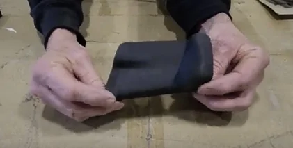

So would the blocks be in addition to the covering of the hole either by rubber sheeting cut to dimensions or the Kydex?
The foam blocks are a fixture to hold everything in place until the JB sets up... they are then removed and thrown away.

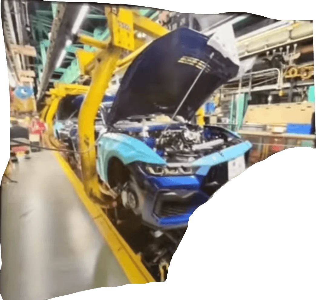

kinda looks like this might go in there
S650 Mustang Front inner wheel well issues 1717313626138-qf
side note anyone know how to get a photo like this its not mine but it is the guys who owns the car on the assembly line
