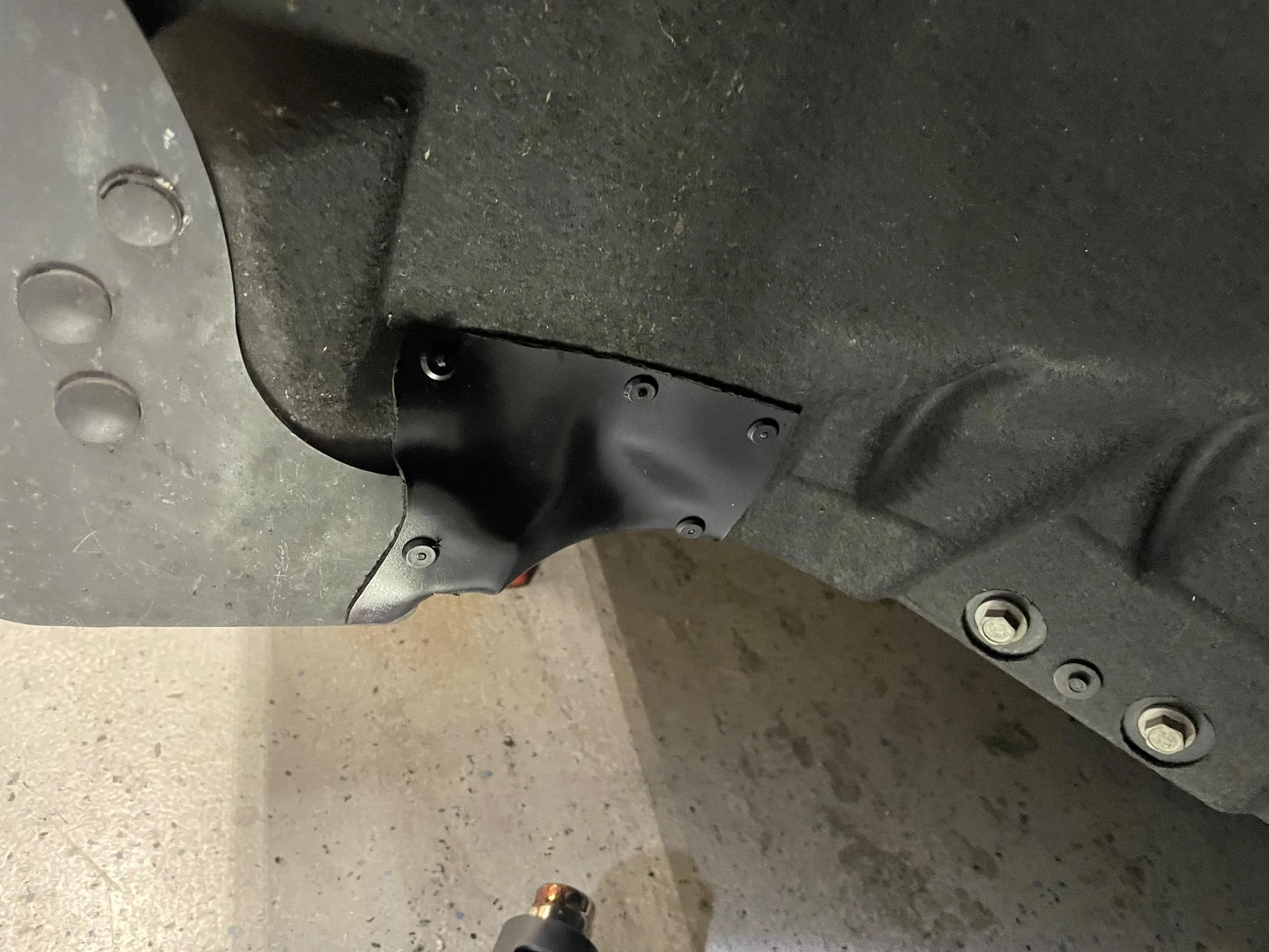

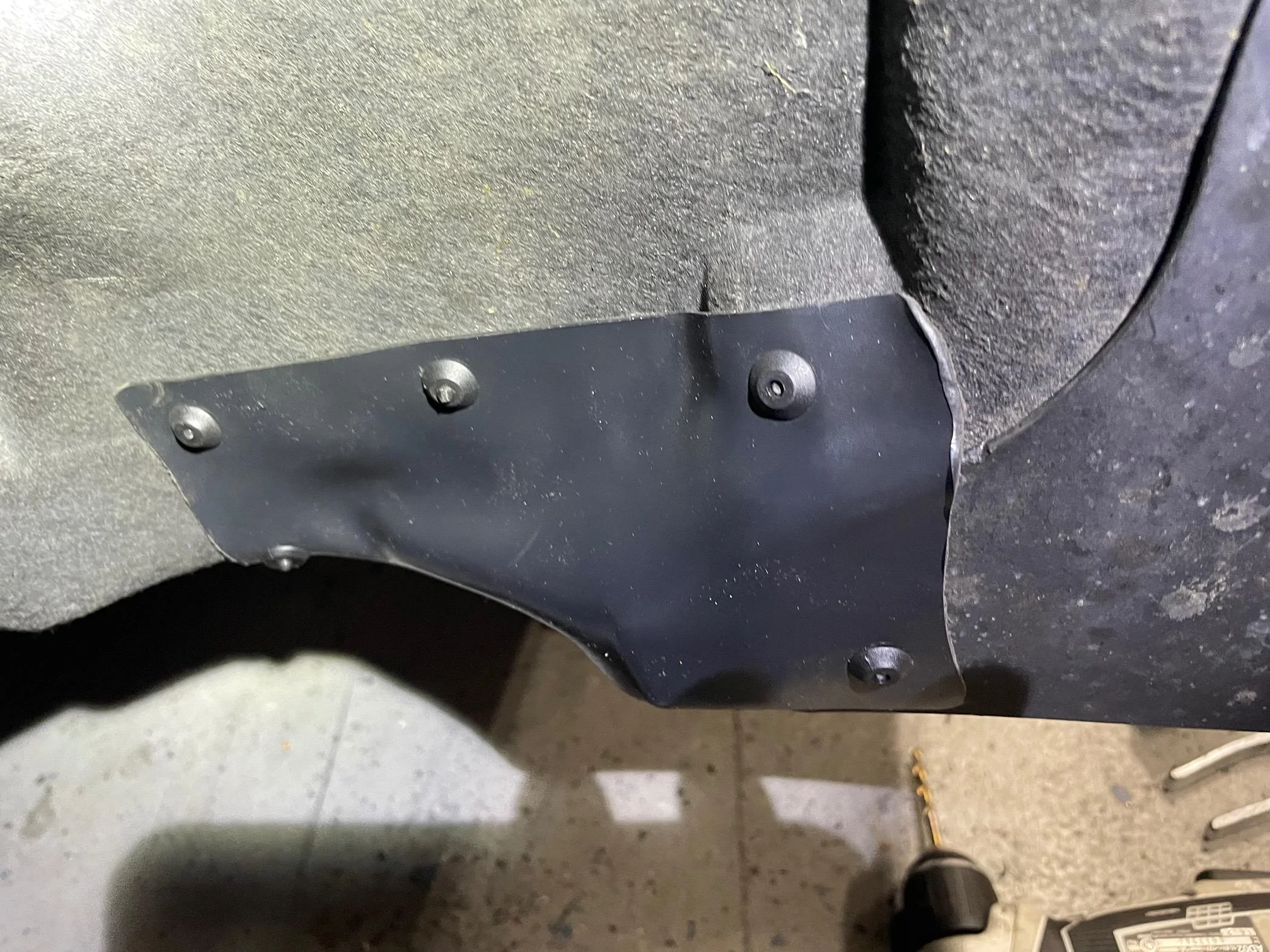

So i went kydex route like another member or two posted about while back. Very happy with the results. Cost was less than $30 for kydex and plastic rivet gun w/rivets. Took maybe 1.5 total as i took my time and I was doing it on Jack stands plus have a hip issue. Also took my time trimming with my scroll saw.
Looks great. I don't have any of the tools AND I have back issues. It was hard enough getting up and down to do the DIYVan.com solution. I managed.

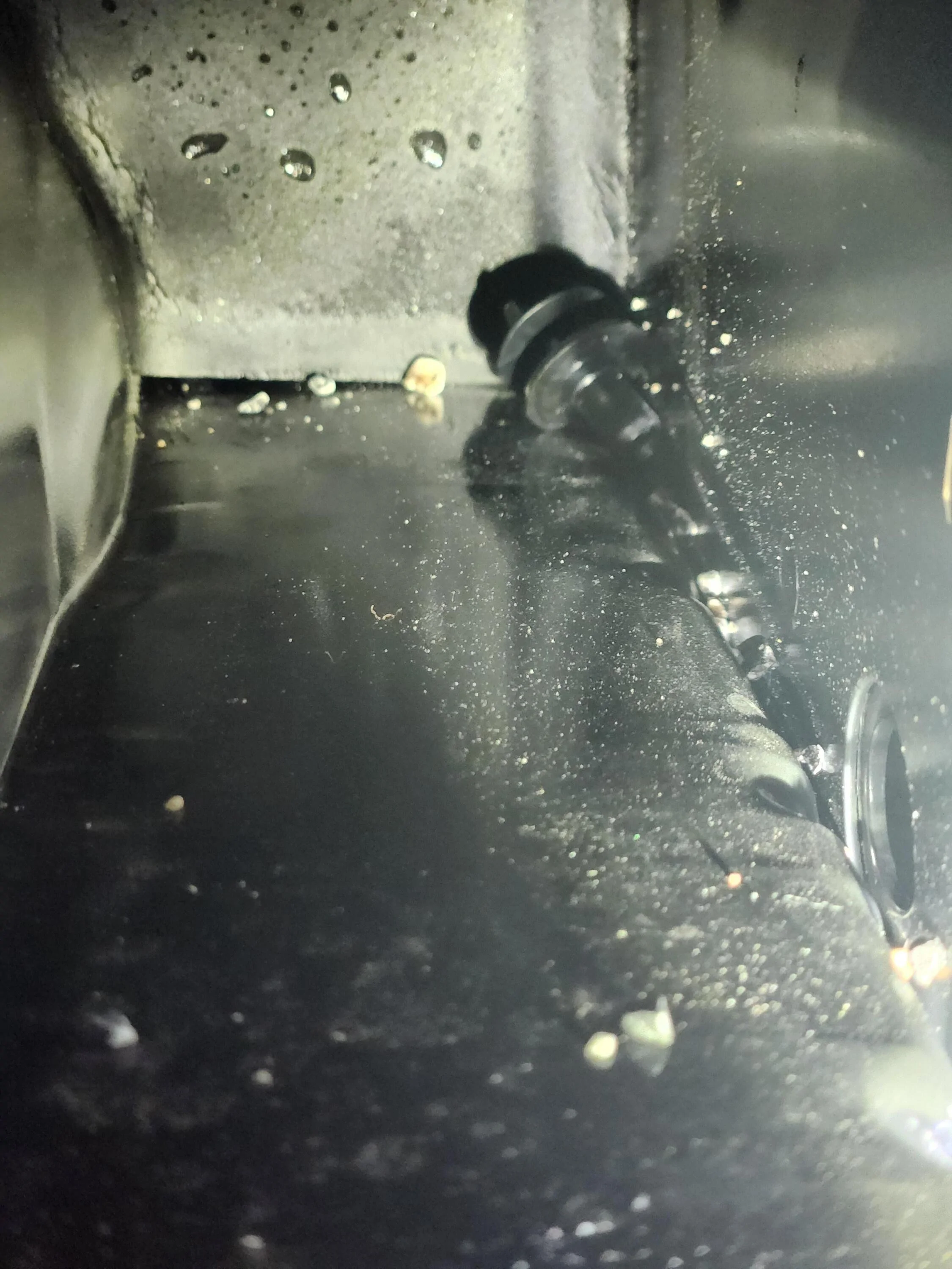

It’s too bad that Ford can’t simply acknowledge/address this situation and tell us that the holes serve a purpose and what that purpose is AND tell us that if the rocker panel fills up with gravel, stones, etc., that you can take it to your dealer and have them clean them out even if your warranty expires. It could cost them a lot to recall every S650 made thus far and cover up the holes. On the other hand,
I believe that Ford should come up with a rubber/plastic “plug” that the owner can simply pop in, fits snug and solves the problem. In the meantime I will probably just use Gorilla or Flex Seal tape to cover the hole…and if Ford says those holes do serve a purpose then I can simply remove the Tape. You know that someone from Ford is reading our postings.
