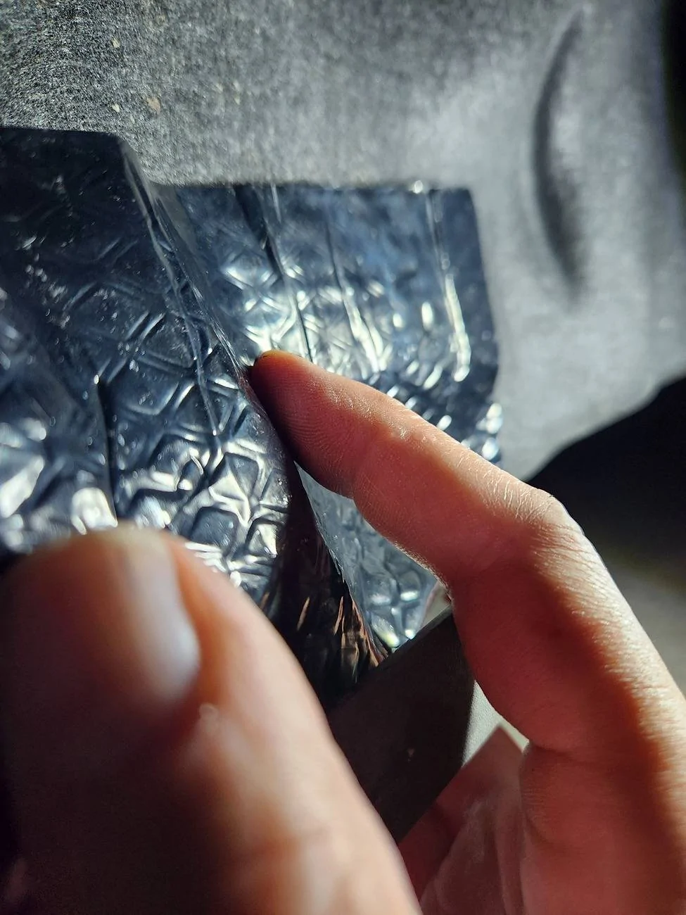

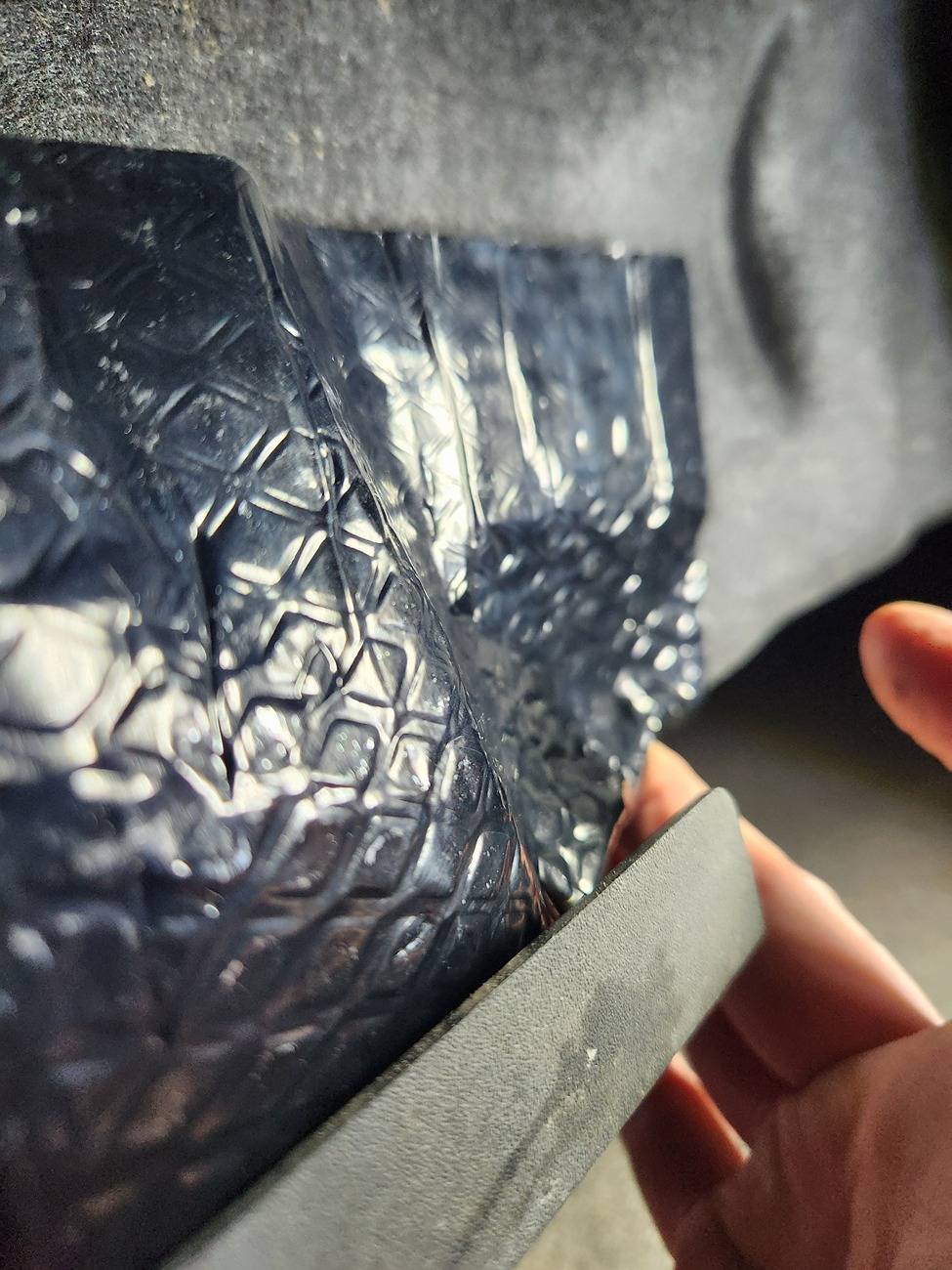

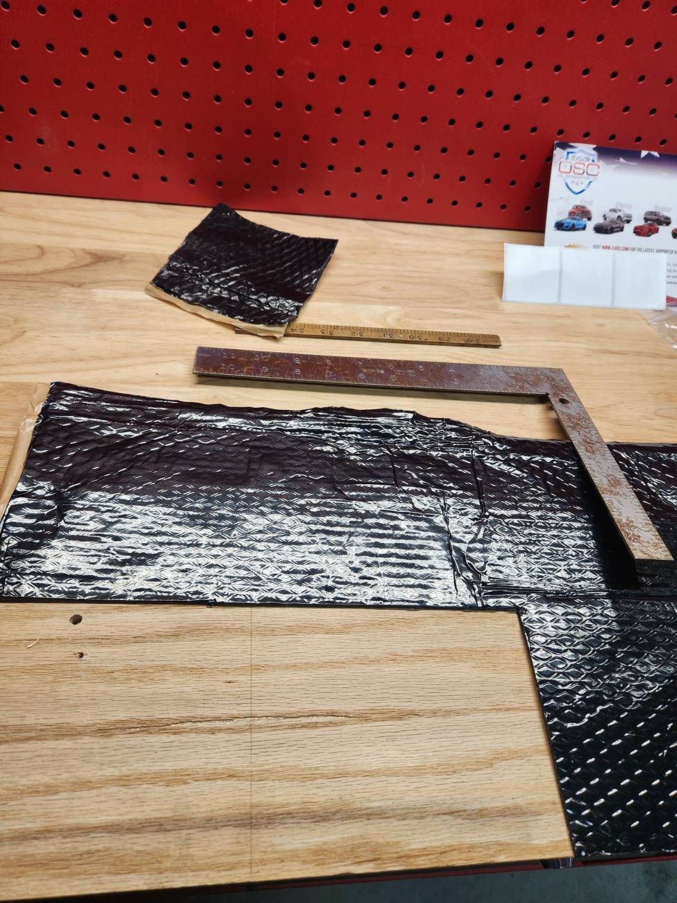

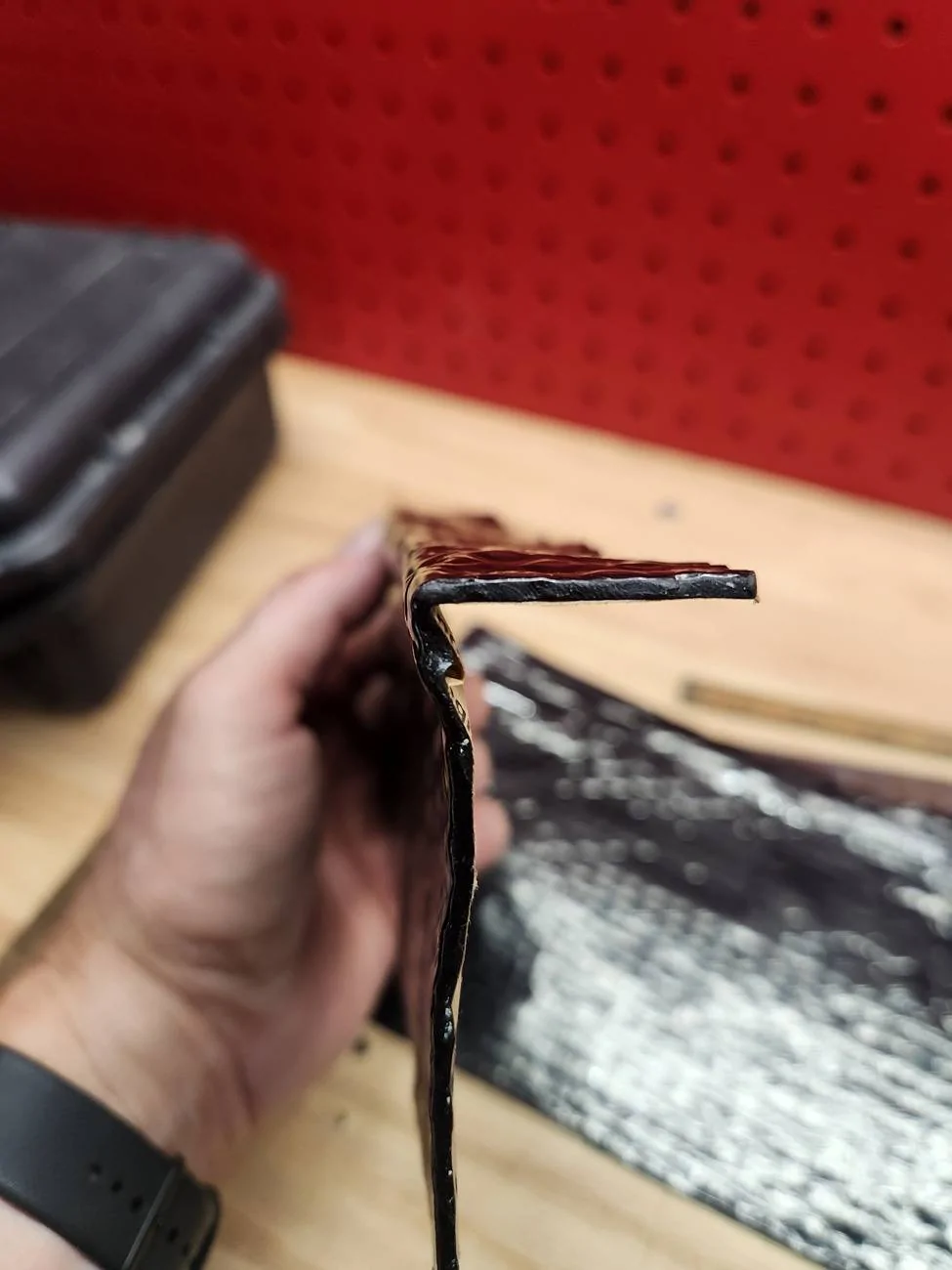

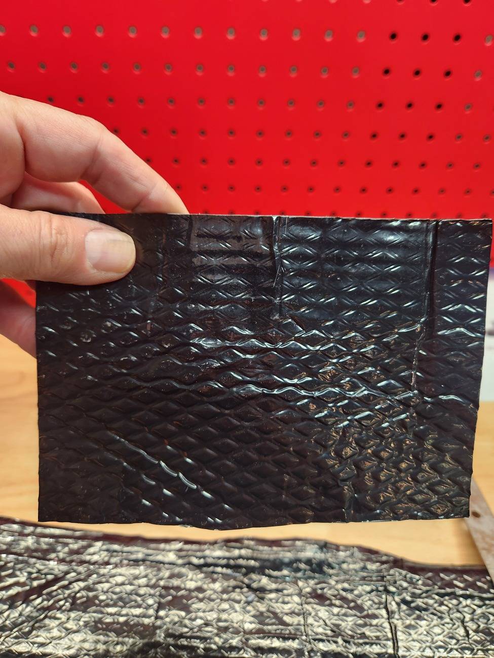

Hi all checked my mustang tonight and I'm going to try Acoustic Insulation. I posted pictures;
It has an adhesive on it, but I'm going to still use JB weld around the perimeter of it. The insulation is very pliable and tough. the piece I'm using is; 5x7 and I can mold it to the hole. I'll be getting the JB Tomorrow and will put it on and I'll let it cure until the weekend. I can also turn the tire to give me more room. I'll post pics after it is finished.
What would you all suggest to use to clean the wheel with prior to sticking it on?
