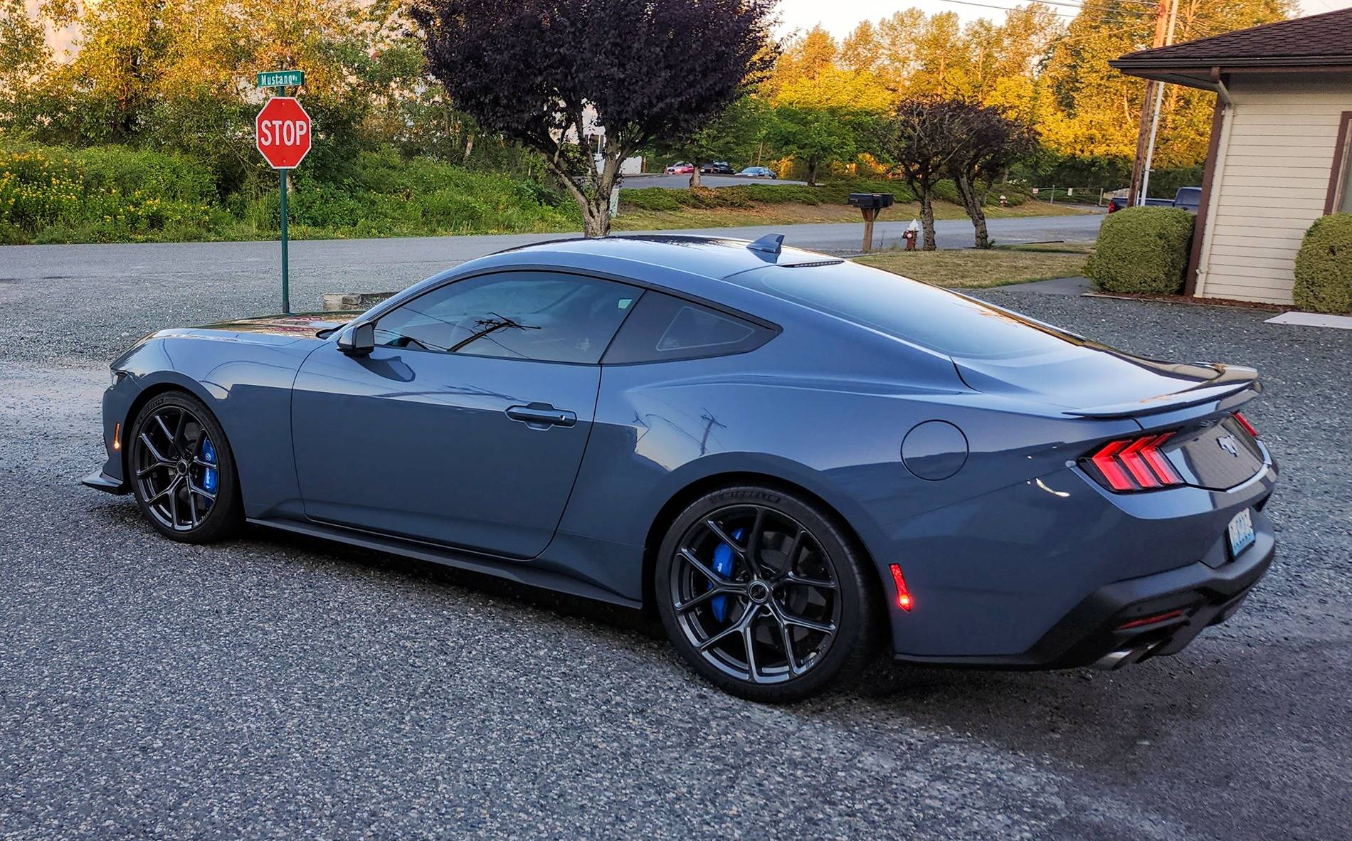

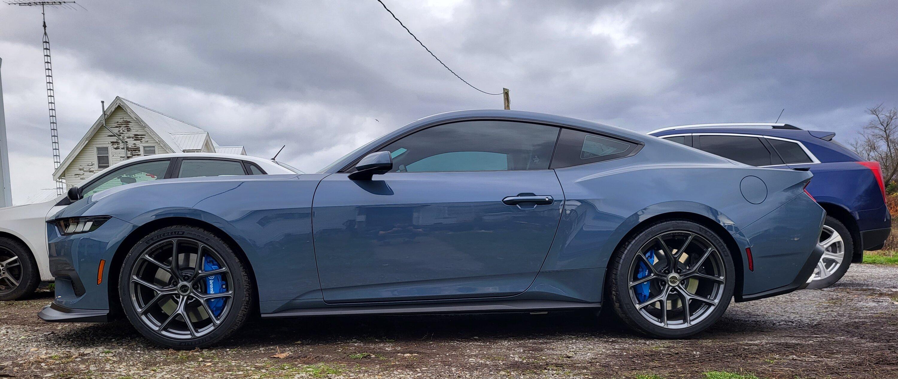

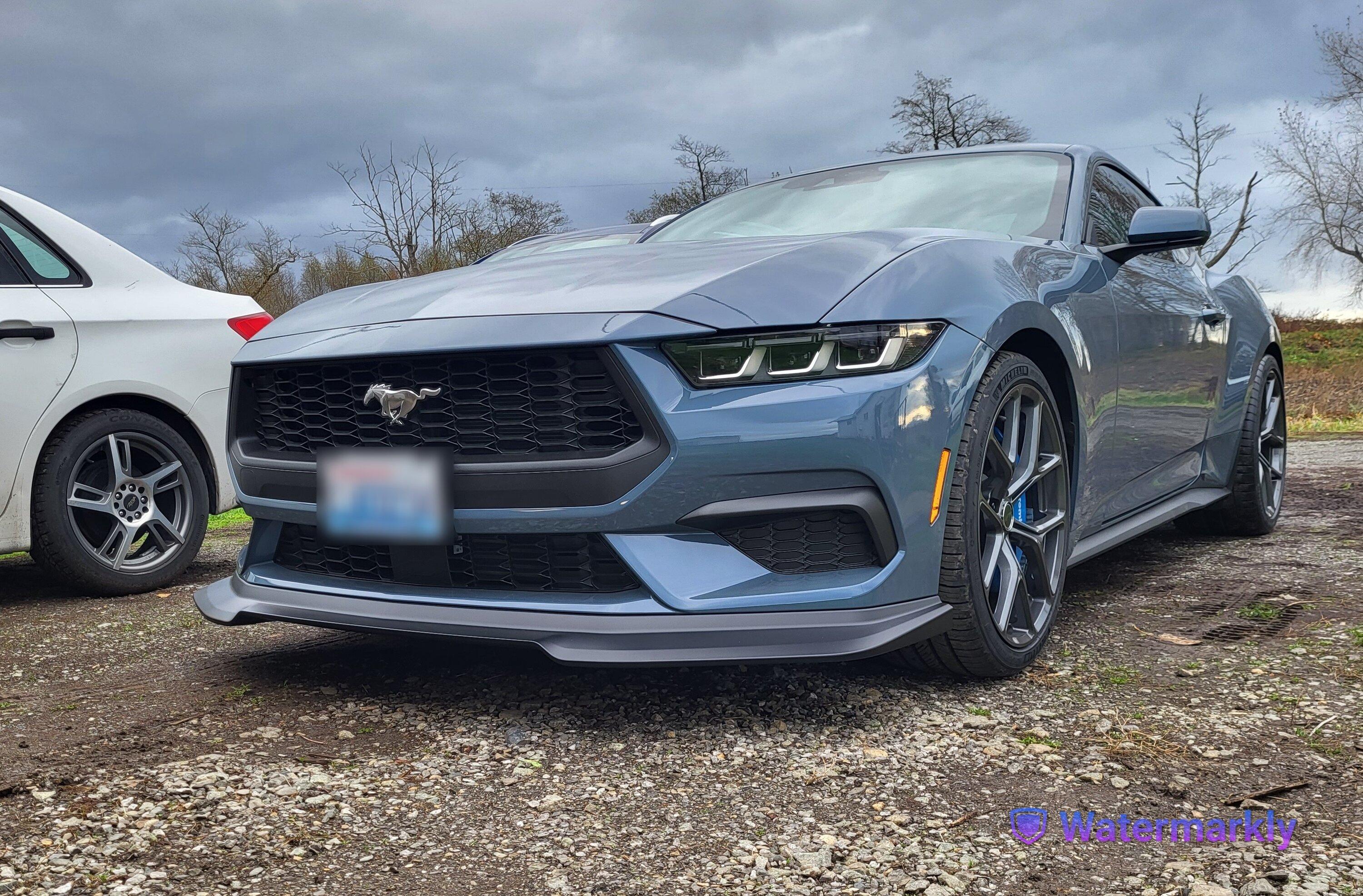

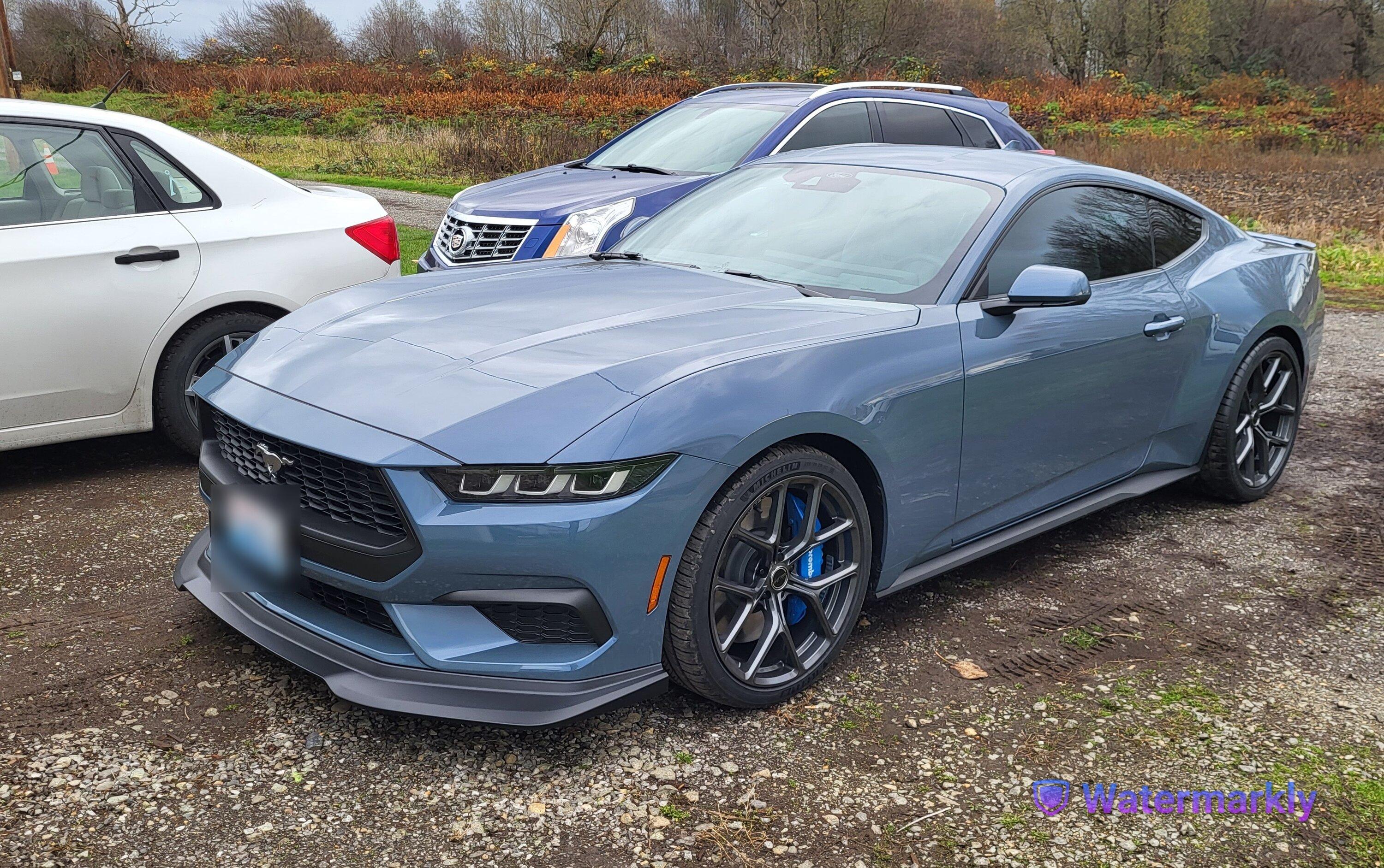

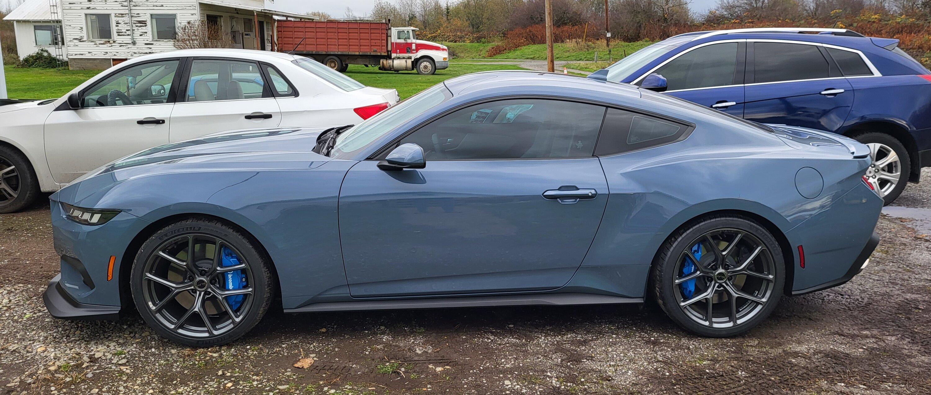

Picked up the car end of September. Had wheels waiting for it and installed the first week. Carroll Shelby CS-3 wheels, 20x9.5 & 20x11 with Michelin PS All Season 4. Windows tinted a couple weeks ago. Did a ceramic coating on the car and wheels I got parts in this past week and installed today. I ordered Steeda stop the hop street starter kit and an RTR front splitter. Actually ordered the front splitter a week or two after ordering the car and it took a month longer... not complaining as it's to be expected with new parts... just thought it a bit funny. Got the stop the hop kit not so much for launching the Ecoboost, but always felt like the back end was a bit too flexible (in the S550 as well as the S650). This should stiffen things up considerably and also has the rear subframe centering sleeves... which it appears my car needed. Trying out the RTR splitter as it may make the car look lower without actually lowering and it doesn't look like an S550 splitter (new Gen needs a new look). I still have some rock guards coming Monday, but not sure yet if I will use them. Haven't had much in the way of sunny days since picking it up... but got a few pics while it wasn't raining.

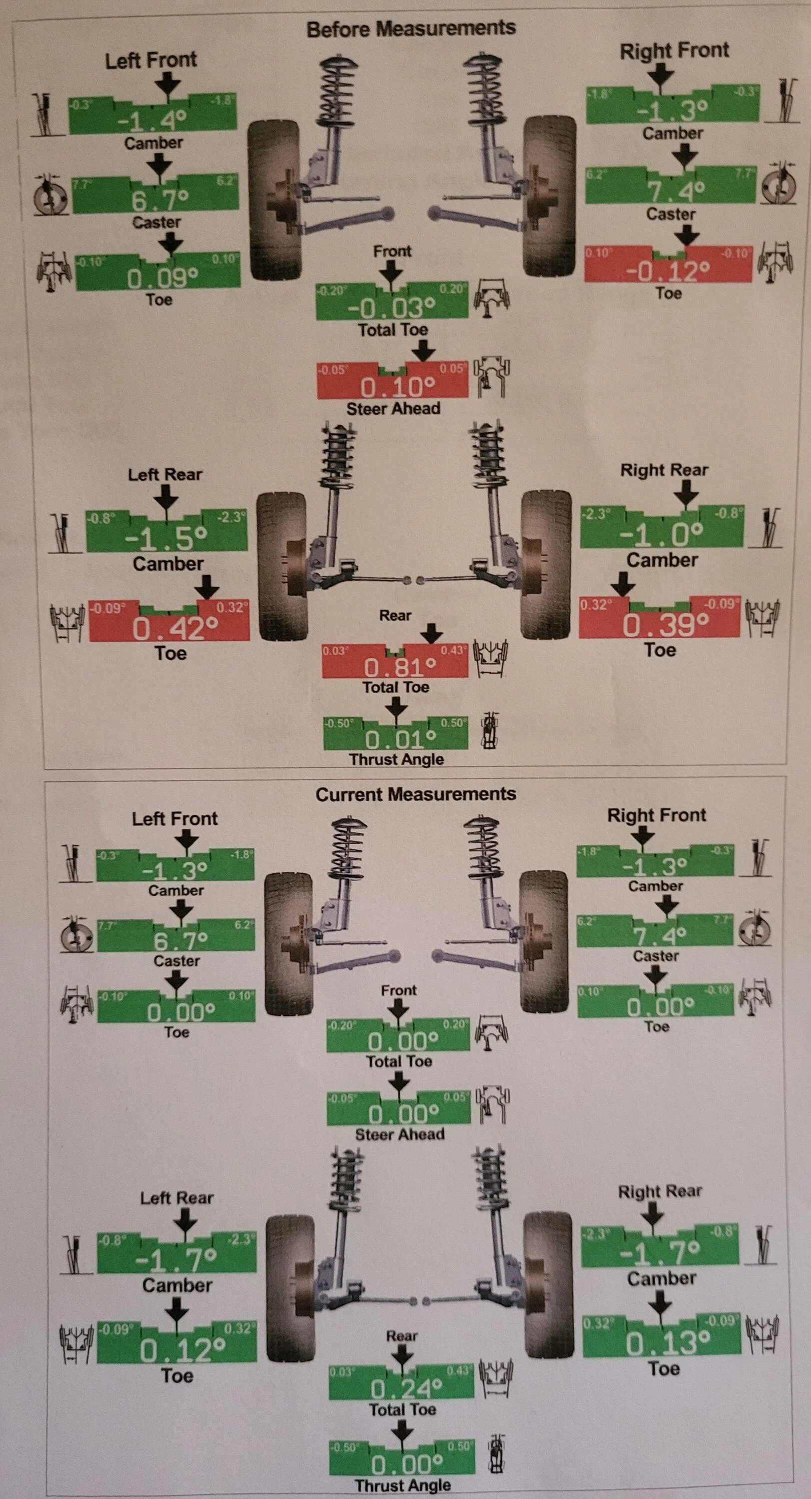

Took the car for an alignment today. It is recommended after the Steeda stop the hop kit... but I knew as soon as I put the 305 tires on it... the drivers side was even with the fender and the passenger side poked out a little bit. I used a digital level to check camber... 1.6 on the flush side and 1.1 on the poke side (1.4 each up front). Looks like my level was pretty close... can't say as much for the alignment from the factory. Though installing the stop the hop kit could have moved things around a bit.

Very nice look. Definitely interested in that splitter after seeing it on yours. Apologize as I may have missed a few details on the offset of your wheels as well as I don't believe you are lowered, right?
I had Steeda Progressive springs installed with 1" spacers all around (on stock 19x8.5 wheels) and had an alignment done afterwards as well. My driver's front is at -1.7 camber and passenger side at -1.6, and interestingly enough I now get slight rub on hard bumps at speed on the passenger side only.
So wasn't sure if you were experiencing anything similar at the -1.3, but possibly not if not lowered. I was shocked that the 1 degree difference would cause rubbing on one side vs. the other.
