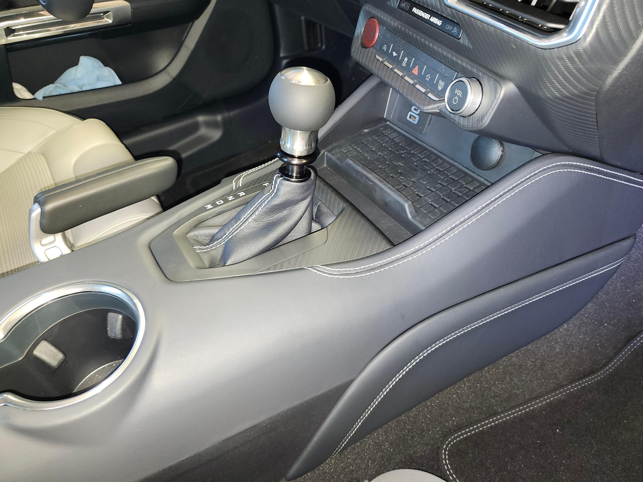

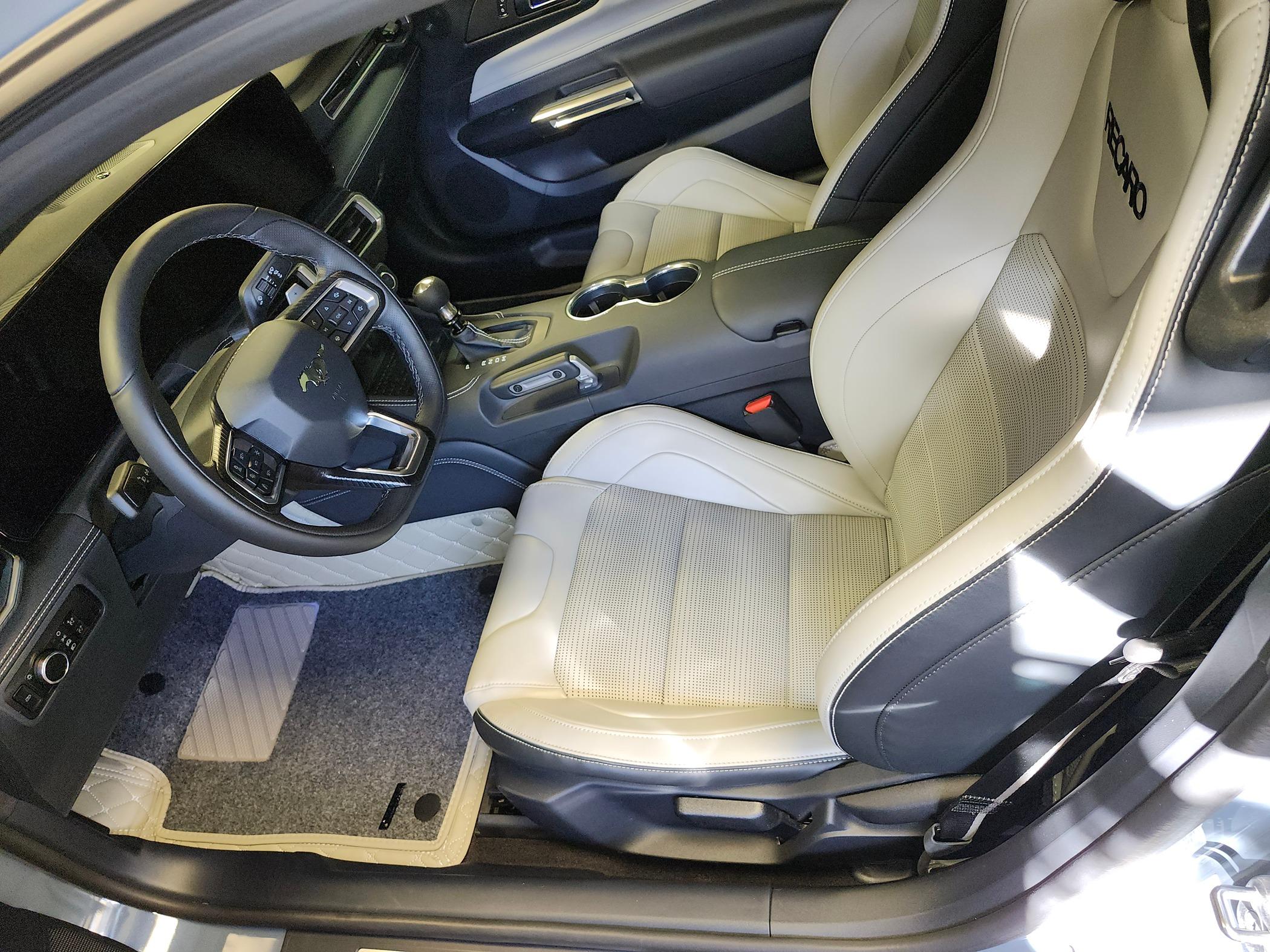

Added a new (modified) Billetworkz Fusion shift knob. Put in some of the fancy looking floor mats, color match wasn't too bad. Last week I added a Turbosmart BOV and K&N filter... not much in the way of horsepower, but throttle response feels improved.
