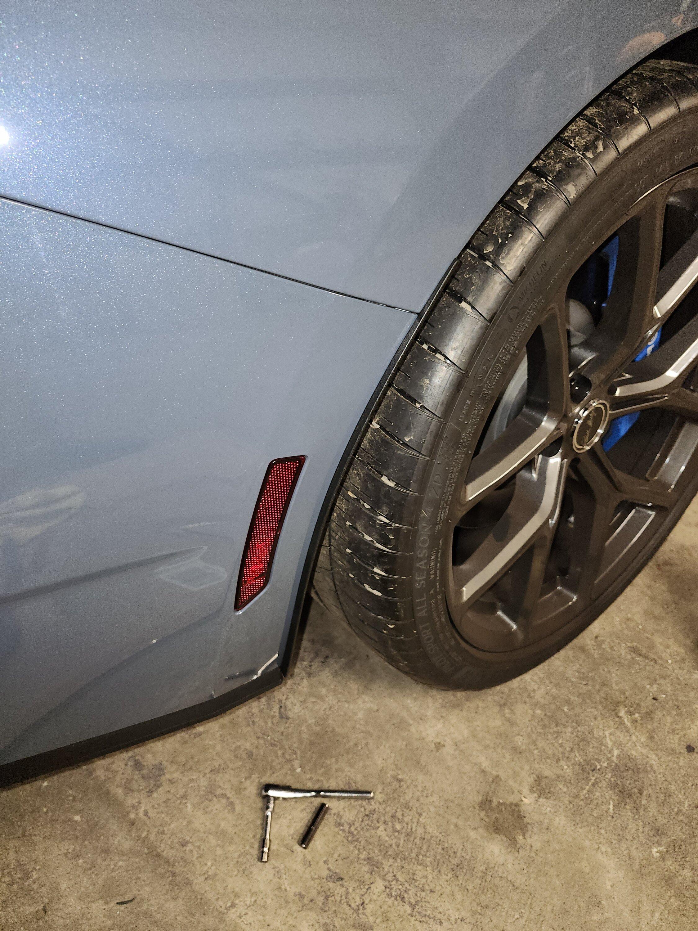

Yeah, not lowered... the splitter sort of makes it look like it is. Wheels are 20x9.5 40 offset front and 20x11 50 offset rear. A half degree difference in the rear camber was quite noticeable with one side even with fender and other side poking out a bit.
