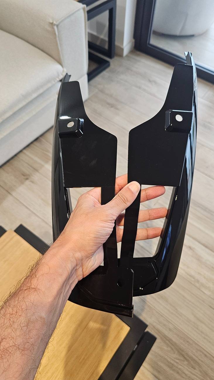

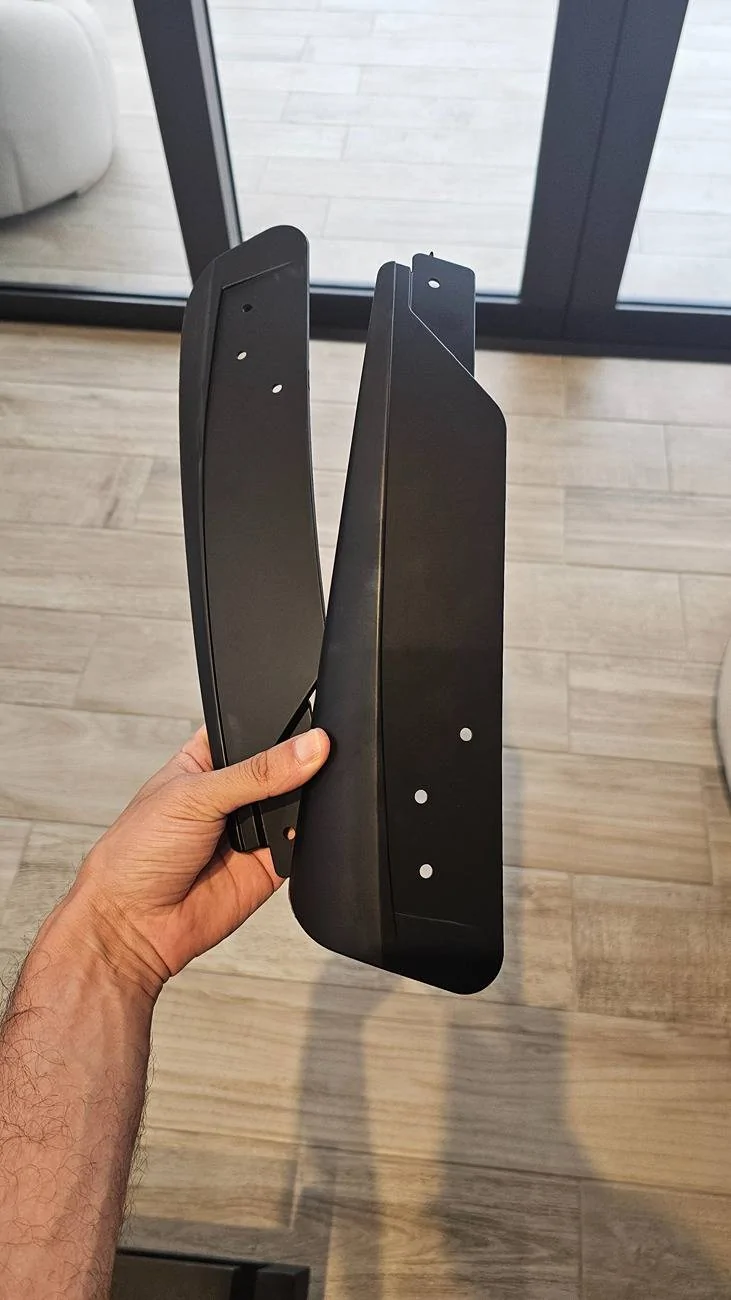

I didn't like the ones from ZL1 addons... even though I also tried trimming them down. I think my front tires @ 265 are not it too much need of guards, and the DH HP rear guards seem to give enough protection for the rear @ 305 without looking ugly (like a truck).

I have the Extreme Online Store ones, and they stick out way more than OEM, but they also stick out way less than other aftermarket mud guards.
A few days ago, somebody on the forum, don't remember his name, he sells mud guards too, told me that the rock guards that I bought are non-functional and only cosmetic. Well, in that case, if mine are non-functional, what are yours? Self destructive? lol.
They sent me matt for the front and gloss for the rear

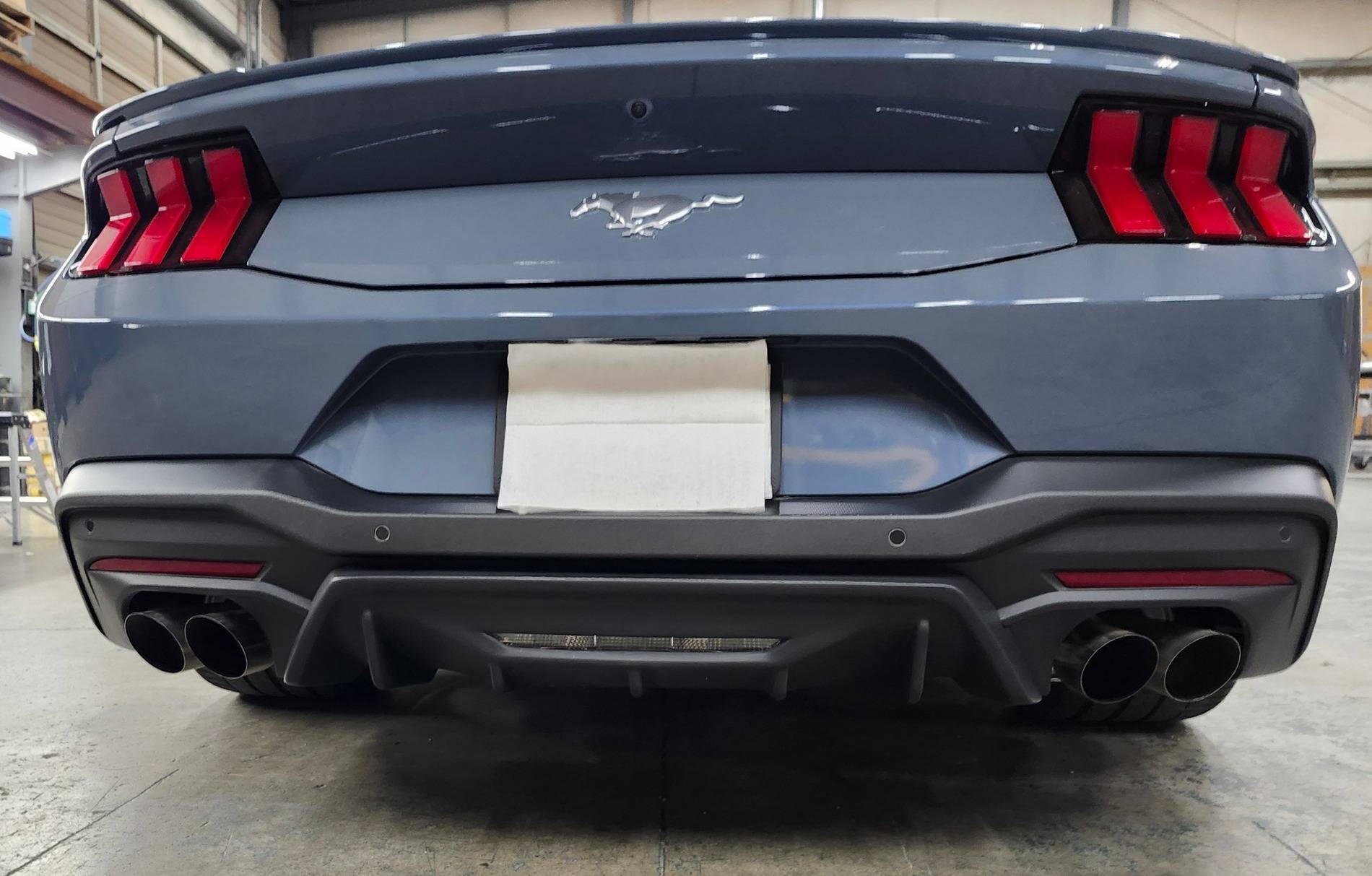

I added the NYTOP rear diffuser in plastic... figured if I went CF then I would need other CF parts to go with it.

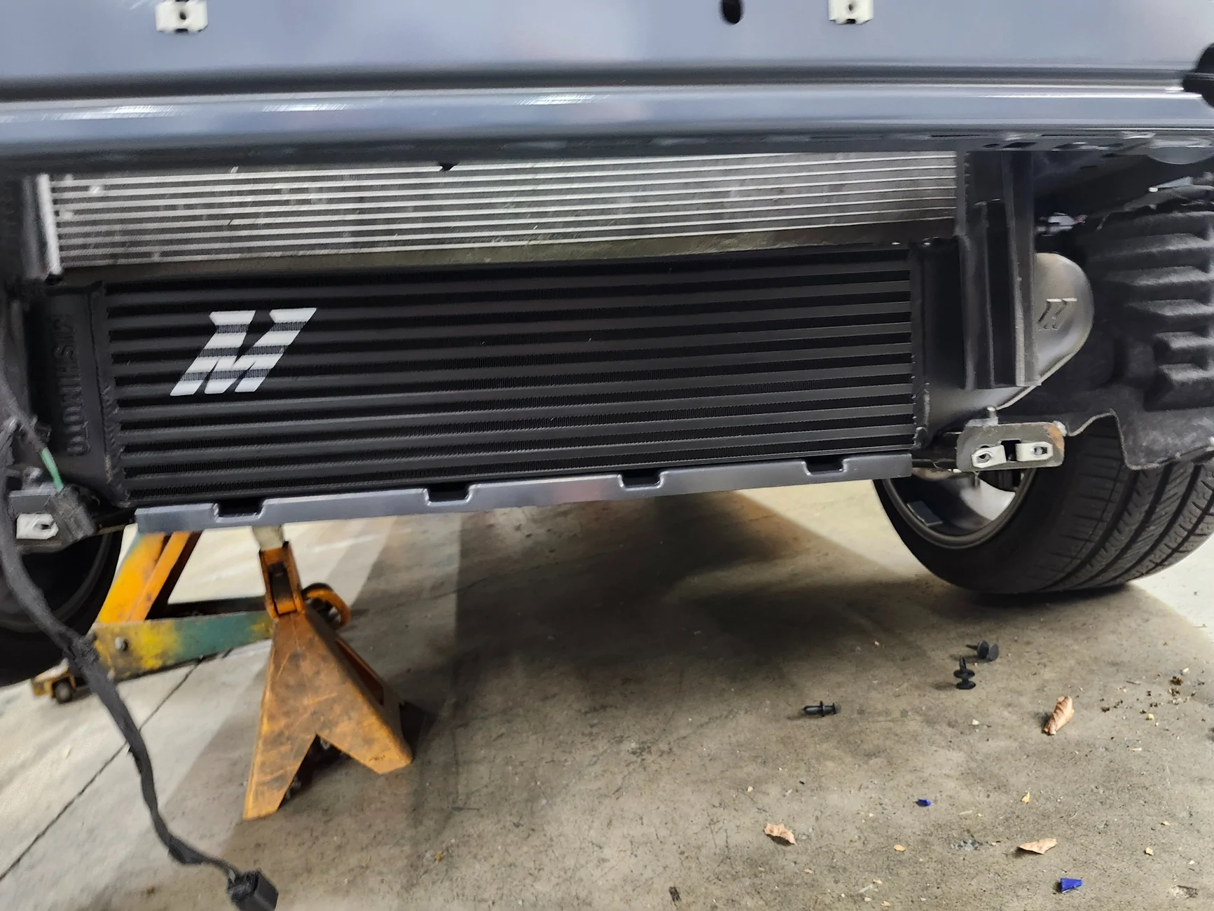

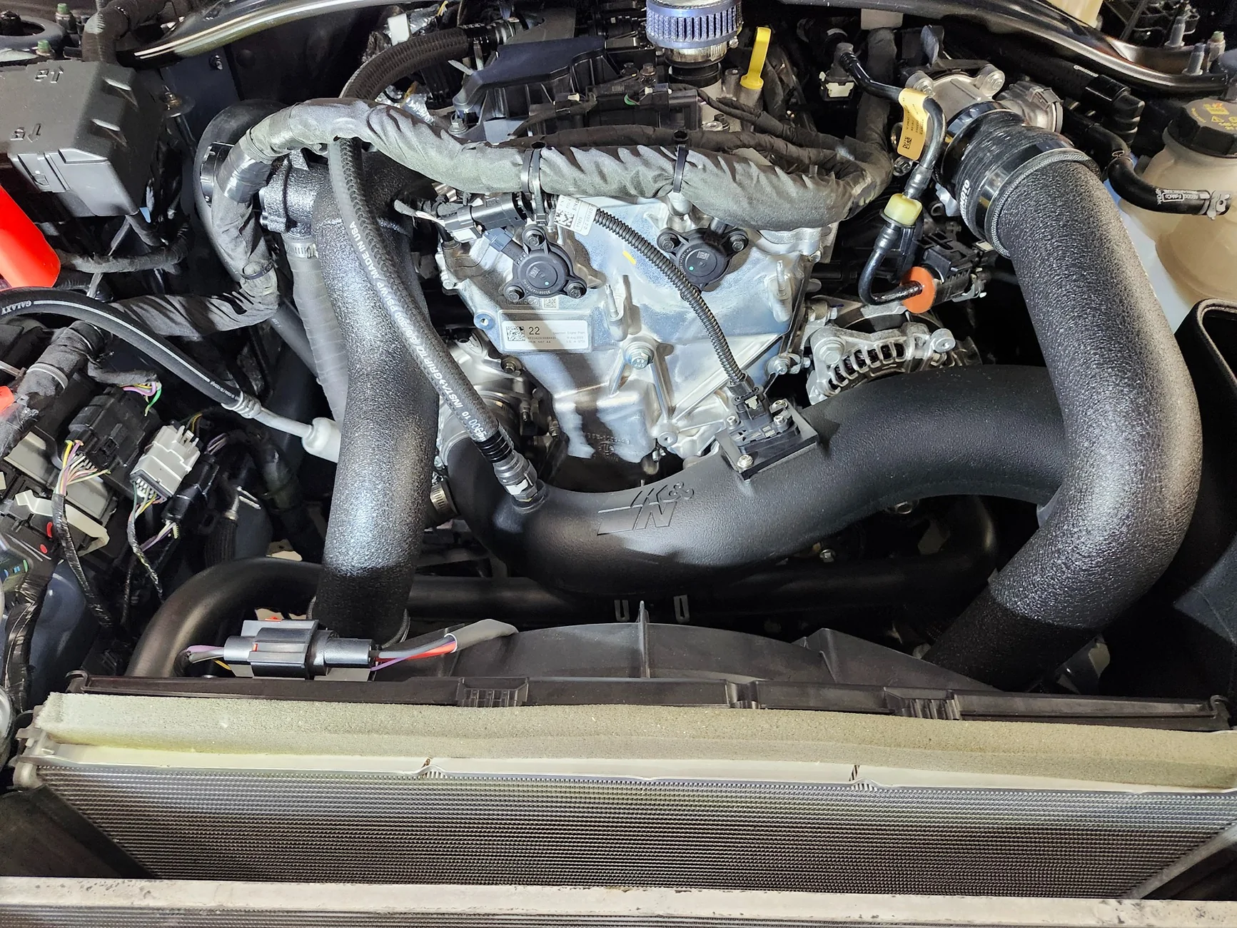

Today I finally added the intercooler and charge pipes... the front end was a bit harder than I remember... of course it has been a few years since the S550. I think cj ponyparts has a good video of the front end removal IIRC... though S550, it is all basically the same. The bottom tray doesn't need to be completely removed... it can remain attached to the front end... just revove fasteners along the rear/center and around fender wells. I managed to mangle many of the "fir tree" style plastic rivets around the air shutter frame (PP only gets the frame but no shutters), so bought a pack (of 10 I think) to replace all of them.
