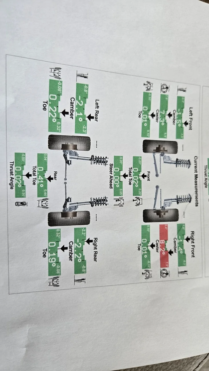

Sorry to revive this old post, but looking for some advice regarding my recent alignment reading after installing the Ford Performance street lowering springs. To note, I did have the Steeda stop the hop kit installed a few months back but never got it aligned after.
The alignment tech told me the 0.4° caster difference is minor and shouldn’t cause any issues. He also mentioned that the difference is likely related to the Steeda bushings. The car tracks straight and I haven’t noted any pulling.
Does that explanation sound accurate? Has anyone else with the Ford Performance springs and/or the Steeda Stop the Hop kit seen similar caster readings? I’m mainly trying to determine whether this is normal and can be left alone or should it be fixed with some adjustable camber links.

I honestly am not an expert when it comes to alignments but I’d try to ask maybe other alignment shops and preferably a non dealer like a performance alignment shop type of place. Or at least a shop that knows how to work on modified suspension. I have the bushing support kit from Steeda, and the FP street lowering springs, and I had no issue getting aligned.

The stop the hop kit shouldn't affect the caster... stop the hop is in the rear, caster is in the front. That variance in the caster is pretty normal... and not really adjustable... not really an issue. Camber in the rear can be adjusted (and should be)... did they try that at all?... it looks as though they did not... just adjusted toe.

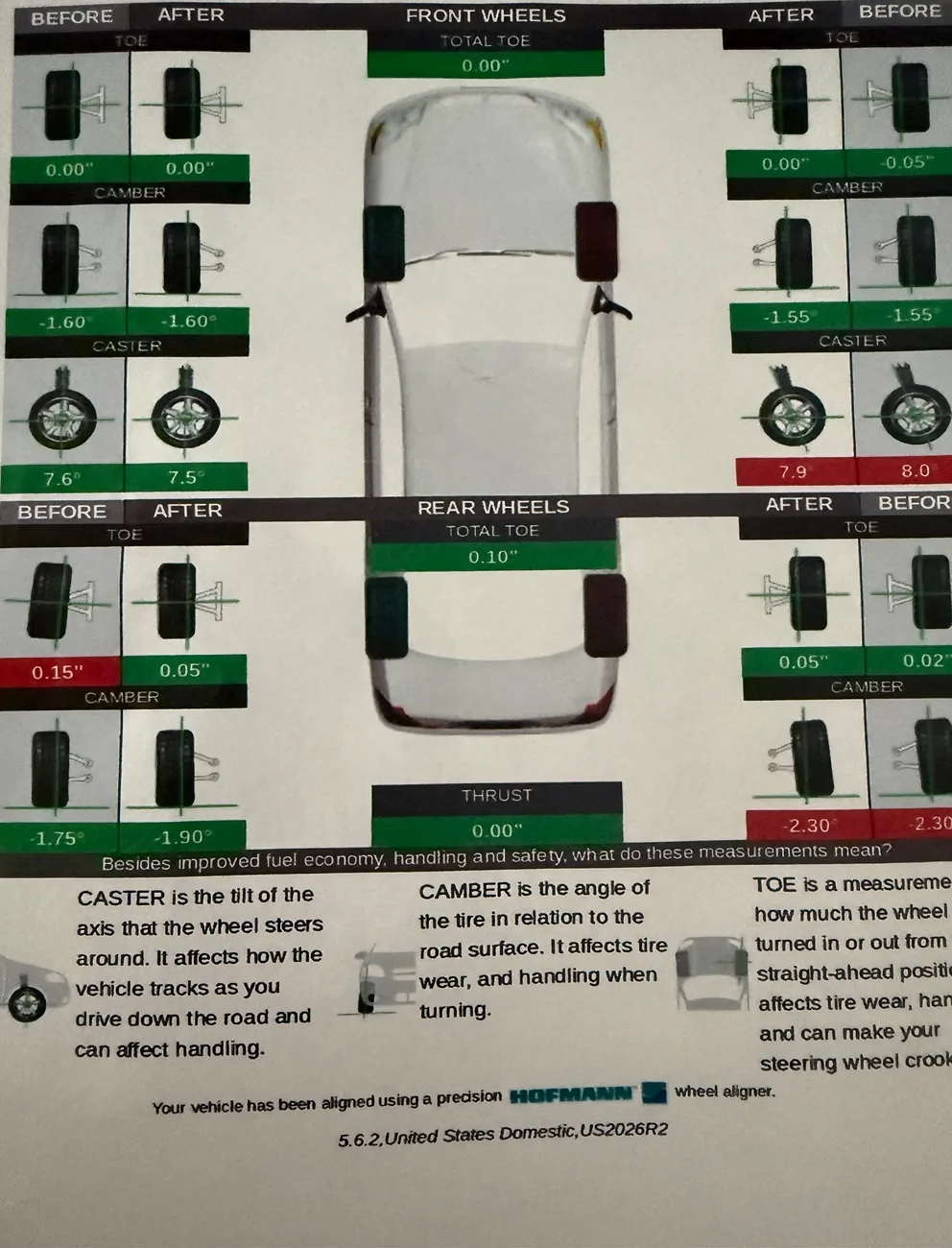

Did you have issues with alignment after, I got mine installed today and my toe seems way off. Don't know what the Ford tech did.
I didn’t have any alignment issues, but I will say I’m not an expert on what it’s supposed to be I just wanted to make sure it was all in the green 😅 I did end up swapping the springs for some street springs from ford and changed out my shocks and struts. I added Ford Performance adjustable camber plates.

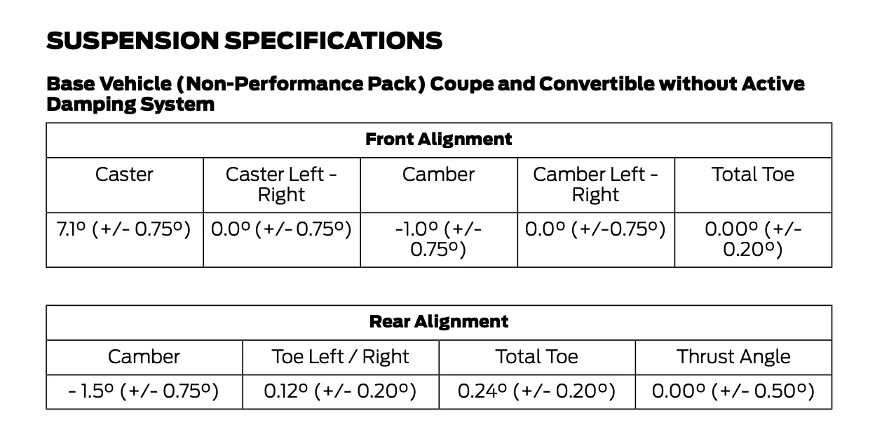

Go back and ask him to align again. caster is off , rear toe is completely off , rear camber is with in specs technically , but he can do better than that . Show him this chart from the owners manual . ask him since you are lowered about 1 inc , do you keep the same specs or different and what are those? he probably does not know and does not give a damn .. otherwise he would't have given you the paper with the red box...🐒

The rear toe is within spec technically and the rear camber but it's like right on the edge, should I still go back
