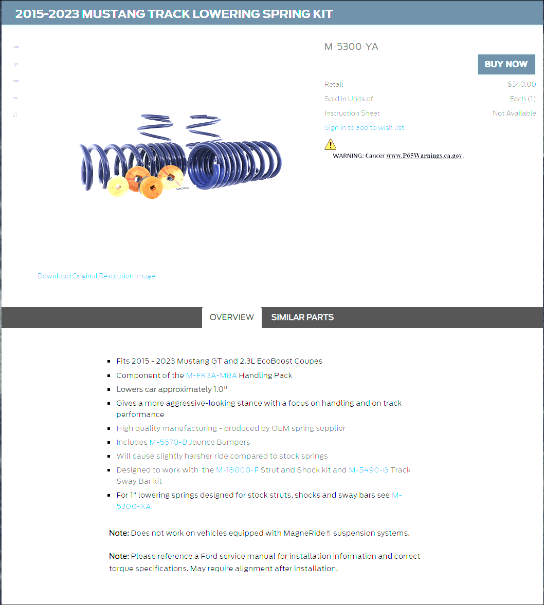

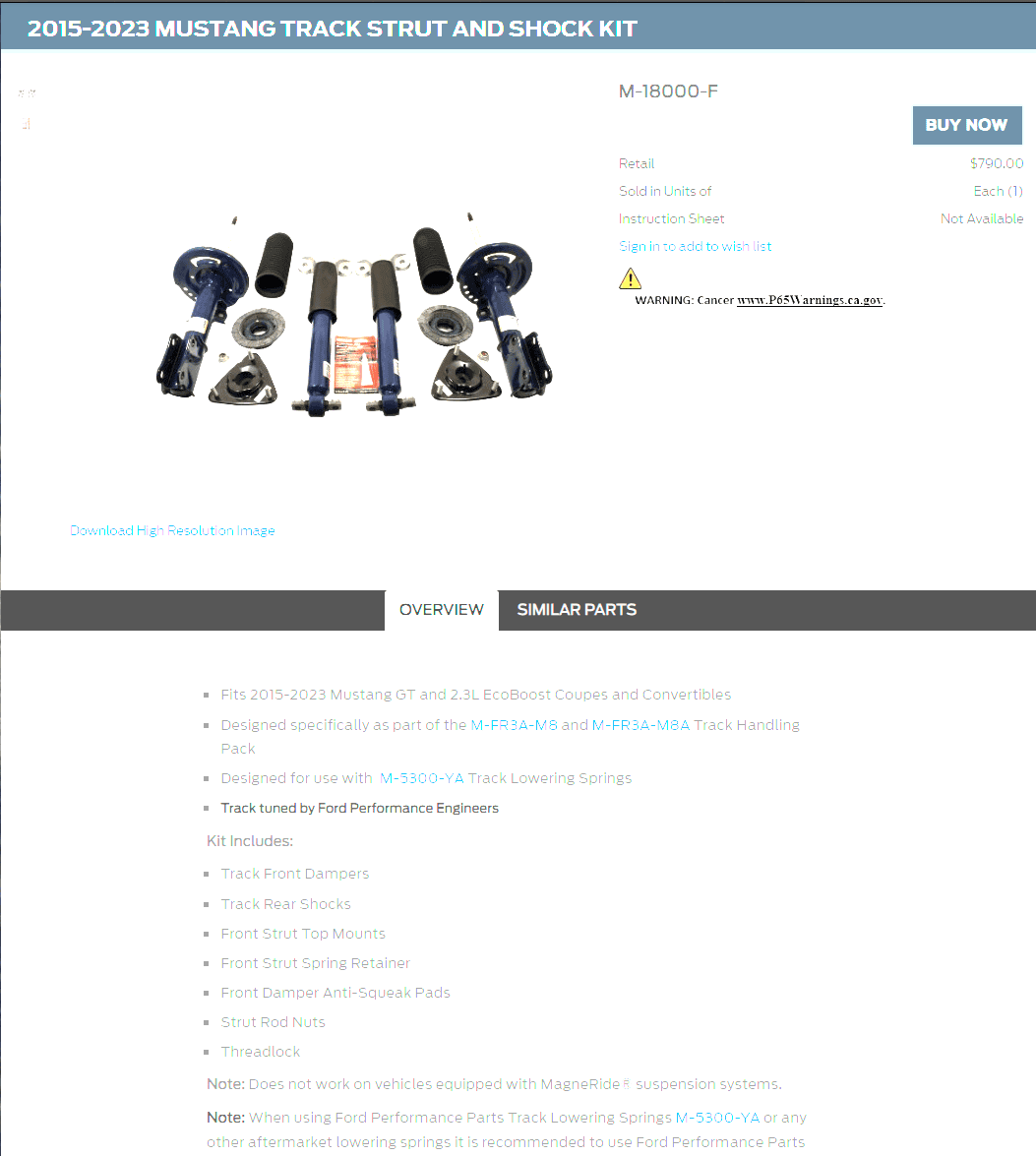

The S550 Track Springs did come with new dampers/struts as one whole piece. I will certainly be waiting for the full set because there's no way the stock dampers match these springs
Yeah I thought so too but says Ford made it specifically for the passive suspension, and has revised rate on their site and listing. Steeda’s site goes into more detail saying it fits stock suspension. There’s another one they made specifically for the 24 Ecoboost and it fits the S550 stock suspension as well if you go on to Ford Performance’s website. All that I was told was it’s a revised rate and FP rep told me it is made to work with stock suspension because I brought up the S550 track springs where it’s required to have those shocks and springs but I’ve seen the whole kit sold altogether as well for the S550 you mentioned. I did give them my VIN and told them I have a base non PP GT if not I would have gone with a different spring or waited till they released a street spring they’re currently working on for the S650.
Actually they were available individually. The kit was nice, as you mentioned you didn't need to use a spring compressor to install the springs on the struts. The Strut/Shock kit as well. Ford Performance actually sells the individual strut and shocks as replacements.

For those wondering about the new FP Track Springs. M-5300-S65T is made specifically for the S650 GT non magneride. There is a S62T made for the Ecoboost and fits 15-23 GT’s and Ecoboosts as well and isn’t like the last gen track springs that required you to have the track suspension package with it.

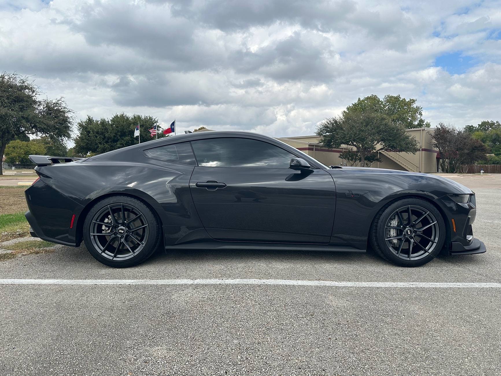

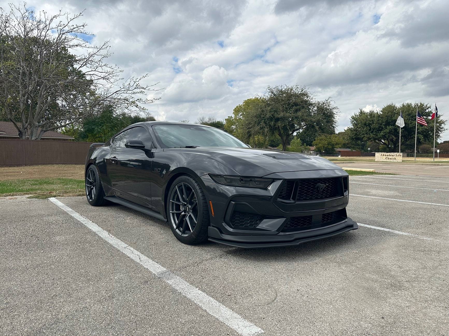

Anyways got these installed this past Saturday. So far I’m loving it after driving with them in normal driving conditions and spiritedly the past few days. The springs work great with stock suspension. The body roll compared to Steeda’s Progressive springs and FP street springs (15-23) is noticeably less. I have it paired with FP strut brace but for normal driving it’s great. Still comfortable but you can feel the car is less floaty/bouncy, and more planted. I live in the Dallas area so roads aren’t always the greatest but so far I’m in love with these springs and happy with them! The drop is just an inch all around. **wheels are SVE SP2’s with 285/35/19’s and 305/35/19’s Nitto NT555’s and no spacers**
Now for my only con when I got my package I received two insulator pads and one of them fit like it should and the other didn’t no matter how you turned it or which spring you put it on. Luckily Ford sent me the correct part and it should be two L pads for those that do order it and plan to install it on their GT.
