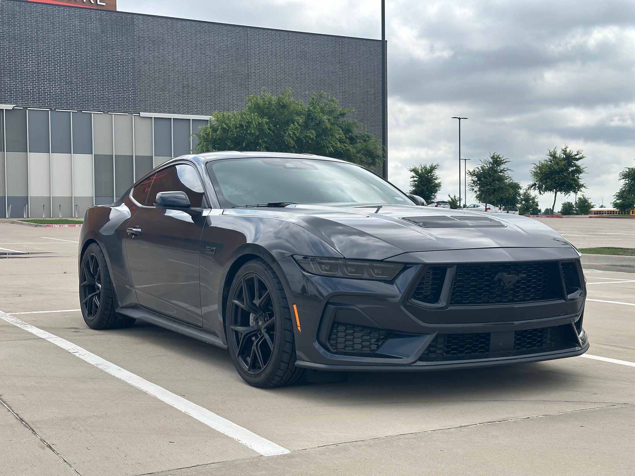

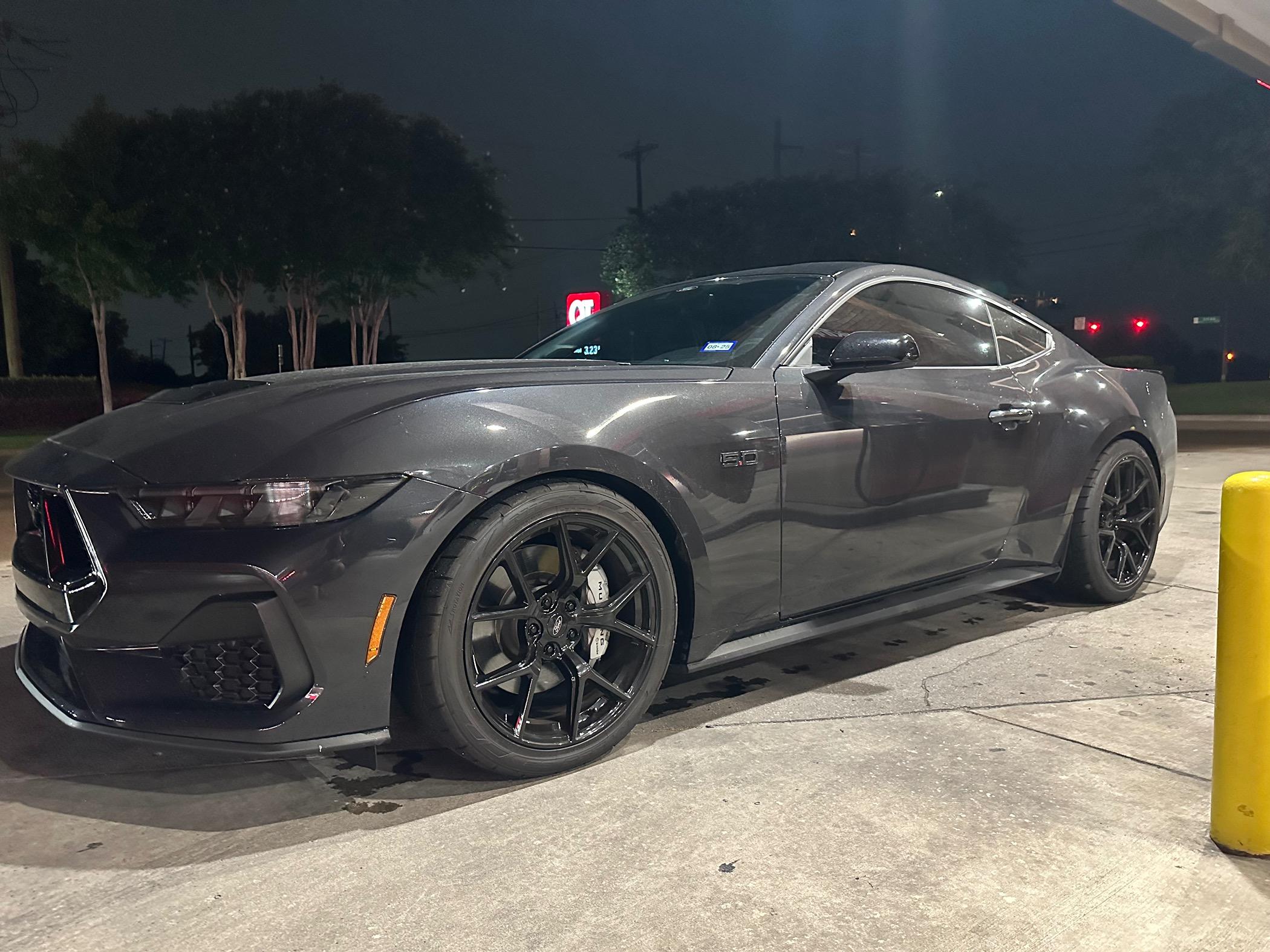

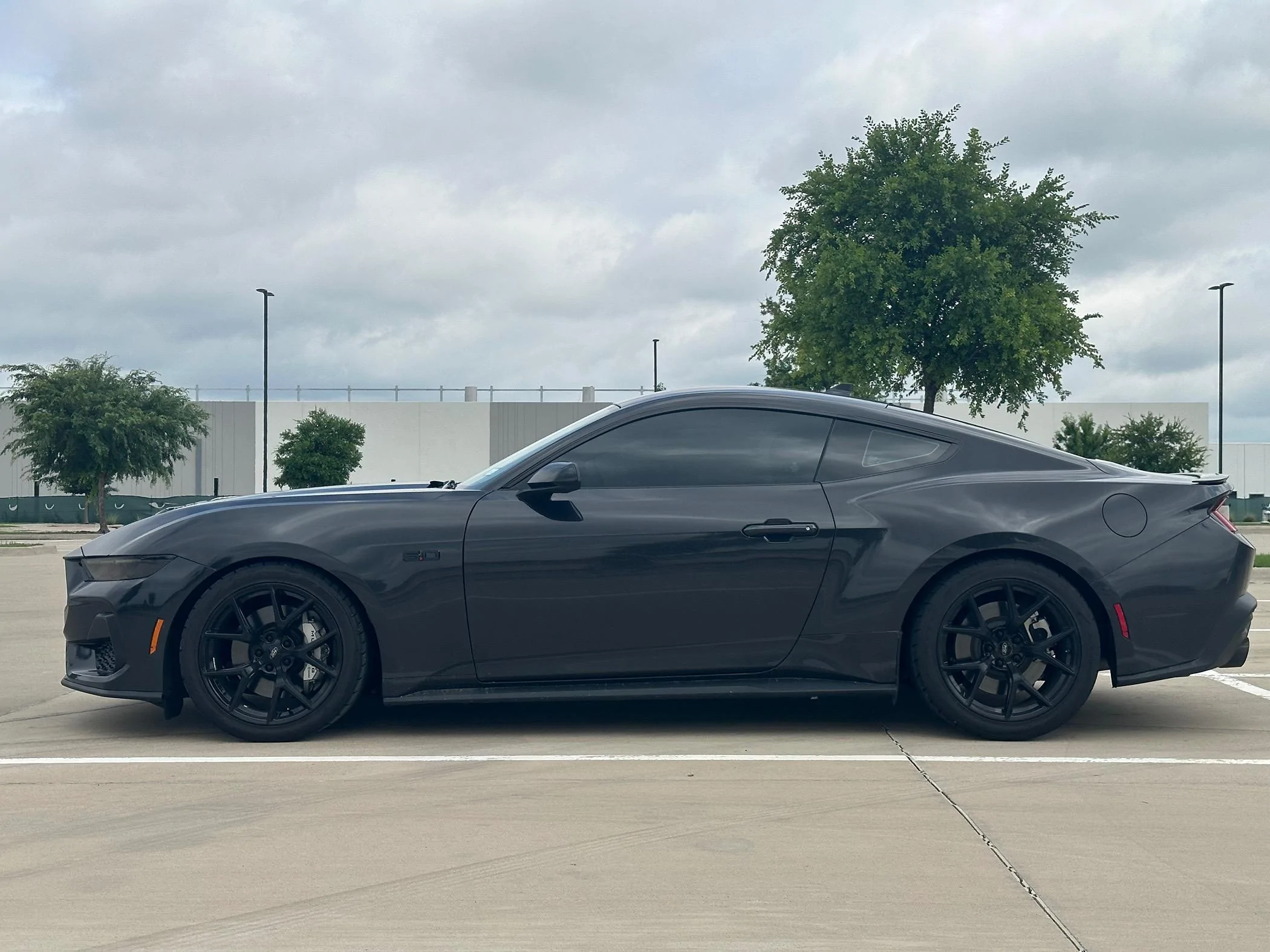

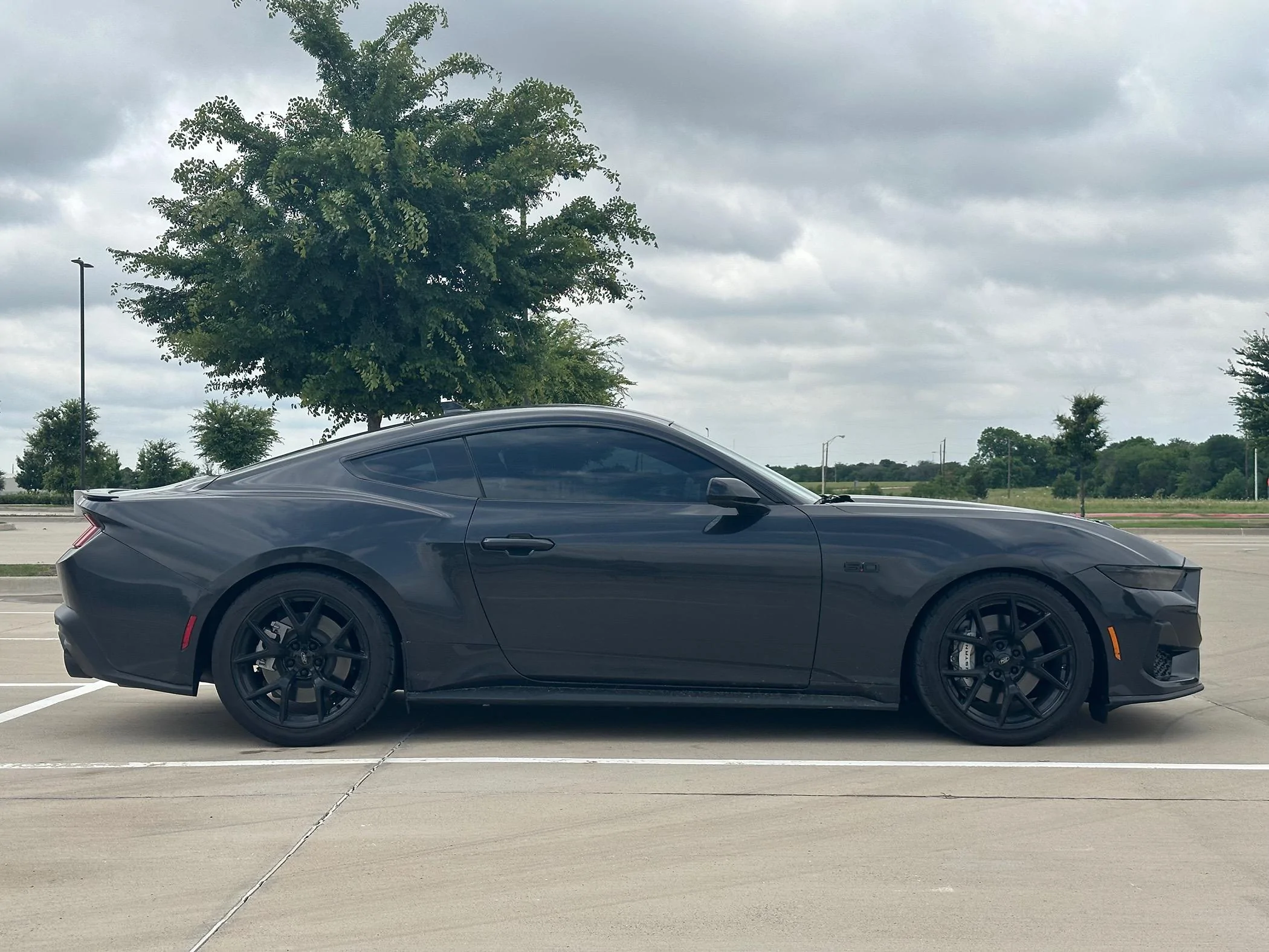

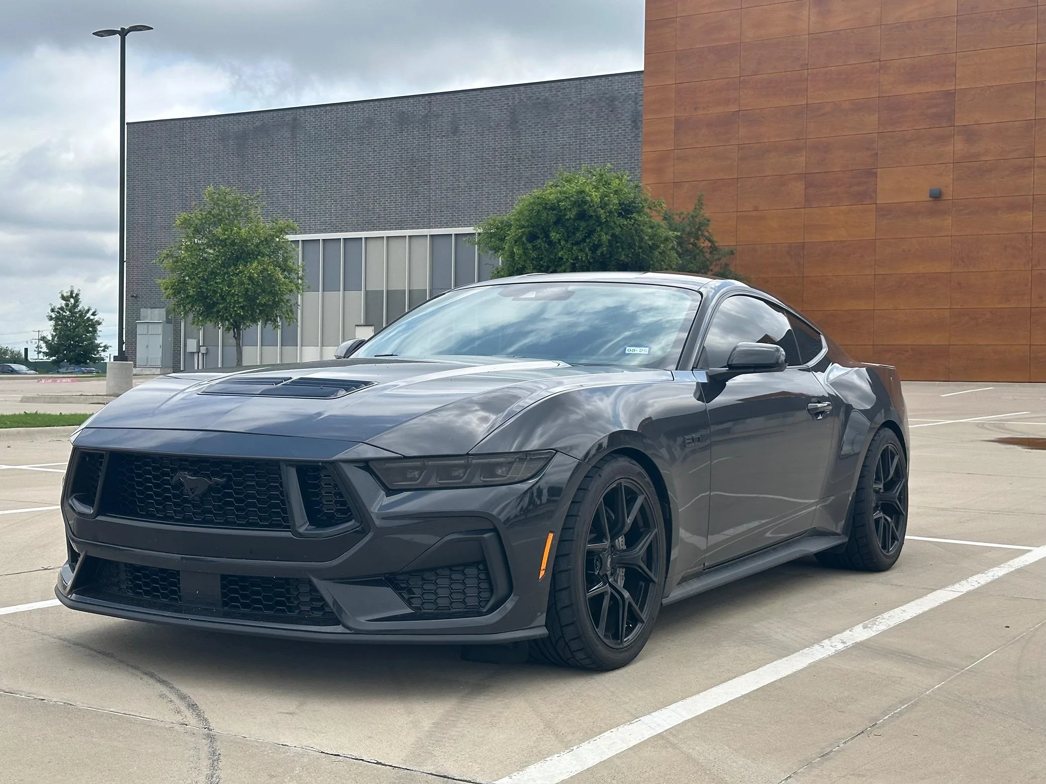

For those wondering about the new FP Track Springs. M-5300-S65T is made specifically for the S650 GT non magneride. There is a S62T made for the Ecoboost and fits 15-23 GT’s and Ecoboosts as well and isn’t like the last gen track springs that required you to have the track suspension package with it.
Anyways got these installed this past Saturday. So far I’m loving it after driving with them in normal driving conditions and spiritedly the past few days. The springs work great with stock suspension. The body roll compared to Steeda’s Progressive springs and FP street springs (15-23) is noticeably less. I have it paired with FP strut brace but for normal driving it’s great. Still comfortable but you can feel the car is less floaty/bouncy, and more planted. I live in the Dallas area so roads aren’t always the greatest but so far I’m in love with these springs and happy with them! The drop is just an inch all around. **wheels are SVE SP2’s with 285/35/19’s and 305/35/19’s Nitto NT555’s and no spacers**
Now for my only con when I got my package I received two insulator pads and one of them fit like it should and the other didn’t no matter how you turned it or which spring you put it on. Luckily Ford sent me the correct part and it should be two L pads for those that do order it and plan to install it on their GT.

That looks like the perfect ride height. Some other springs I've been looking at do close to a 1.75" drop, and it makes the top of the tires just about tuck. I like the nicely fitted look inside the wheel well so much better.
Going to pick these up!!
if you have FordPass points you should use them! But definitely recommend. I’m even wondering if I should add sway bars at all because it handles corners pretty great, and I like the drop too since I had rubbing issues with Steeda progressives. I did speak to a FP rep about the street lowering specifically for the 2024’s and they’re in the works at the moment just no release date yet. I’m assuming it’s the same ones on the FP800S package and with revised rates for the S650 like these new springs I have on. I’ll be curious to see how those will feel and perform.

Your ride is sharp it like how it sits like my Dark Horse with HP lowered springs. wonder if the spring rate is similar as I know the DH chassis is tuned different than the GT.
