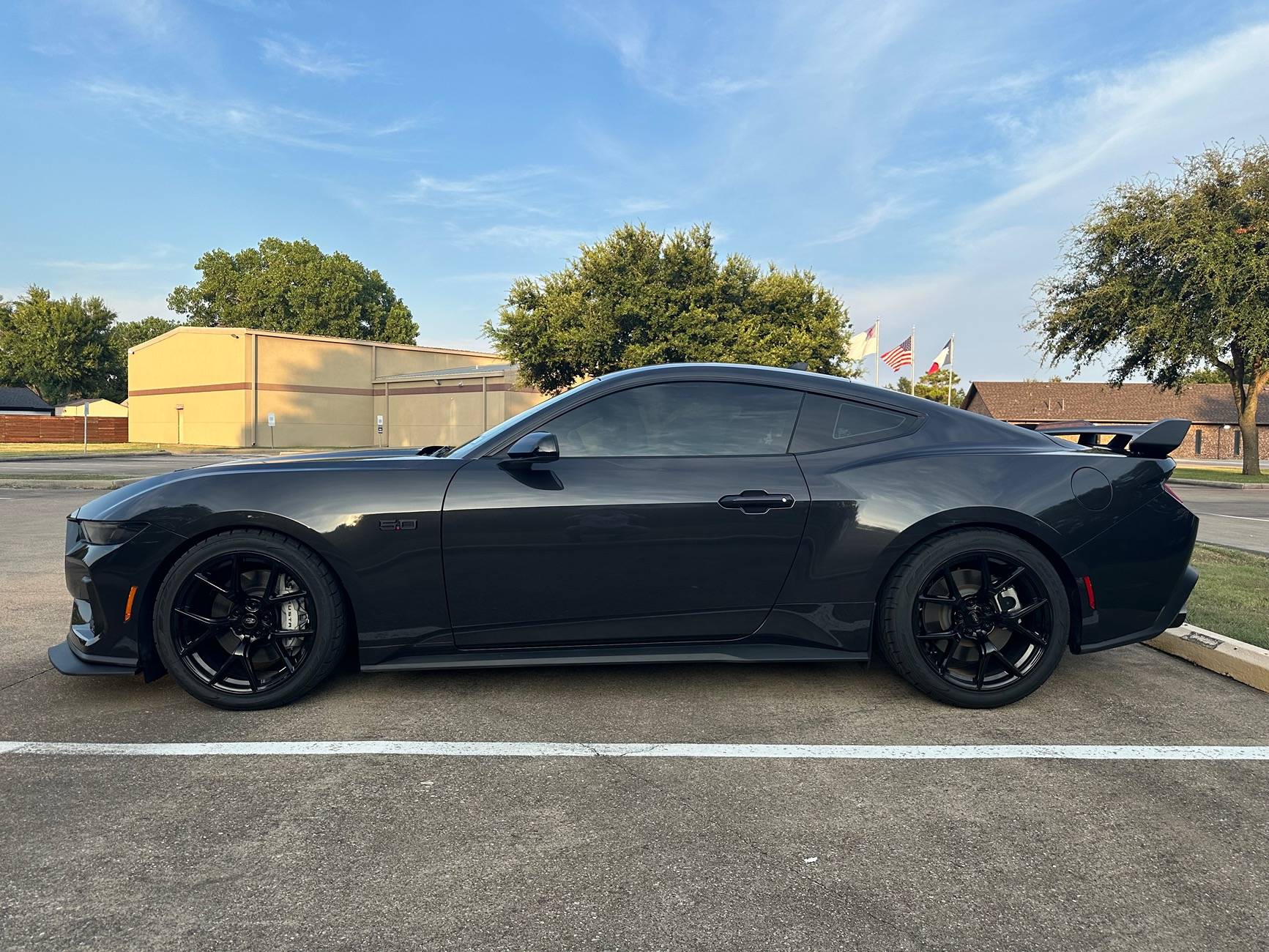

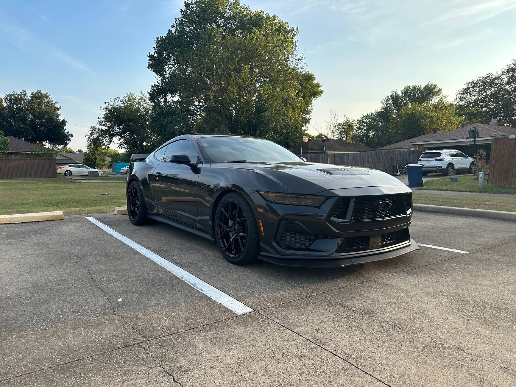

Looks šŸ”„.
Kind of prefer how this wing flows with the stance compared to the HP one you had before.
oh yeah I agree! Was able to trade my HP eBay wing with a little cash on top with someone that had a DH so it was a pretty hard to pass. Especially with the wing costing like 3-4K from ford šŸ˜… but appreciate it man!

FP track springs (M5300S65T) once the springs had fully settled compared to my original pictures posted.

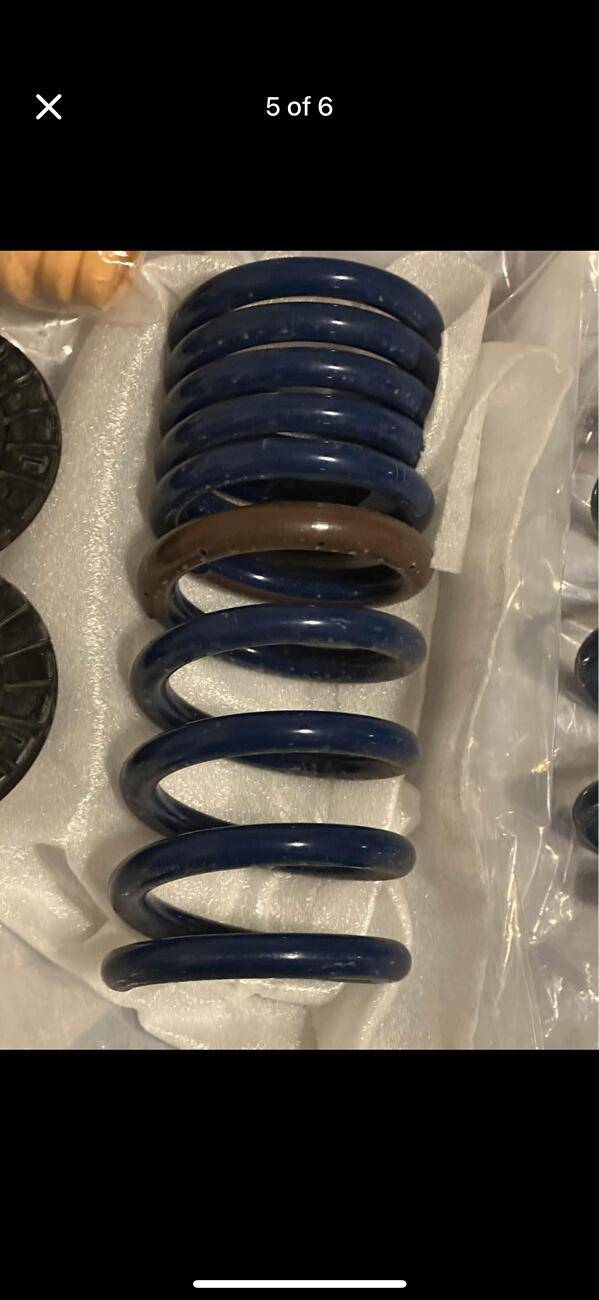

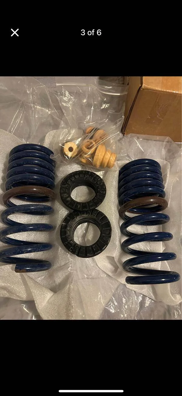

Yes I actually did with the track springs. I was able to get it fixed by buying coil spring sleeves and covering the ford and part number on the rear. After that no more noise. I put the link of what I used that worked.
https://a.co/d/c7jKr4K
I’m currently on the street springs and essentially it’s the same street springs as the S550 minus the upper insulators. But for those I didn’t have any clunking like I did with the track ones.
Just ordered the track springs. could not resist. can you sent some photos on where you installed the sleeves? Do you install those without taking apart the springs?

I installed the sleeves sometime after but didn’t need to take them apart. You could put them on once your springs arrive just to have it done beforehand.
I added pics of the springs from when I had them listed on marketplace. Pretty much will cover the ford part number and it’ll stop the clunking sound that myself and others have dealt with.
