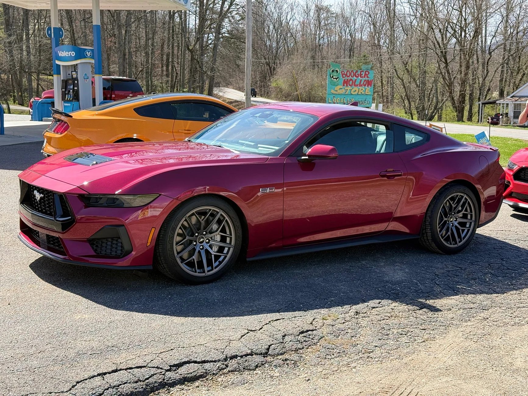

BEFORE lowering springs photo for reference talk about monster truck action.

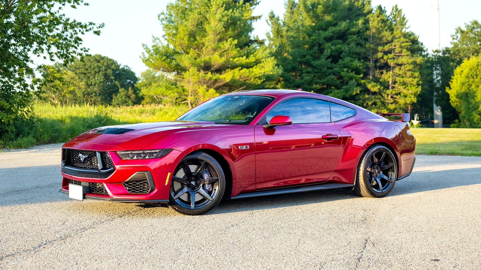

I did go with the Ford Performance Track kit. Love it and it’s definitely not too harsh. GTs should come with these factory
