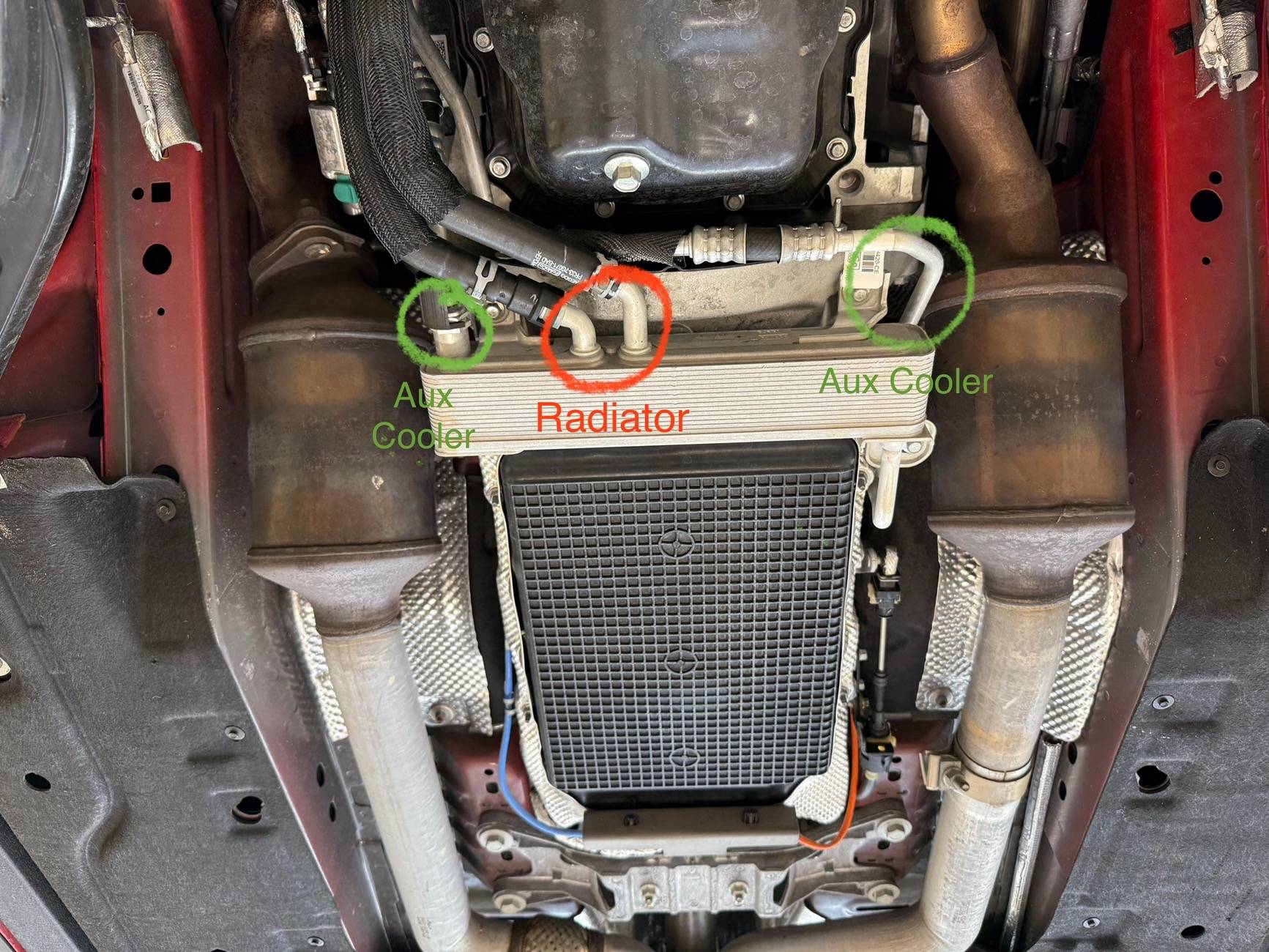

I will try to explain the setup as best I can after inspecting it on my PP. I will reference the photos below.
Photo 1: The transmission cooler is shown with green and red labels in front of the pan. This cooler is the part that is the same on the PP as the non-PP. On the PP the lines on the left and right labeled aux cooler run to the front of the car where the aux cooler is located. On non-PP cars the line on the right runs back into the cooler on the left side where it is labeled aux cooler.
The center two lines labeled radiator run to the radiator on both the PP and non-PP cars.

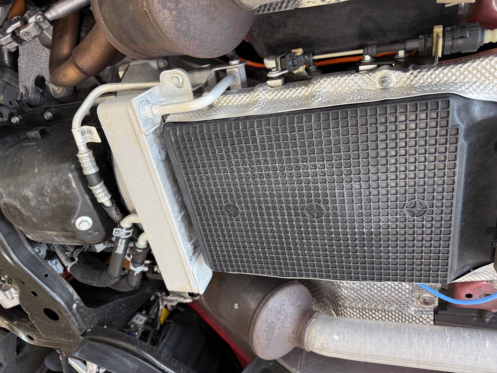

Photo 2: This shows where the two center lines running to the radiator are located right behind the radiator fan as well as the lines running to the auxiliary cooler.

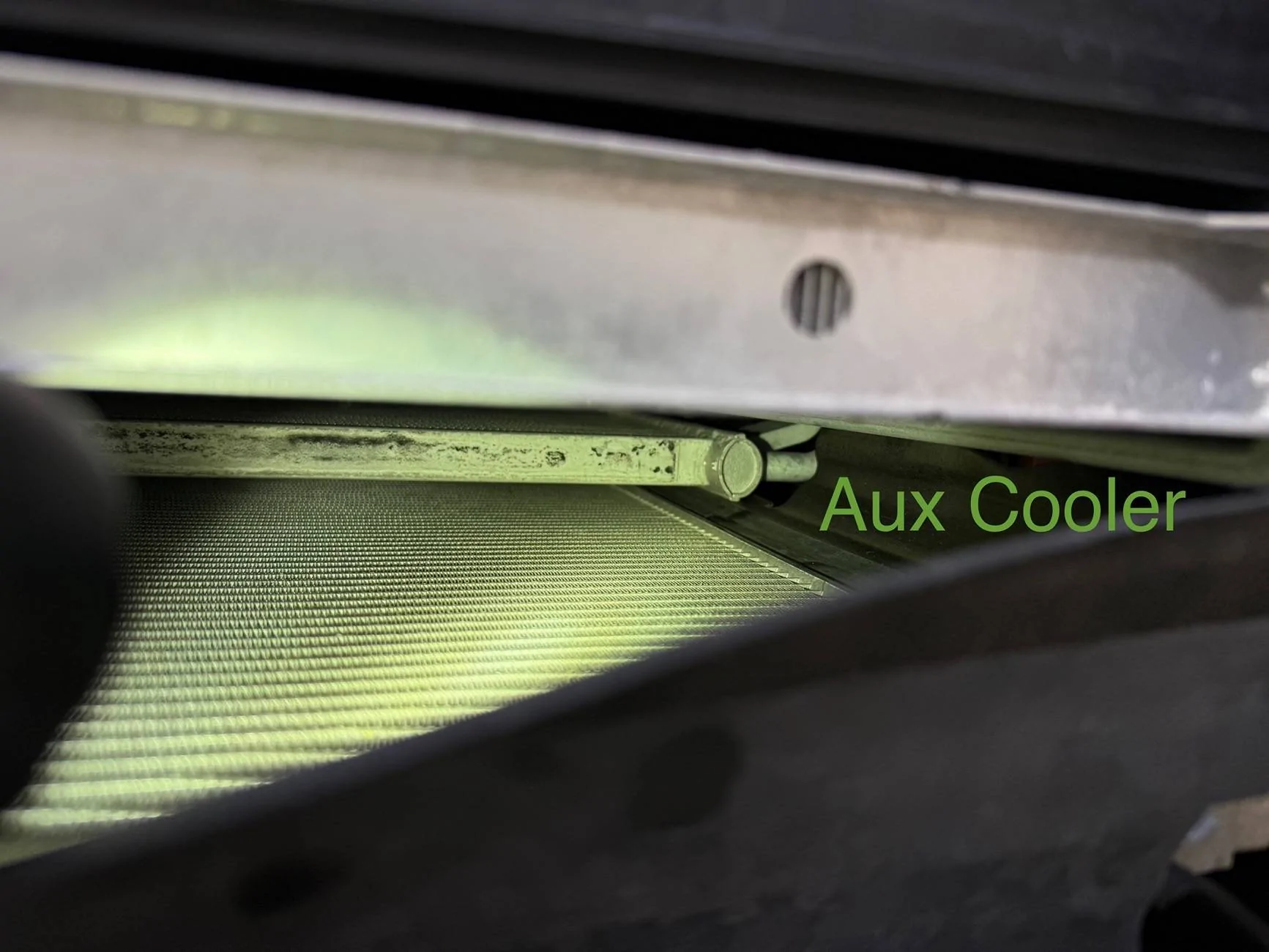

Photo 3: The auxiliary transmission cooler sandwiched between the radiator (rear) and a/c condenser (front).

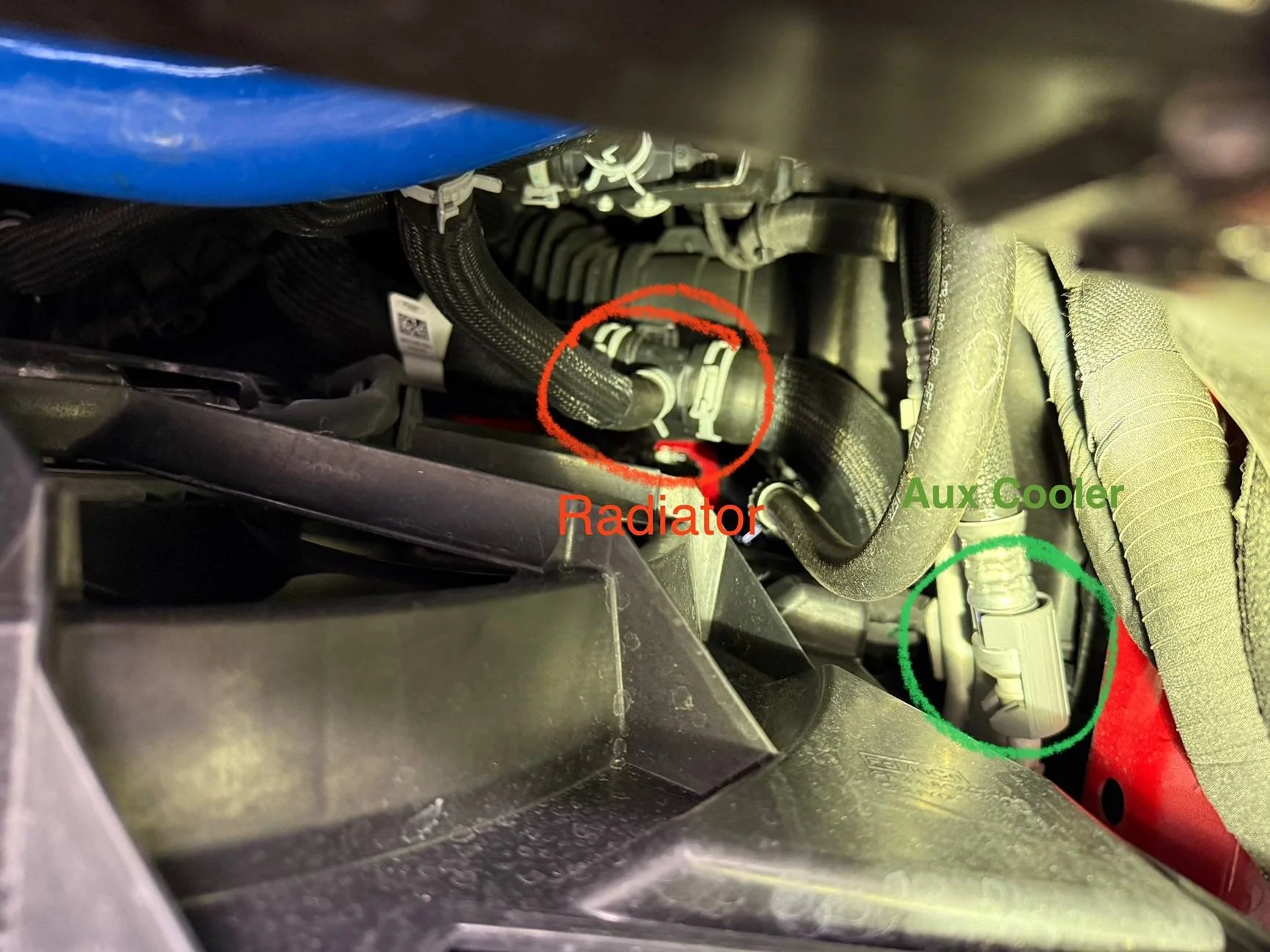

Photo 4: Driver’s side of the radiator where the cooling lines connect.
Hopefully that is helpful for someone. It was interesting to me if nothing else.
