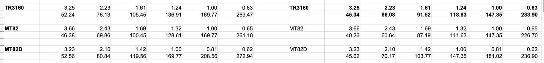

There's a couple threads on 4.09's on Mustang6G, it's a good fix for the D4 gearset...you don't want to shift 4 times to get to your 1:1 gear anyway, especially once you add some power

3.55 on the left, 4.09 on the right
27" tall tire, 7500RPM redline
Gear ratio is the first row, second row is MPH at redline
