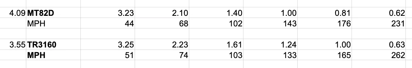

Is the gearing the same?
3,631
5,018
As mentioned the gear ratios are different, and the revmatch programming probably is too. Not sure what else.
Seem like a lot of work to do on a GT. Have you considered just trading for a DH?
