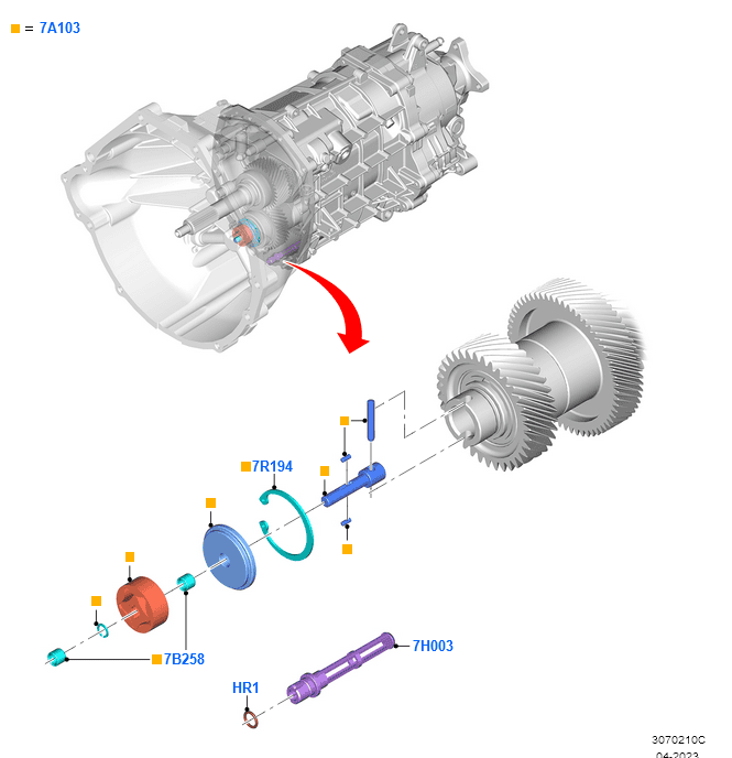

this is the TR3160's fluid pump assembly for the Dark Horse, GT350, and Mach 1. they all use the same parts

It looks to be driven off the counter shaft. Does it make sense for it to be louder in any given gear with its location? And agree HP/ non HP is of no consequence here just did not want to mis-represent my vehicle.
