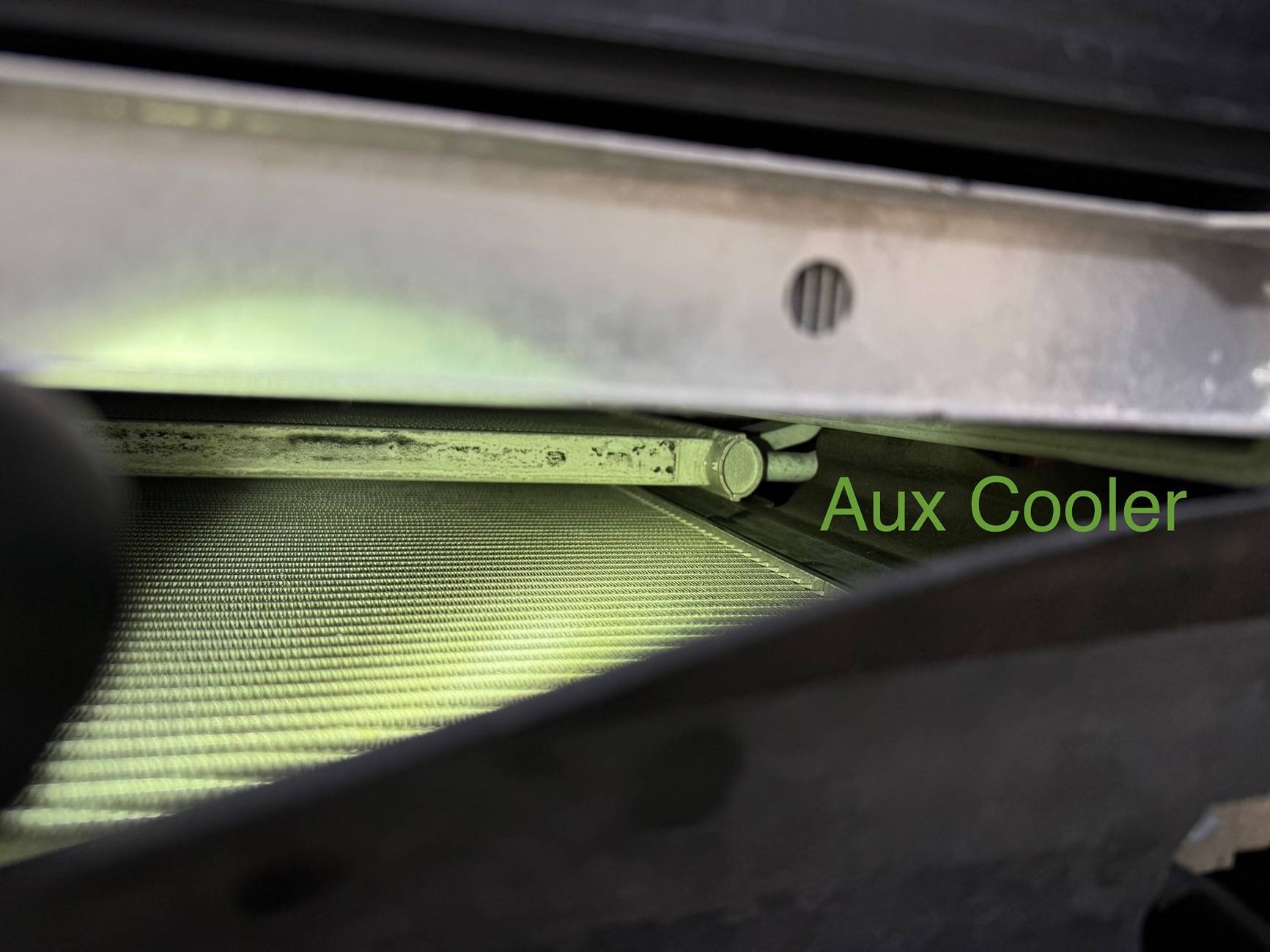

I will try to explain the setup as best I can after inspecting it on my PP. I will reference the photos below.
Photo 1: The transmission cooler is shown with green and red labels in front of the pan. This cooler is the part that is the same on the PP as the non-PP. On the PP the lines on the left and right labeled aux cooler run to the front of the car where the aux cooler is located. On non-PP cars the line on the right runs back into the cooler on the left side where it is labeled aux cooler.
The center two lines labeled radiator run to the radiator on both the PP and non-PP cars.
Photo 2: This shows where the two center lines running to the radiator are located right behind the radiator fan as well as the lines running to the auxiliary cooler.
Photo 3: The auxiliary transmission cooler sandwiched between the radiator (rear) and a/c condenser (front).
Photo 4: Driver’s side of the radiator where the cooling lines connect.
Hopefully that is helpful for someone. It was interesting to me if nothing else.

So the non pp could fit the aux cooler?
krisk
Jun 11, 2020
40
690
1,027
It looks like it could be possible, but it would definitely be a pain to install. It would definitely be easier with an aftermarket cooler mounted somewhere other than between the radiator and condenser.

@krisk ..... great pictures , very interesting. Thank you! Awesome beast! @TheGrabberBlueGT2024 ..... I agree with @krisk ..... would be very hard to install an aux oil cooler there. Much easier up front and likely more of a radiator function (air blowing through the fins) than a heat sink type tucked in the body cavity. You could run sone ss braided hose, even if you had to have it custom made, that would not be that expensive.
MAT1955
Sep 1, 2024
1,061
1,501
K6V4T5
@krisk and @TheGrabberBlueGT2024 Blue .....was discussing this with a friend who owns a 2024GT. He asked, " Doesn't the DH have an auxiliary cooler behind its lower front grille? That area of the grille seems to have OEM open slots to let the air blow through when underway. Couldn't 1/2 or 3/4 inch holes be drilled through it and the aux cooler mounted behind the grille in that area.?"

Thanks for the pics. So essentially there is an aux cool in front of the radiator in the PP.
To the OP - I could see that being helpful on the track. But im still not convinced it would significantly lower temps in stop and go traffic. Id think you'd need consistant airflow to get real cooling benefits.
