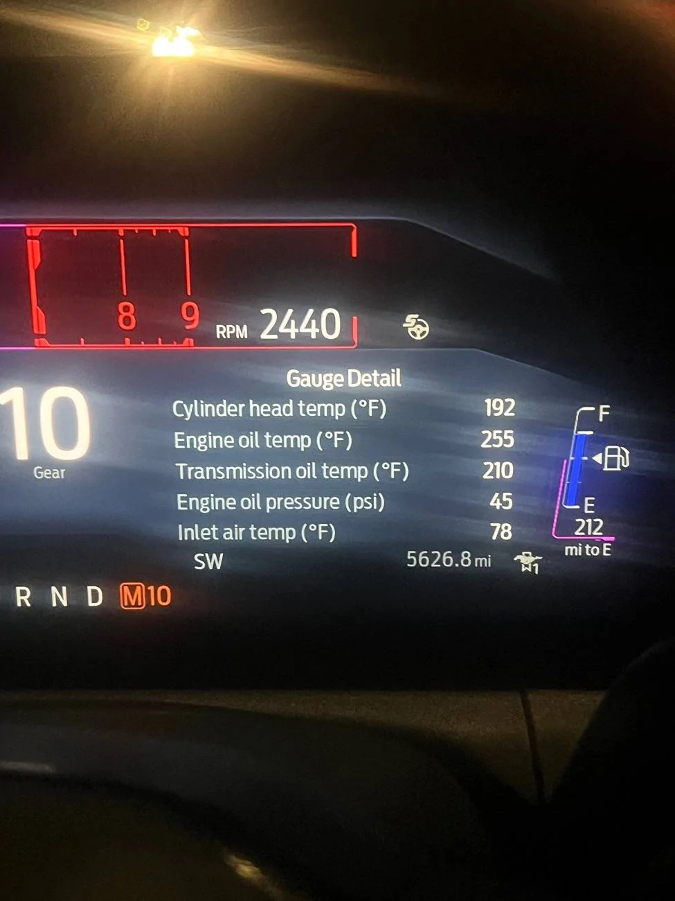

I don’t know how to explain what the car is doing I will try the best I can. I did a pull from about 85mph foot down using paddles and the car accelerated good like it always does. I don’t have the exact number but it was like 135-137mph the car briefly stopped accelerating. Then it acts like nothing happened and will continue pulling I took photos of the temps. This isn’t the first time it has happened anytime I attempt a high speed run it does the same thing. Is there a fuel cutoff or something? That’s about what I would describe it as. It’s like everything just sorta “stops”. The attached photo is afterwards when it started cooling down. The engine oil temp did hit 260.

Man, you really are driving your car hard. I sure hope its been broken in properly. So whats the complaint here? Trans temp, oil, temp, or hesitation above 135 mph? You're kinda all over the place here. Can I respectfully ask what you are using the car for?

My guess is that's RPM/paddle shift related. Probably a built in fail safe to keep you from breaking your transmission. Why are you using Paddles during high speed runs?
