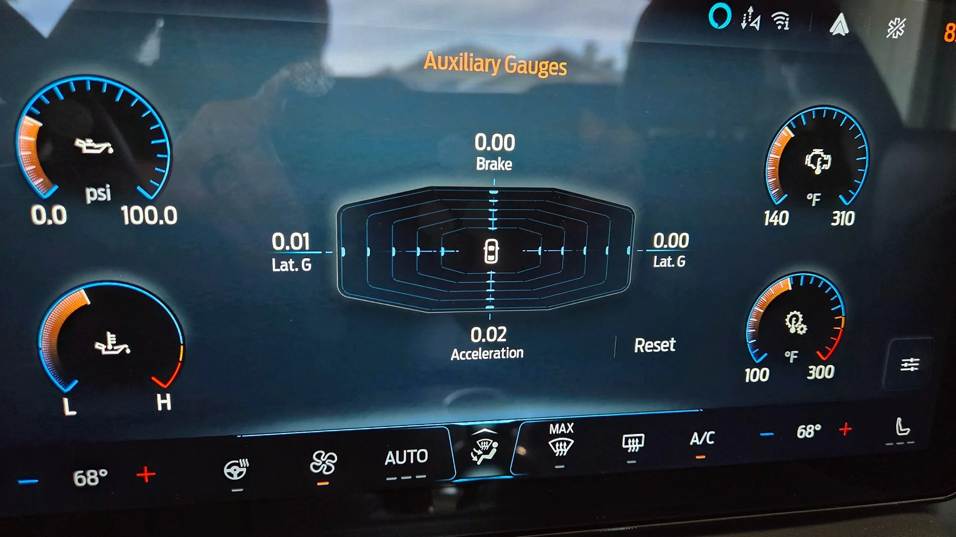

You personal guidlines? Based on what data? If you look at your track gauges Ford allows for higher tolerances. At least for oil and trans.

Honestly 240 oil temp is not even bad, usually for these engines you should start backing off once you reach 280 F (yellow zone on the track gauges). 225 for transmission is about right, operating range is about 206-215 I personally wouldn’t go above 220. Can’t say much for your CHTs, aluminum heads warp around 260 so do what you will with that. Overheating shouldn’t even be a big worry cause afaik the car will enter limp mode once it sees the temps are too high.

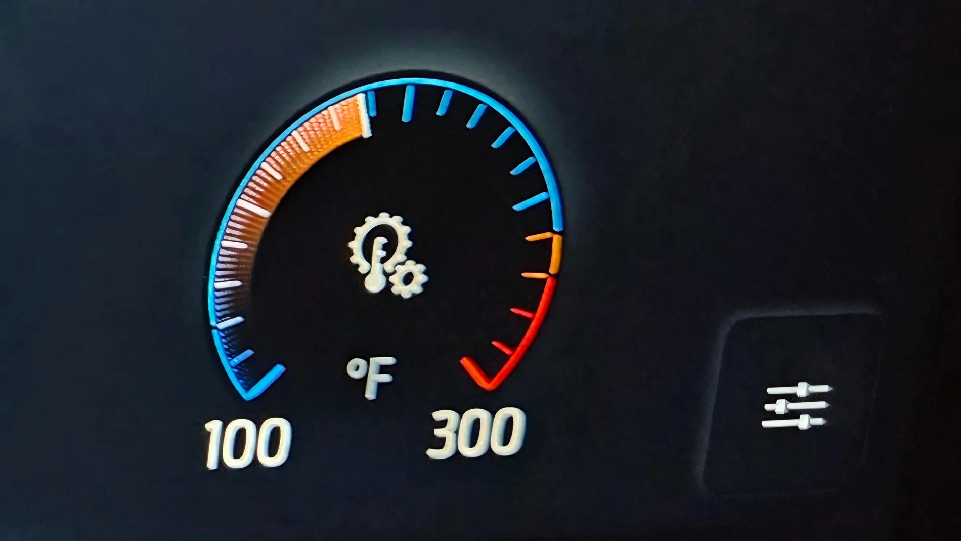

Exactly. The track guages say 265⁰ is yellow and 280⁰ is red for oil temp. 240⁰ wouldnt worry me. I hit that doing some spirited driving on the back road twisties over the weekend. Trans guages say 260⁰ is yellow and 270⁰ is red. I stayed in the low 220⁰s during my spirited driving. I dont think Ive ever seen my cylinder head temp over 210. Who knows what the limit is on that, but I know the computer will activate limp mode if the car is close to overheating.

Ford seems to think 260⁰ is high. 🤷🏻
