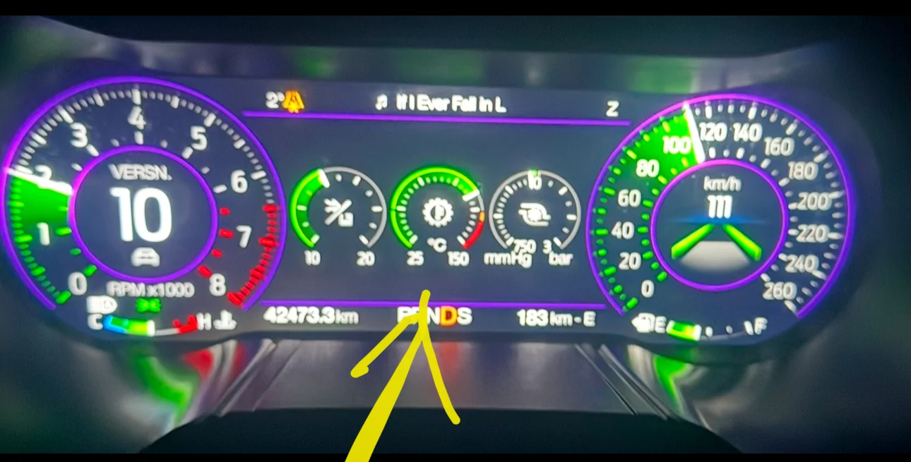

S650 Mustang (DONE) Adding the Performance Package Trans cooler to a non-PP car IMG_1017
In my case the 10 speed transmission had to be replaced due to high temps, i hope a better diagnosis for you

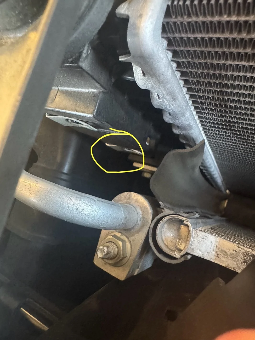

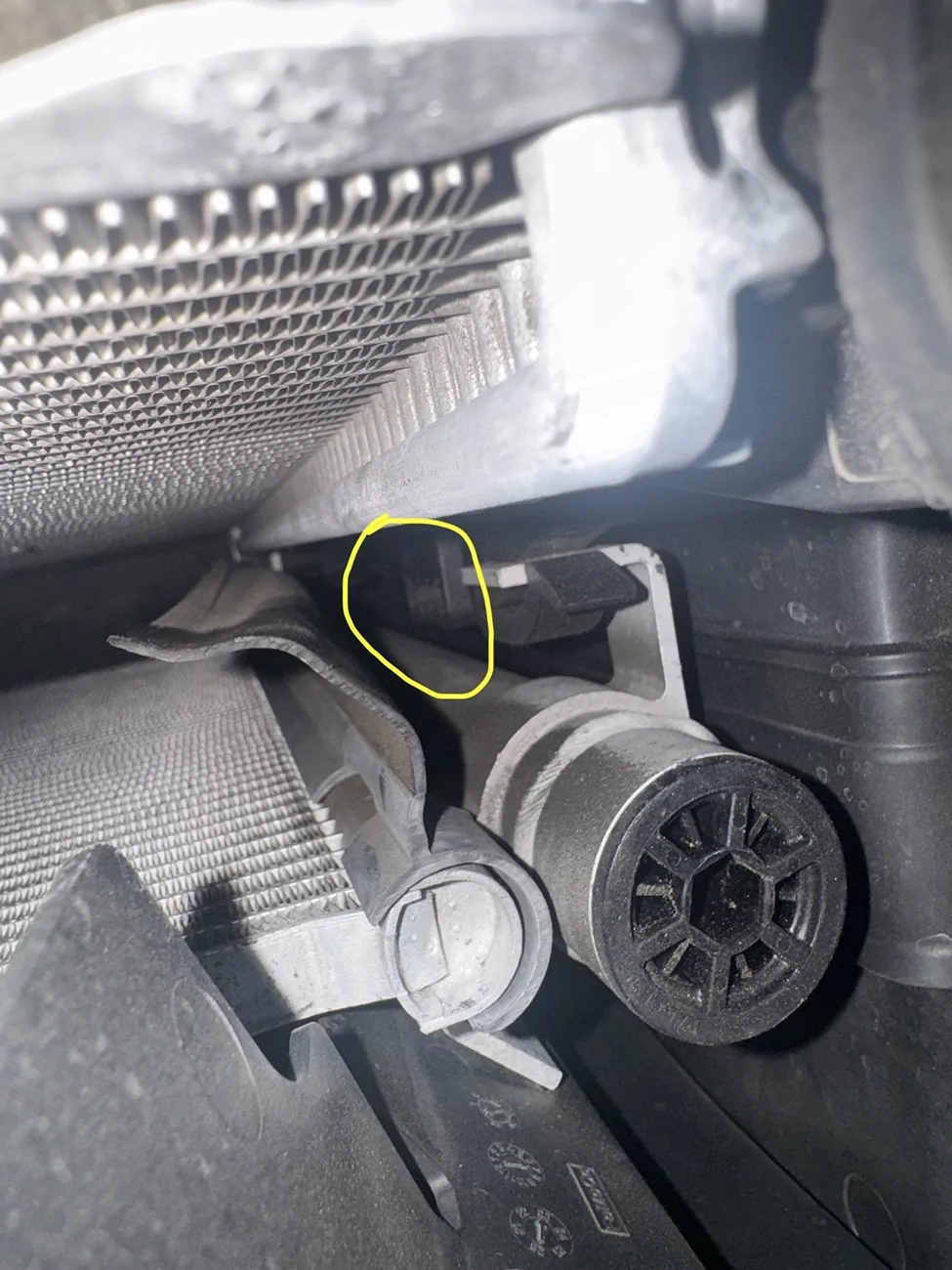

Alright I just took off my Radiator cover and it does seem like the Transmission cooler will fit, albeit a tight squeeze you should be able to get the bolt tightened without removing anything, I’ll attach some photos now.
S650 Mustang (DONE) Adding the Performance Package Trans cooler to a non-PP car IMG_7422
Yellow circle here is where the cooler will bolt into place, I do think that rubber to the right of it could cause interference but it seems pretty easy to cut.
S650 Mustang (DONE) Adding the Performance Package Trans cooler to a non-PP car IMG_7424
This yellow circle shows where the cooler bracket slides into position to keep itself up on the radiator, same rubber peice still there

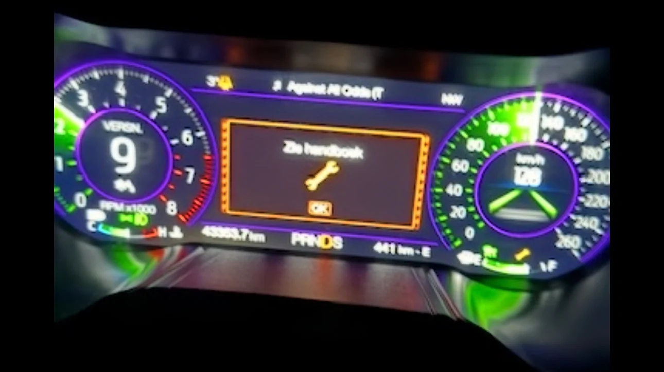

During a relaxed longer trip (130km/h) the gearbox temp kept increasing, had to reduce the speed till about 90/100Km/h. Al of a sudden the 10th gear was not usable anymore and wrench annunciator (DTC P07F7) come on. Had to wait half hour at a rest place to reset. Dealer replaced the gearbox under warranty. And yes, this was a 2019 Ecoboost.
S650 Mustang (DONE) Adding the Performance Package Trans cooler to a non-PP car IMG_3889

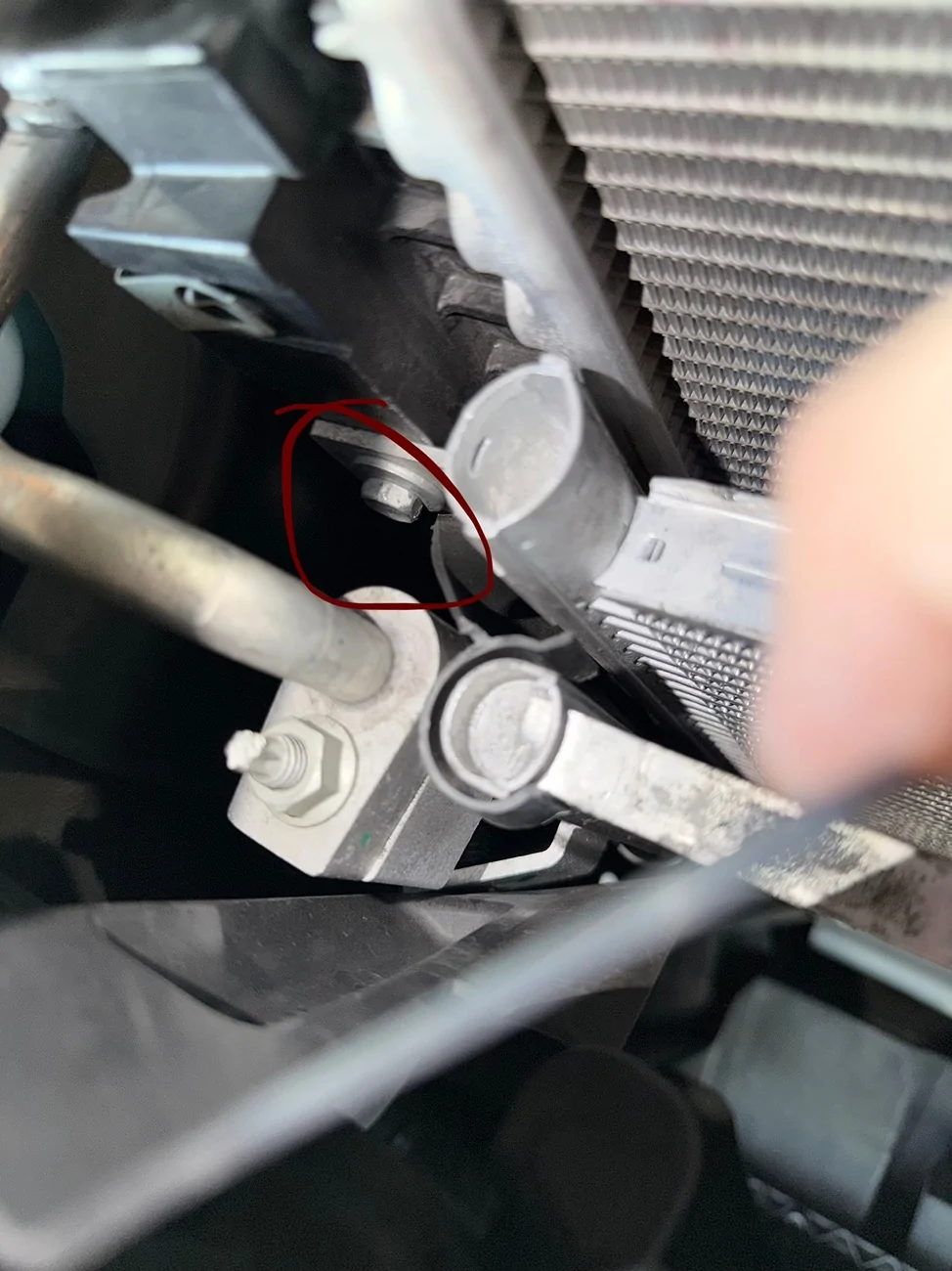

Progress Report #1, Sorry guys! I’ve been off for a while now, but the trans cooler is in place! Was quite a struggle and I had the fight the radiator and AC condenser a bit but after some elbow grease and time I got it in and bolted up. I’ll show some photos now.
Photo 1:
S650 Mustang (DONE) Adding the Performance Package Trans cooler to a non-PP car IMG_7653
Took off the radiator cover, on the top near the intakes is the radiator, in the bottom near the bumper is the AC condenser, and between the two is the transmission cooler, a tight fit but I was able to get it in (removing AC condenser would make install easier)
S650 Mustang (DONE) Adding the Performance Package Trans cooler to a non-PP car IMG_7660
circled in red is the bolt holding on the cooler, it’s a single 10mm bolt (all part numbers can be found in the doc I linked at the beginning of the thread).
All in all the install wasn’t too bad, you need to remove radiator mounts and passenger intakes to fit the cooler.
In the time I’ve been gone I’ve gone around searching videos and photos of the bottom side of the trans cooler set up. After some better photos and diagrams from Ford I have been able to match common parts and remove them from the required parts list. I’ll try to get the cooler installed in the coming months. AFAIK, the most difficult part of the install is done, the rest is just bolt ons and replacing a fluid line. Any photos of the trans cooler setup from the bottom from anyone with a PP or DH car would be greatly appreciated!

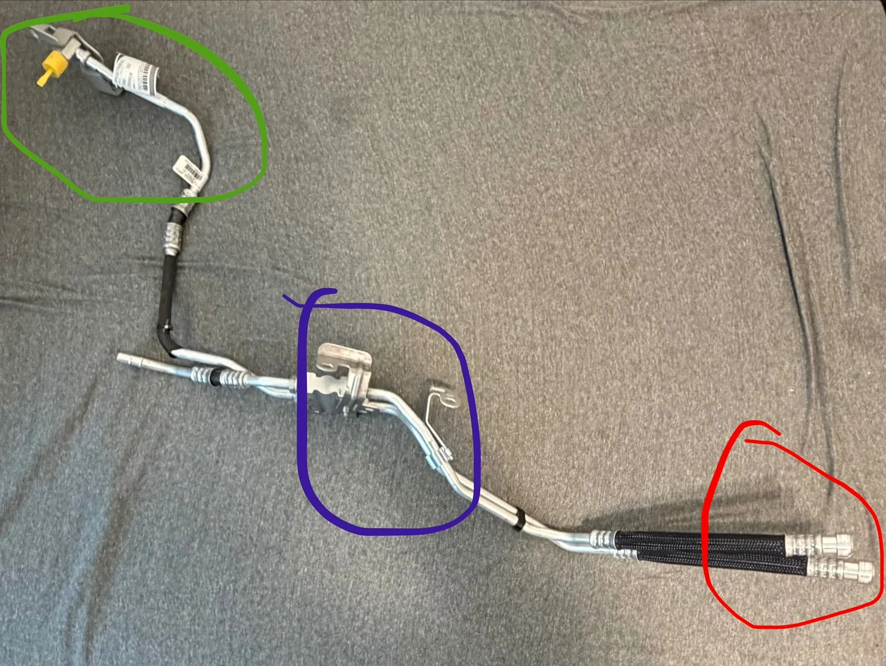

Progress Report #3, I’ve picked up the transmission cooler lines, retaining clips, and bracket bolts. After a bit more analyzing I’ve gotten an idea of how I will put the line in place.
S650 Mustang (DONE) Adding the Performance Package Trans cooler to a non-PP car IMG_7689
Red Circle: Flexible connections, get connected to the heat exchanger at the front of the car
Blue Circle: Thermostat, controls the flow of fluid to the heat exchanger, this part bolts onto the passenger engine mount bracket studs
Green Circle: This part connects to the transmission, and replaces the 7A031 line as seen in the non-PP diagram on my doc.
My gameplan:
1. Start at the bottom, and snake the heat exchanger connections to the top and bolt the thermostat on using the two HN1 bolts in the PP diagram
2. (Keep a few rags to plug the open transmission ports) Since these lines are somewhat flexible we can replace the line connections 1 by 1. Remove the 7Z465 retaining clip, remove the old connection and put in the new connection, and reinstall the 7Z465 Retaining Clip
3. Remove the 2 HB2 bolts holding the other side of the 7A031 line in and remove and replace with the new line connection, reuse the HB2 bolts to bolt on the connection. Step 2 and 3 can be done in any order I don’t think that it matters much.
4. Get back at the top, to access the heat exchanger connections the passenger intake and radiator cover must be removed, plug in the connections and use the two extra 7Z465 retaining clips that you bought to connect them.
5. AFAIK that’s it, turn on the car and check for leaks, if no leaks then celebrate, if there are leaks then do something ig.
