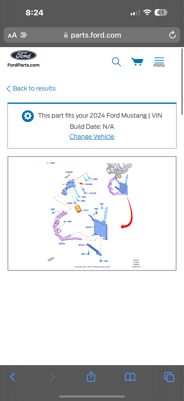

Was curious about everyone’s thoughts on this and if it’s possible to add the performance pack oil cooler on the non performance pack cars. Just doing highway cruising oil temp around 230. After some spirited pulls temps get up to 260s and I’ve even seen 270s once which is way to high. Looks like it would be around $1500 give or take to add the OEM PP oil cooler.

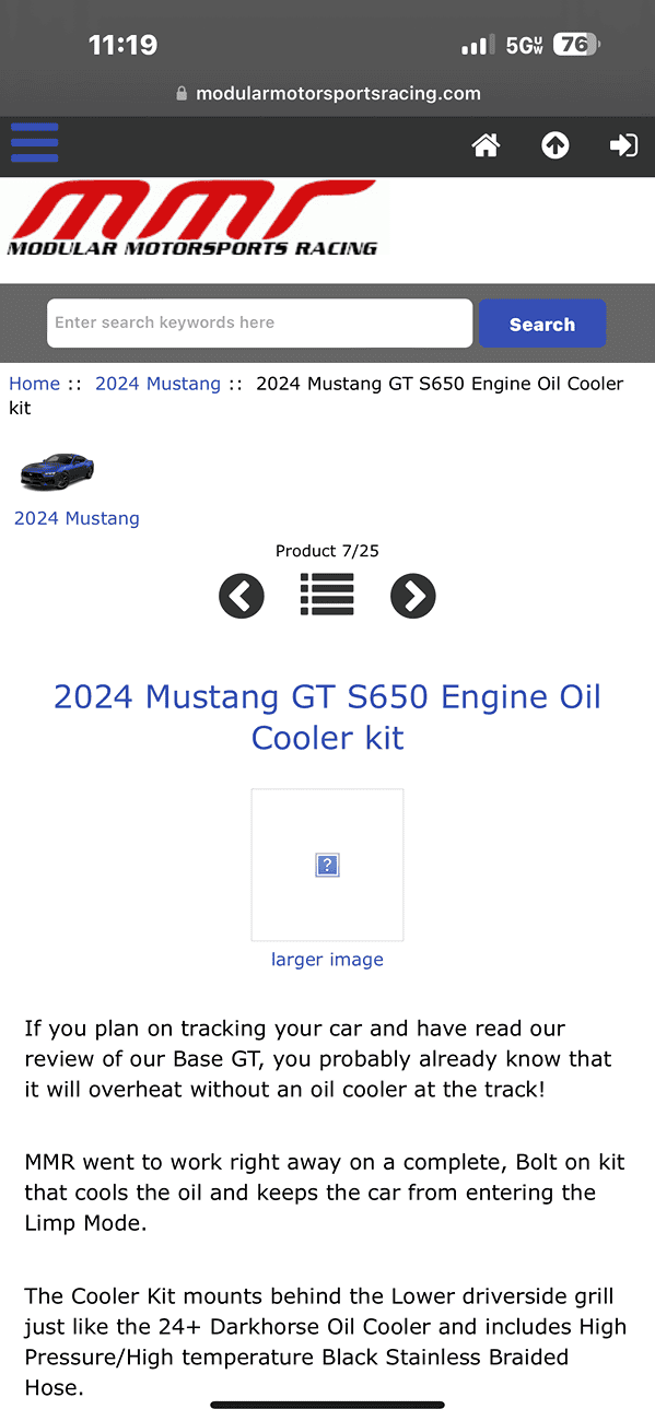

I see MMR has an oil cooler that mounts like OEM for $500 but no info or specs on it yet.
Would it be possible to add the OEM cooler to non pp cars? I don’t think the ecu is tuned differently for PP cars

Does the kit include a lower driver side grille? On performance package cars that grille is open, but I believe on non performance the grille is blocked off just like on the passenger side. If it is open then the cooler won't be getting any air flow.

Correct on the non-performance pack cars it is blocked off but you could take that backing plate off. I’m pretty sure it’s removable. Also on the performance pack cars the fender liner has openings. You could spend the money and get a new fender liner or just cut splits into the existing one, which I’d probably do.

Yes I guess they do also have a bigger radiator. I wonder how much the oil cooler would help without the bigger radiator.

I couldn't find any info on that, 650 hasn't been out long enough to see this tested. It would have to help, I'm just not concerned enough to drop $800 or $1500 on a cooler, unless I run into overheating issues. As a daily driver, with some spirited driving, 230-240 is still within a healthy range.
