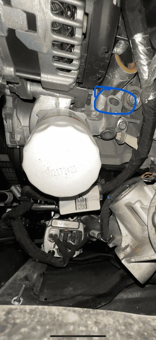

I agree I don’t see it get past 240-250 very much. I was looking around and it looks like the NON PP have an Engine Intake Manifold Runner Solenoid on the oil filter adapter and the PP oil filter adapter doesn’t have that.
Thank you for pointing that out. I was looking into getting the PP oil cooler as well. Glad I didn't pull the trigger. I would imagine you could still go with it but also need to do the IMRC delete.

I was doing the research and you can 100% add on a PP oil cooler to the non PP
I've had some back and forth with MMR about their cooler. Apparently they are just waiting on brackets and then they can sell the kits.
I actually got Under my car and looked at the oil adapter and I don’t have the imrc Solenoid so I’m almost positive that the performance pack Oil cooler is a direct bolt on and would 100% work. The only reason why I said that that solenoid was there was because of the diagram on the parts site. The blue Circle is where it should be and it’s not there the sensor above it is the oil pressure sender
I got under my car and confirmed mine is the same as yours. This is good news.

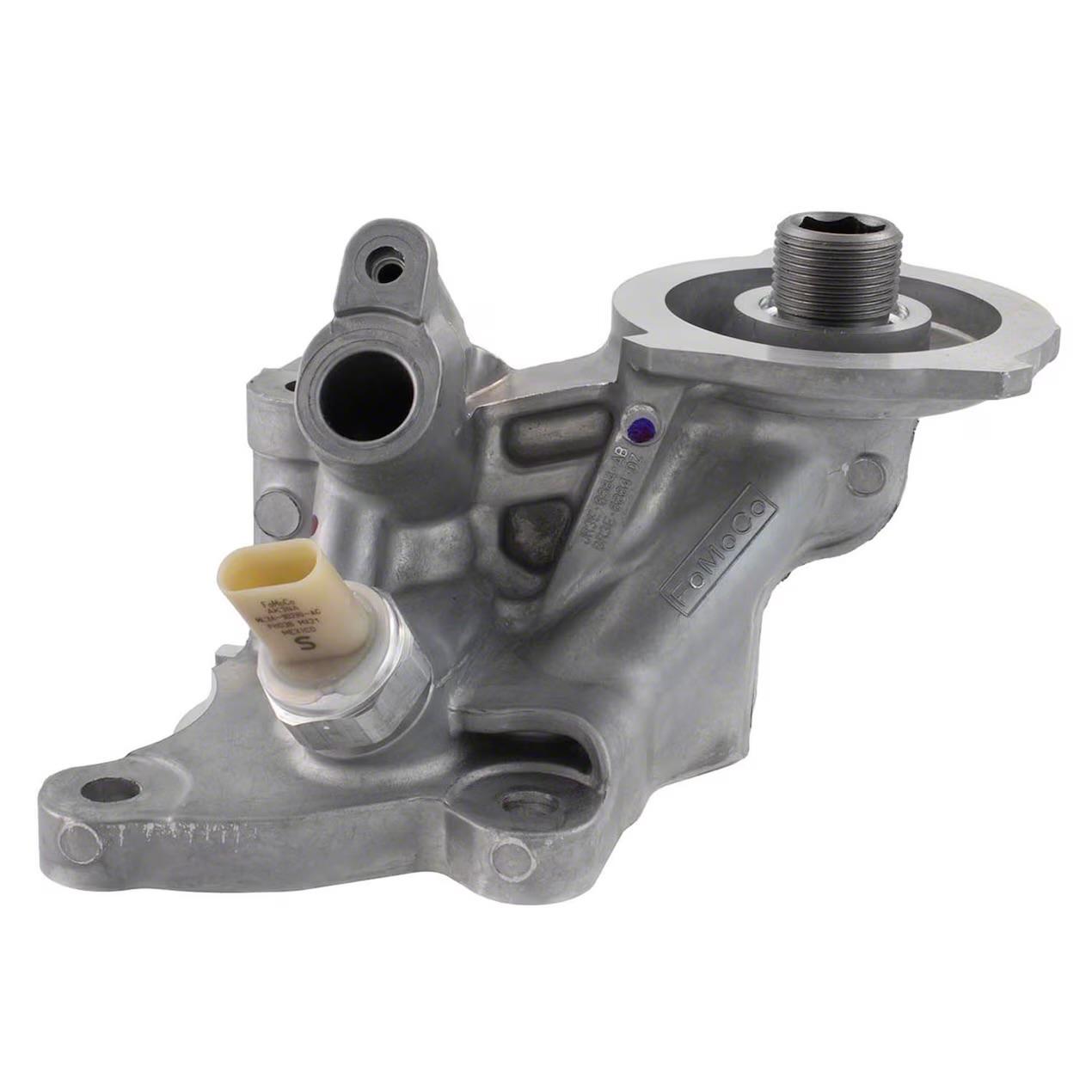

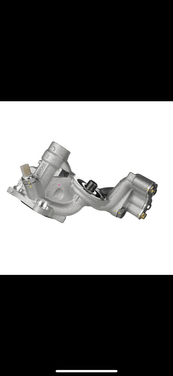

After seeing my oil temp on my base GT go to 230 in 70 degree weather (driving steadily around 80 on the freeway) … I took a deeper look.
There are two part numbers for the ā€œadaptor oil filterā€œ :
Performance pack - PR3Z6881C ($933)
Less performance pack - PR3Z6881B ($287)
They are very different. The less PP adaptor leaves the filter kind of protruding out. The PP adaptor has the filter sandwiched between the housing of the adapter.
