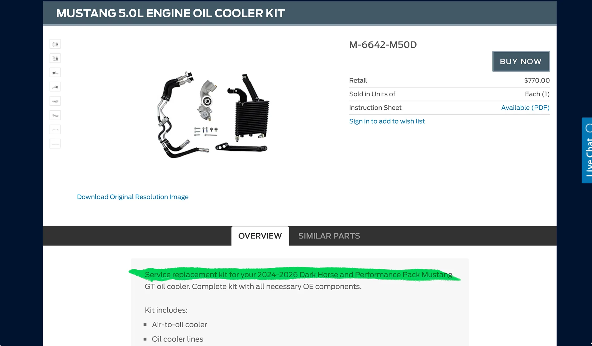

Silly question stupid post but none of the listings on the window sticker or websites list the oil cooler as included in the PP. Believe it or not I don't care about a stitched center console lid or a rear spoiler

Well, I usually say to check the order guide to see what's included... but it only lists oil coolers for the Darkhorse... I'm pretty sure the GT PP has the oil cooler?

I don't have time to look up the list of everything that is included in the Performance Pack, but yes, an oil cooler is included.

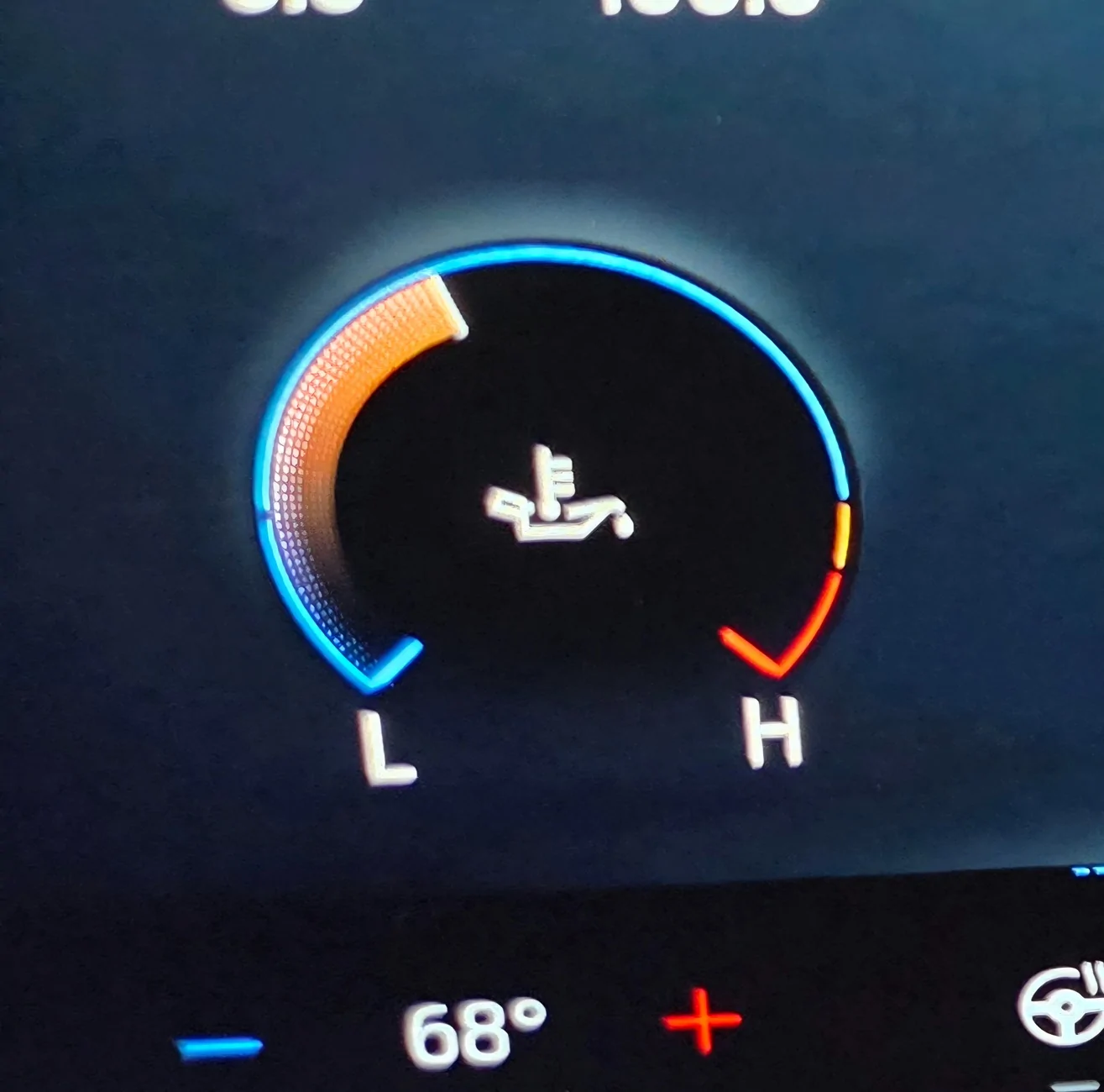

Well since the car doesn't use an oil temp sensor it will not recognize the oil cooler and still limp the car based on its incorrect data even when unnecessary. There are ppl who have made adjustments with the fans etc to correct but still
3,876
5,464
You can get a tune so it will recognize the new temp with the cooler.
And for the record, ive only heard of one person on here going into limp mode due to oil temps. And he was beating the shit out of the car doing a half dozen WOT pulls in quick succession without letting it cool. Most cars would have an issue doing that.
According to Ford, the gauge says 280⁰ is considered "hot". Ive never been over 240⁰ and I live in Phoenix and drive "spirited".
