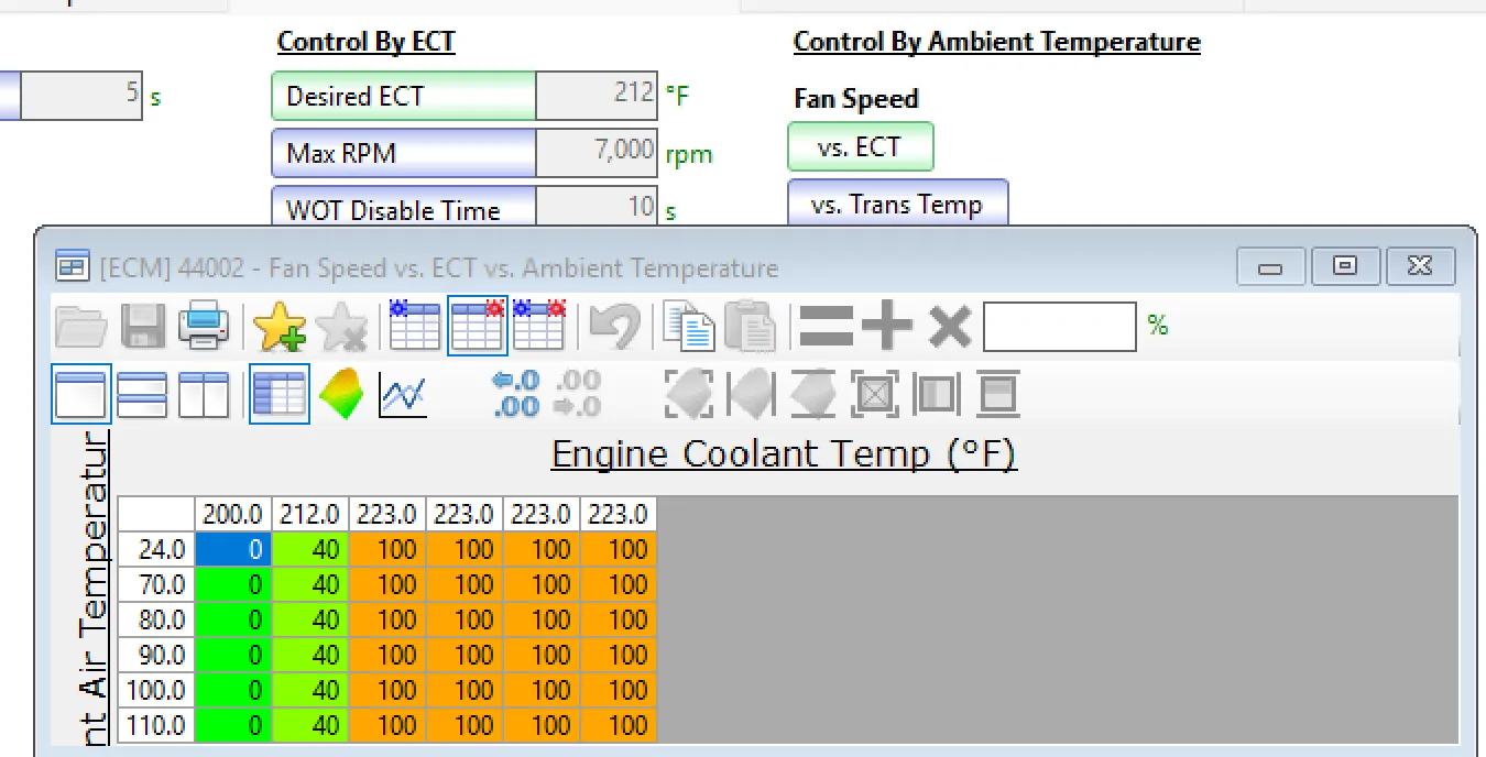

Also this is the pathetic state of your rad fan scheduling. Yes thats 40% only at 212 and thats what Ford wants the car to sit at. There is no need for a t-stat anymore, I can just rescale that table and bring down the temps and push the fans faster, earlier. This alone makes a massive difference.

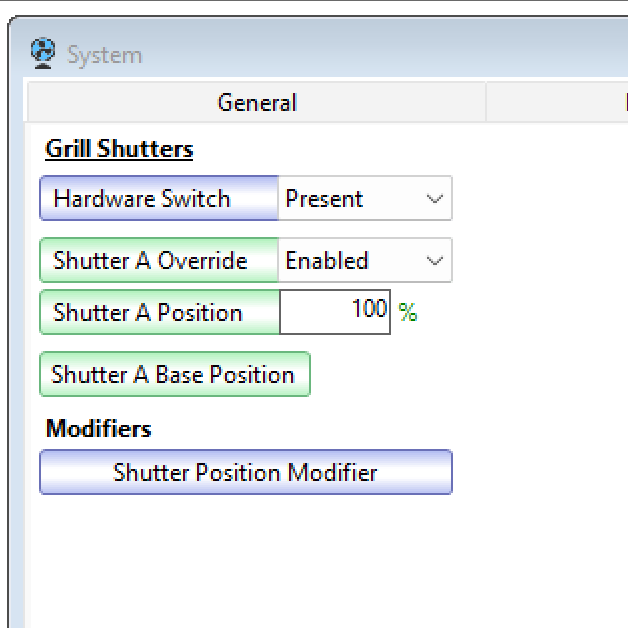

AND, next fun fact you can also hard set the grille shutters to stay open 100%% of the time and that will also really help. When you are not running the AC, they stay close or partially closed more than when the AC is on. Its that way on a lot of ford vehicles. My F150 EB gets to 212+ with no AC on and when the ACs on, it sits at 187ish even in 90f+ temps because both sets of shutters are open all the way with AC demand... When those grille shutters are full open, you dont even need the oil coolers. Everything stays like 15f cooler at least.
**Note on the grille shutters, thats not recommended for winter driving. You need those to regulate that ice cold air to let the car get to normal operating temps. Here in FL where I live, thats no concern, but for my more northern customers I let them know if they are going to drive in sub zero temps, let me know so I can change those settings back to stock so the car has a fighting chance to get to operating temps.

If I’m understanding you correctly, since I have the MPVI4 and VCM Editor Suit, I should be able to change the values myself to reflect a PP/DH without paying a tuner?
Yes as long as you have the 4 credits already for your device for that car.

At what air temp and ECT did you change your fan speed and to what percentage? 100% at 212 ECT?

Thoughts on leaving Desire ECT at 212 or changing it to 197? I think I'm going to leave mine at 212, just have the fans come on earlier.
shouldnt hurt anything. Just make sure if you have grille shutters you set them to open earlier or force them open all the time. You need them open 100% if you are going to run the fans 100% as well. Dont want them pulling on a closed inlet.

Absolutely. Hadn’t gotten that far yet, just making notes first before I start the process.
