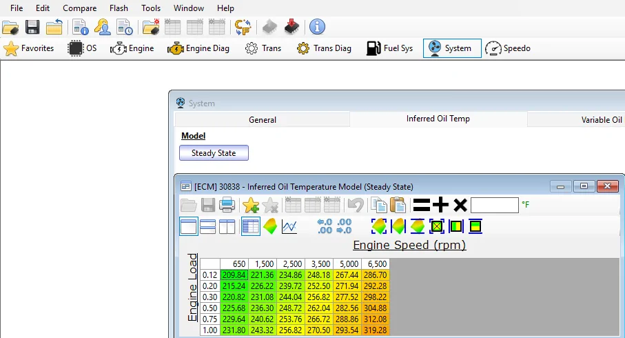

Also, just to spread around knowledge, there is a tab for this in VCM Editor Beta. You just have to change the tables. Could probably use the tables from a stock PP Mustang's restore file. Not 100% sure, just wanted to make sure you guys knew.

What kind of temps are you seeing on the dash? I purchased the MPVI4, 4 credits, and downloaded the HPTuner software. Wanted to get a look at to see if this is something i can figure out. Is the table your stock file or is it the updated tune from PBD?

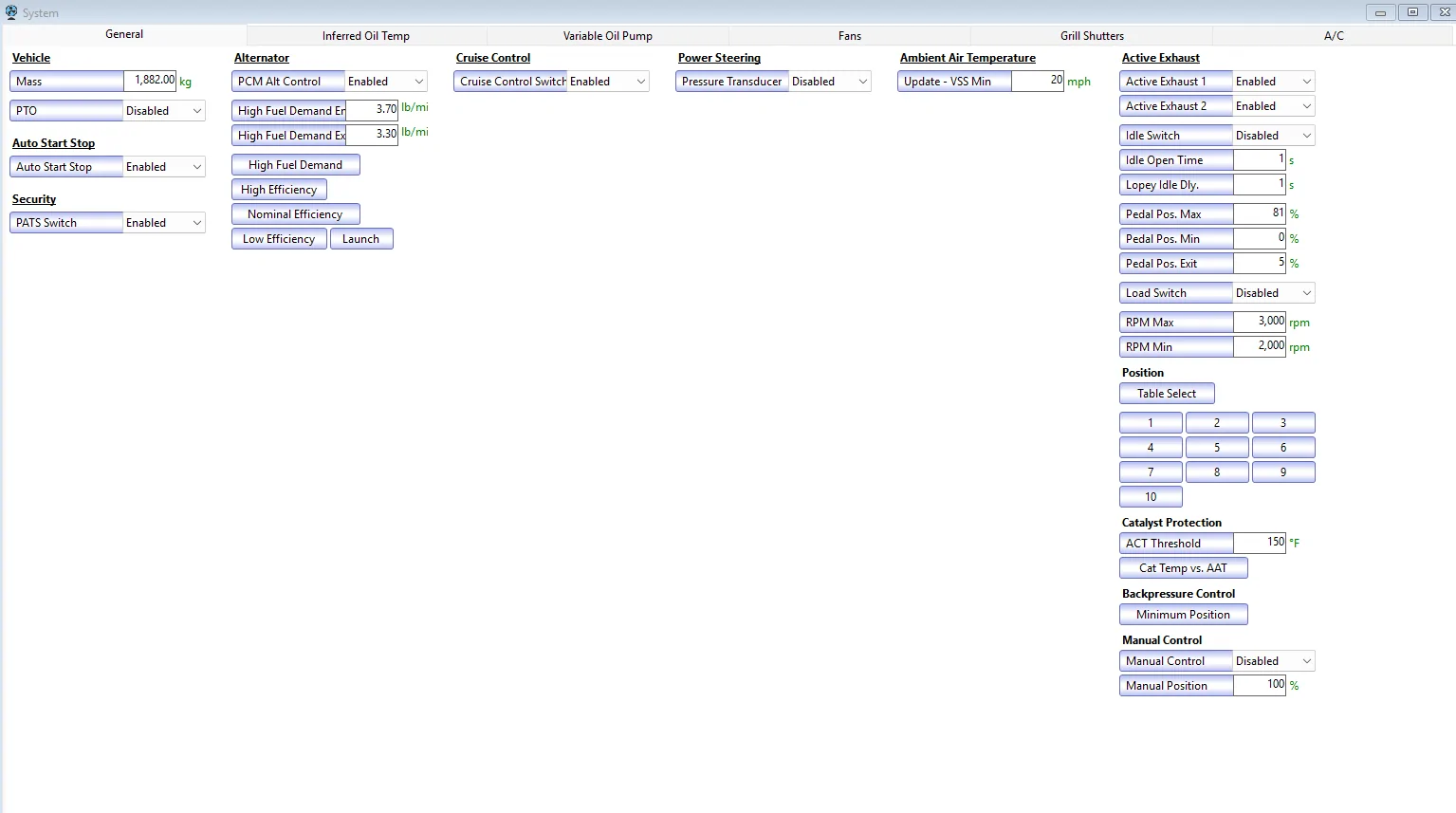

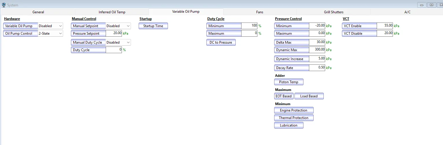

Can you give me a snapshot of the "General" and "Variable Oil" tab?

This is from my stock file. Personally, I was just thinking of using a restore file from someone with a PP and putting that in there since the oil cooler comes stock with them.

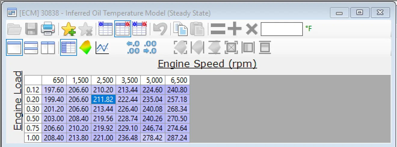

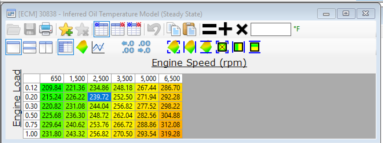

Here is the non PP inferred data and the PP/DH data. Easy change
Interesting.... Has this been available the whole time tuning has been released? It seems like folks who have asked tuners (up until this last week) and some tuners themselves (via published social media posts) didn't realize this...
Yeah hiding in plain sight. In all fairness HPT releases updates to VCM editor and slips in new tables and data we can change from time to time. But I believe this has been in since day one.
