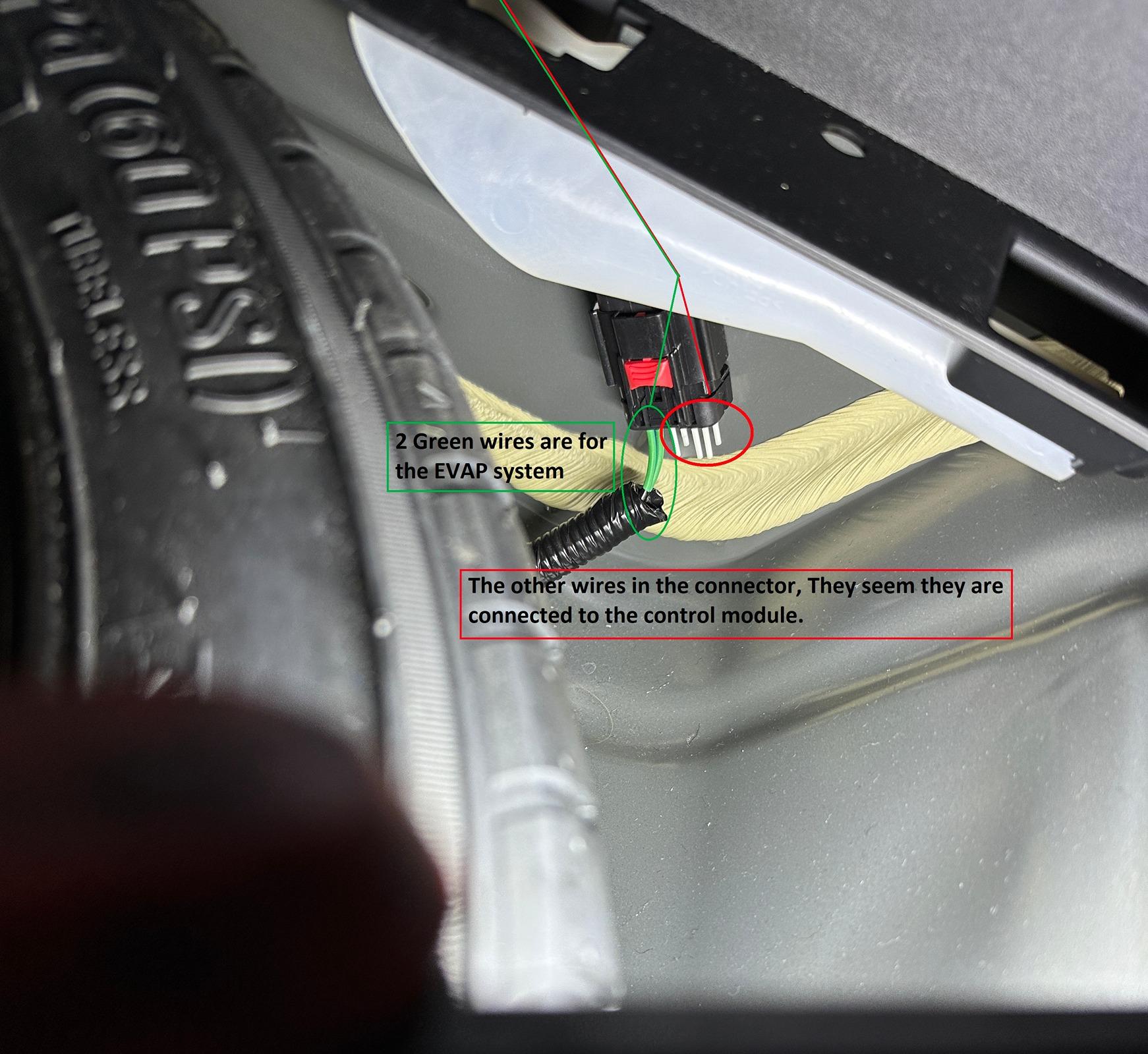

Seem all non-active models have a connector for the evap system and active exhaust. Just non-ae model got a different harness that only connects to the evap. See the attached for details.
Theoretically, we can get the factory active exhaust features(I don't know how to add remote rev to EB model since mine is GT) if you connect some wiring harnesses, actuators and active exhaust system and re-program to add an active exhaust.

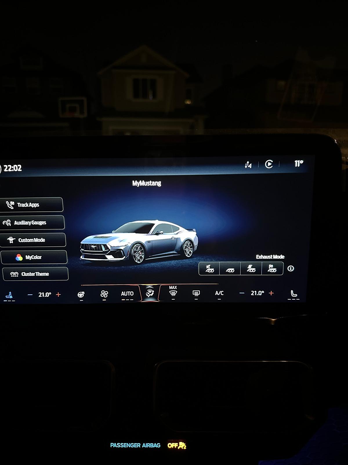

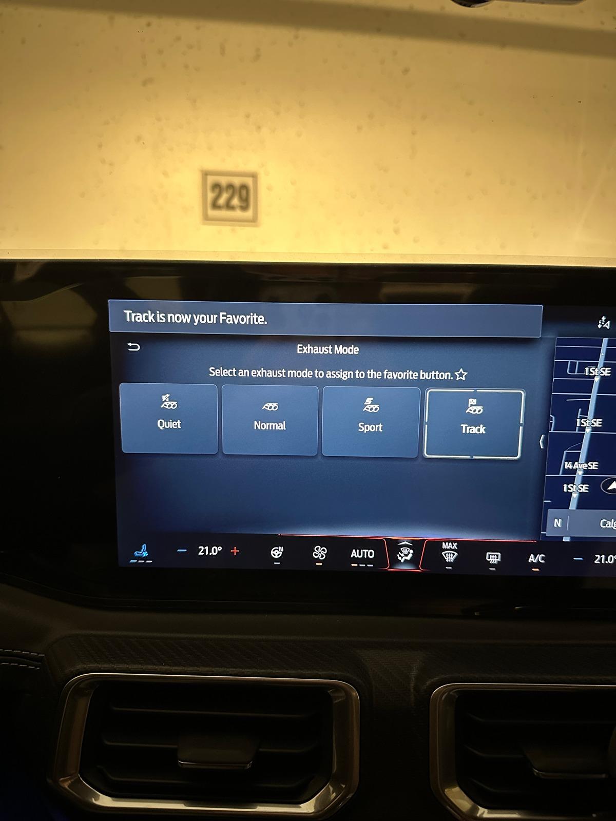

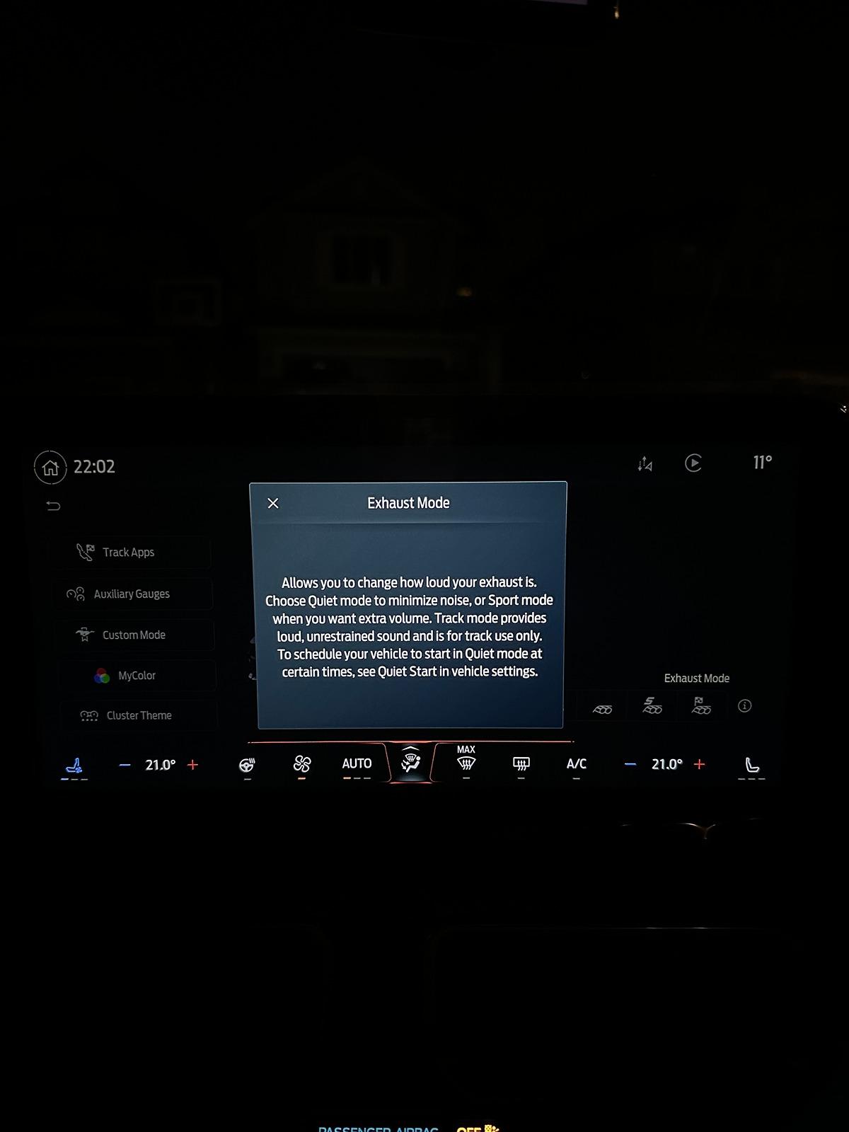

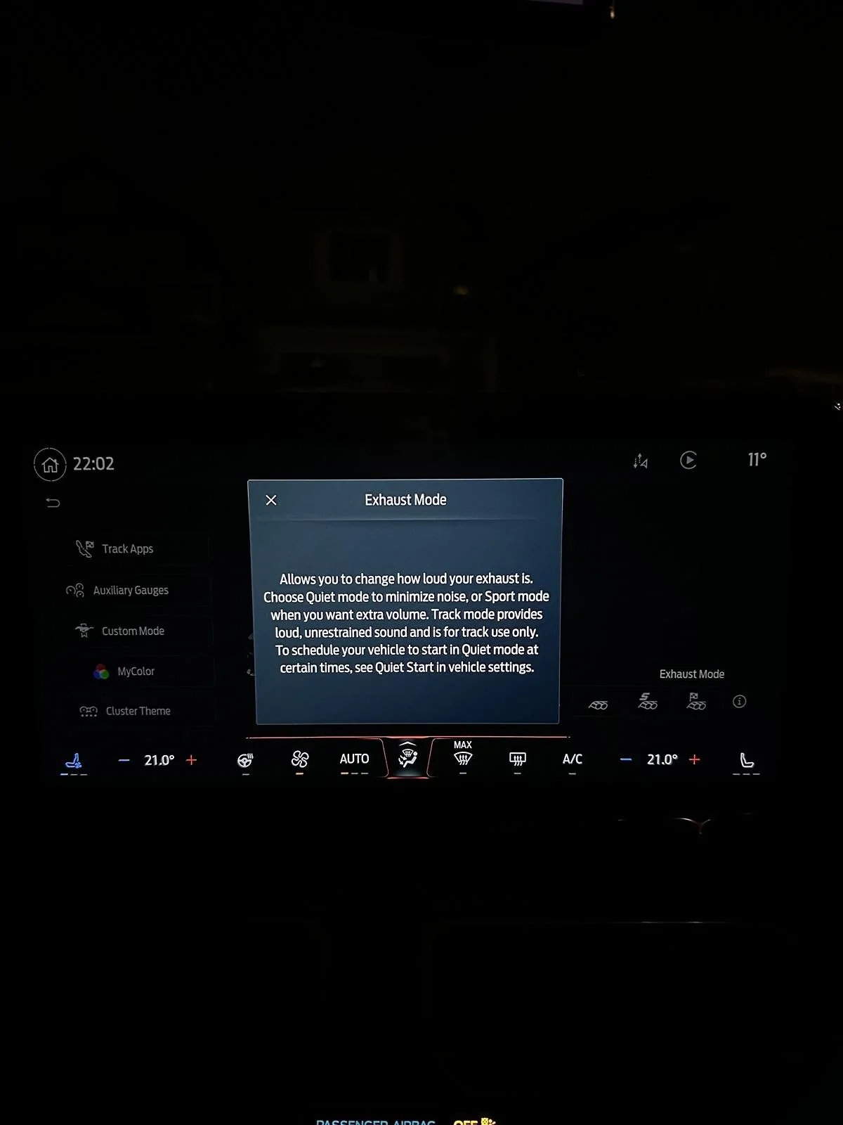

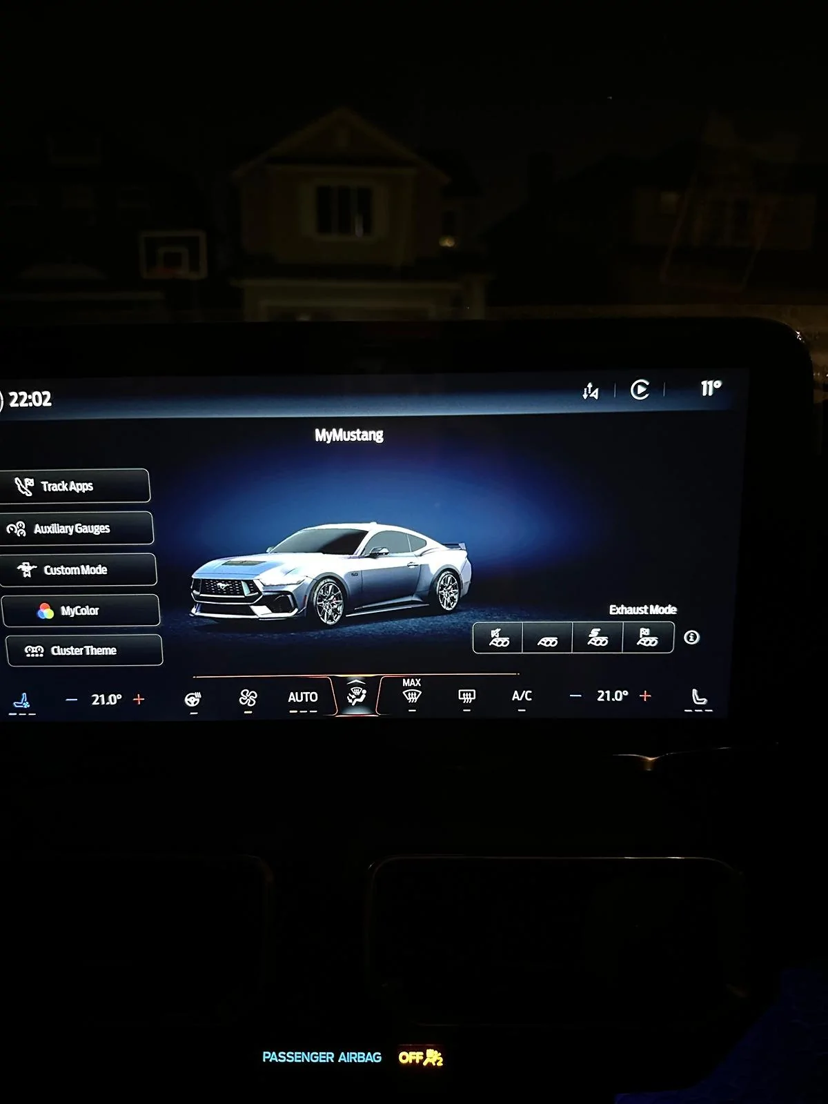

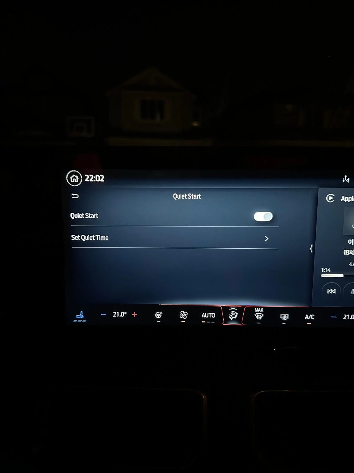

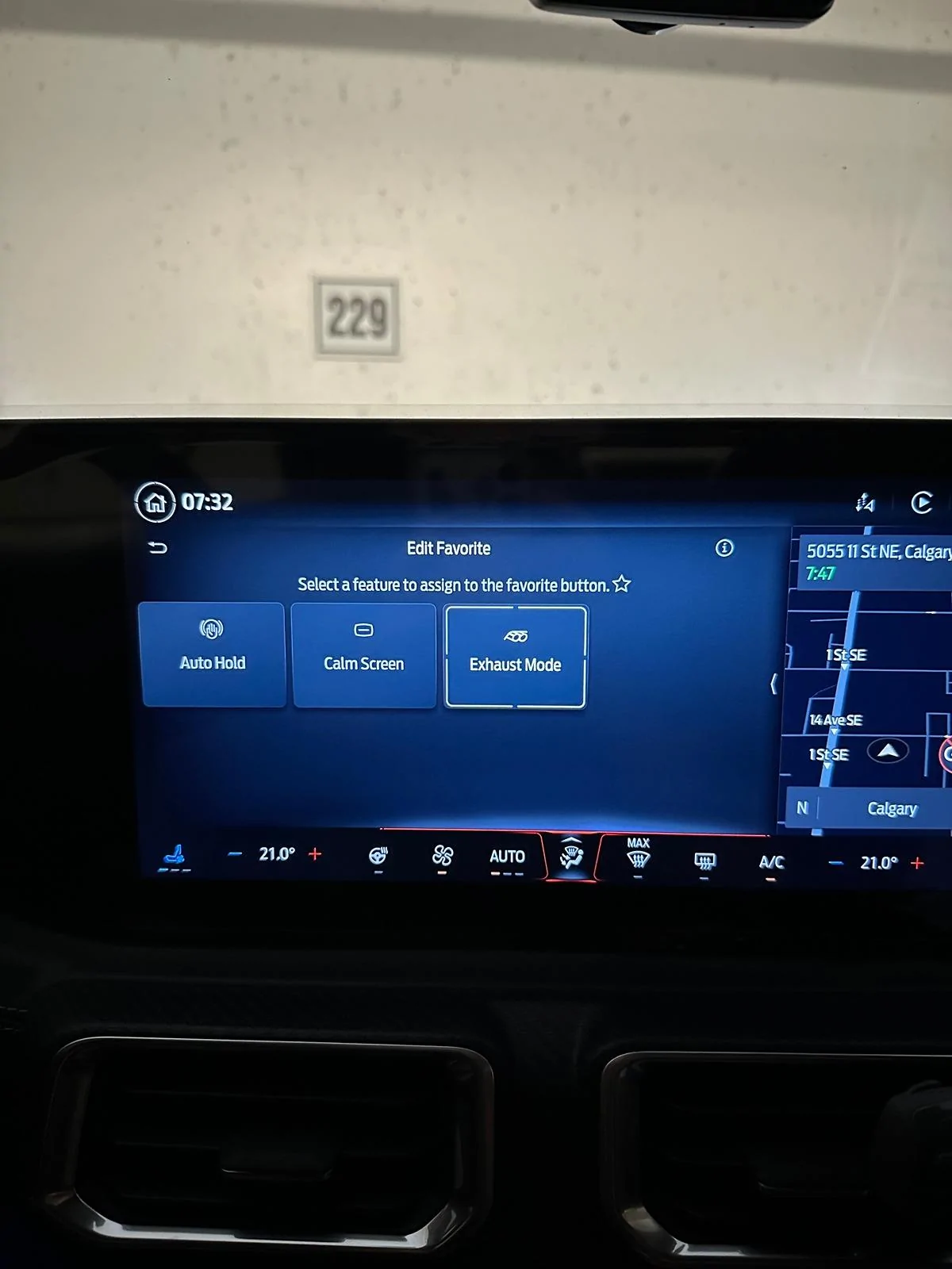

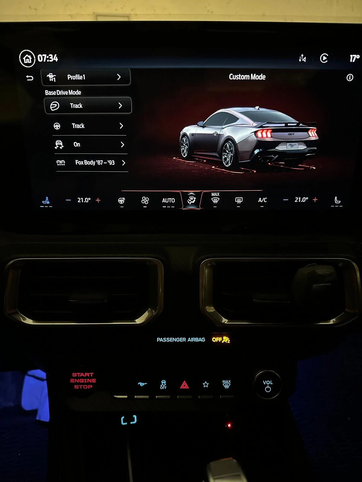

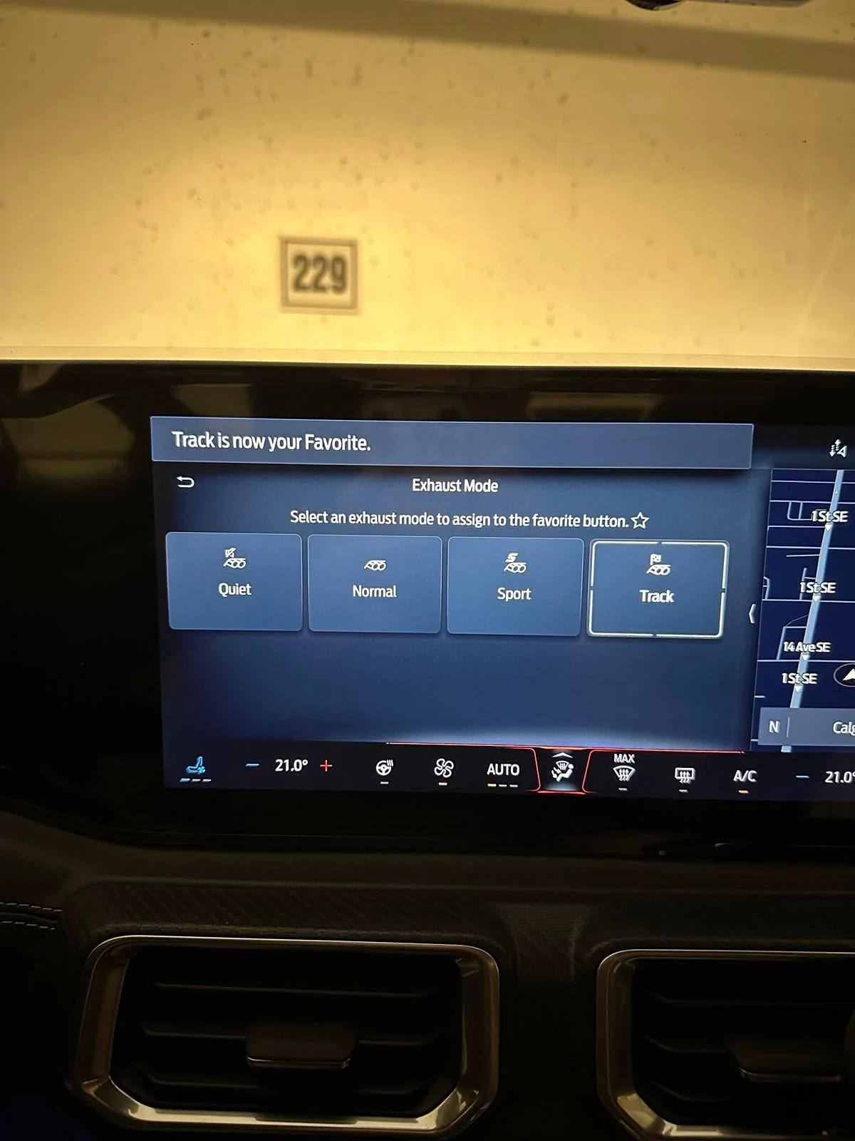

Good news
I reprogrammed my non AE Mustang to retrofit the AE without an actuator and its harness. It seems it has been added. Please see the attached pics. Only thing it's not been added is mode select tap on custom profile. I can't find which address is related to the custom mode. Since mine doesn't have active exhaust and its actuator comb yet, of course the button doesn't work. I ordered all the parts I need but it will take some time to be delivered because I am in Canada that makes me hard to get any parts and the parts are on backorder.

So just to be clear. You change the Forscan codes but have not yet done any installation...wiring or otherwise right? It is not complaining about no feedback or anything?
No it’s not. I was actually going to back program if it would warn me. I don’t have to worry about it anymore though. When I press the button on my Mustang, a window pops up and it says ‘it’s not available now. Try later’. I am pretty sure it will work once I install a full active exhaust system. We will see
