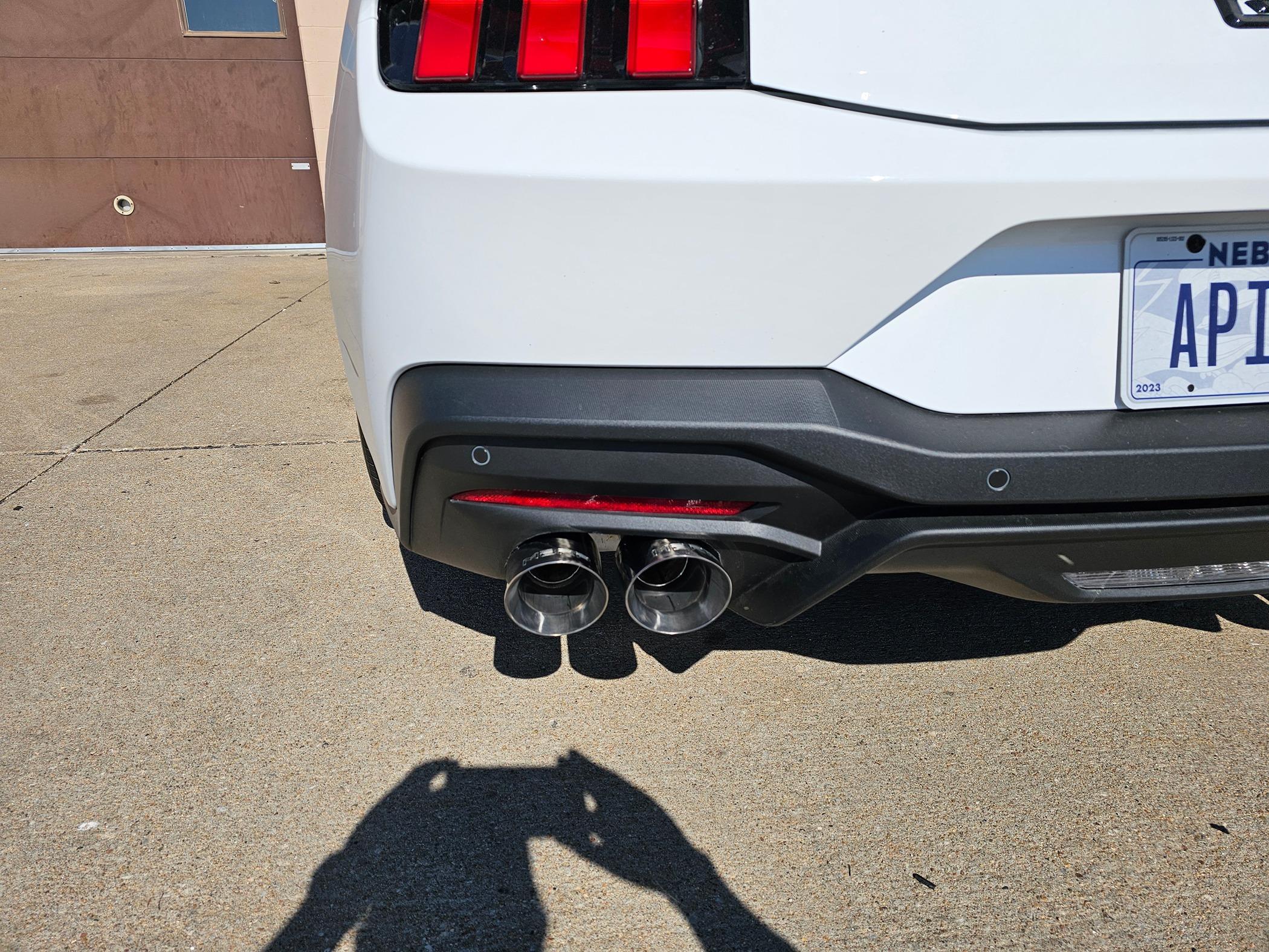

Really wish Ford hadn't gone to the single tips for the non-active exhausts...so a little Dremel work and an MBRP Street cat-back for an '18-'23 and bam...sooo much better and sounds great too!!

Does the 18-23 exhaust fit on these 24s? Ive been looking at a deal on a corsa system but its an 18-23 so i wasnt sure if it would fit
They sure do, only 'issue' I had was the MBRP midpipe hangers are backwards versus the stock, didn't effect anything though

I did the exact same thing to install an NXT axleback on mine. '18-'23 was en exact bolt on.

would a 18/23 corsa extreme fit on my 24 ? since they don’t make new ones for the 24 that are quad tips non active
