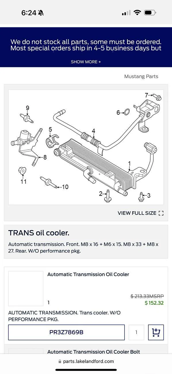

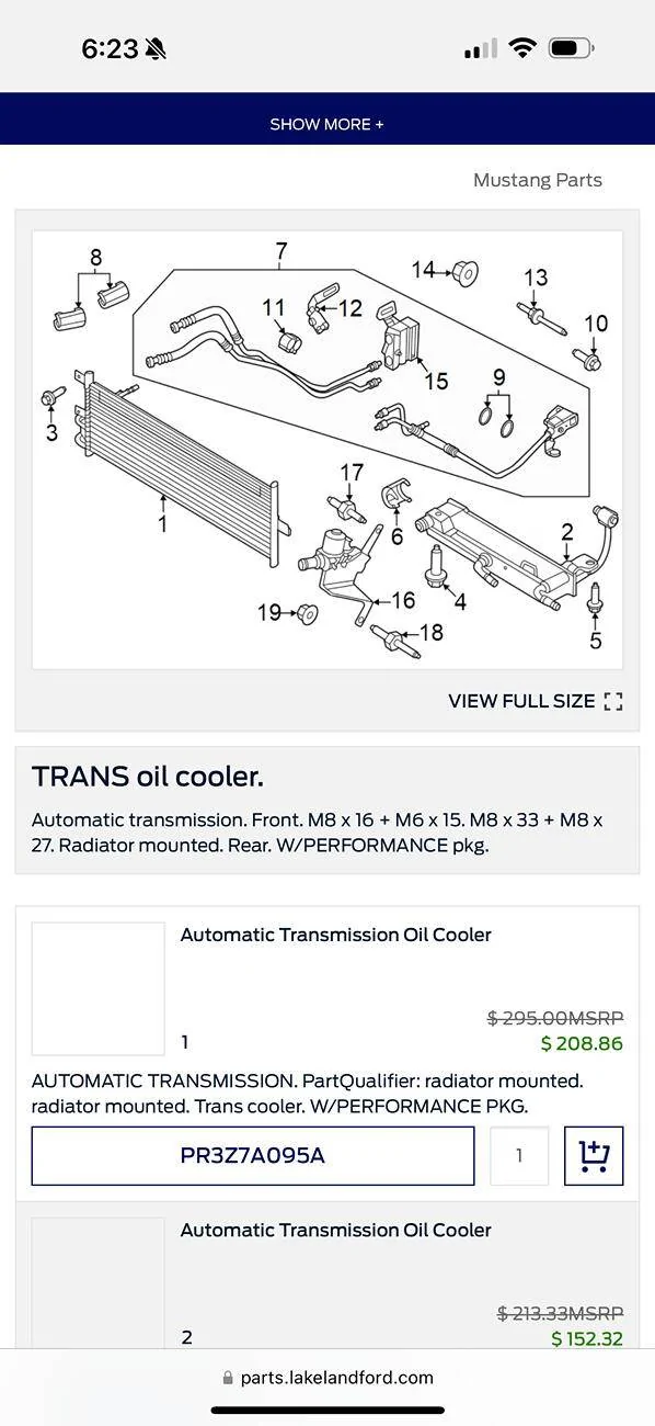

In looking at the parts online, it appears the PP and non-PP have different coolers.
Edit: Upon closer inspection of the PP cooler diagram, it appears the non-PP cooler is also a part of the PP system. In the bottom PP photo you can see that part #2 is the same as part #1 in the non-PP photo. I checked and the part numbers are the same for both. So, it looks like the PP does indeed have an extra cooler.
Hmmm. I'm curious to know the difference. Looks like maybe the PP version is assisted by an additional small radiator. I wonder where it's located.
I've got my car up on the lift at the house. If I have some time this weekend, I'll pull the cover from underneath and get some photos of the coolers to see exactly how it's setup.
