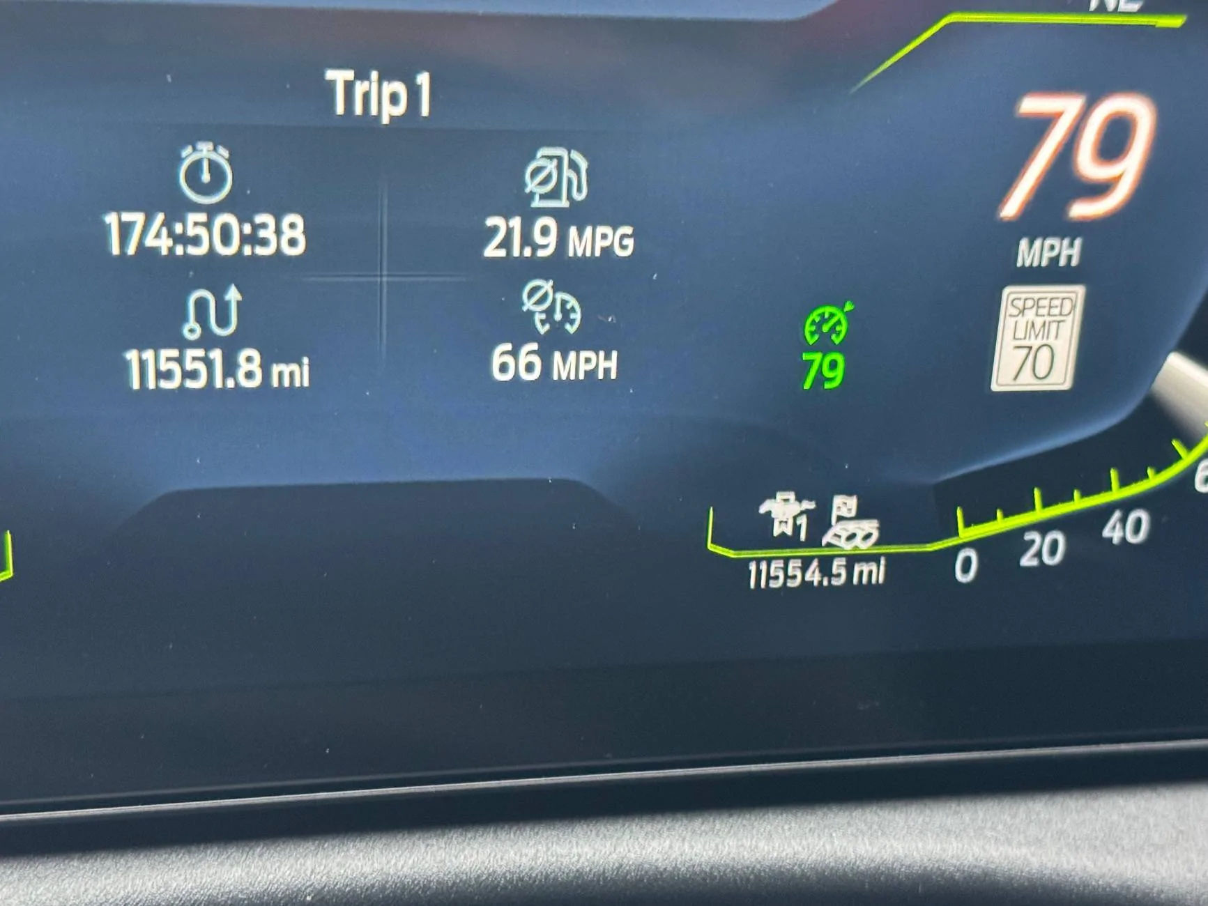

Here’s another data point: probably 85% hwy miles and I do not baby it. 22mpg at 11,500 miles all on 87 octane and it’s a 6spd.
S650 Mustang 87 Octane IMG_3001
3,003
2,992
21mpg @ 66mph sounds perfectly normal
Octane isn't really going to affect mpg
