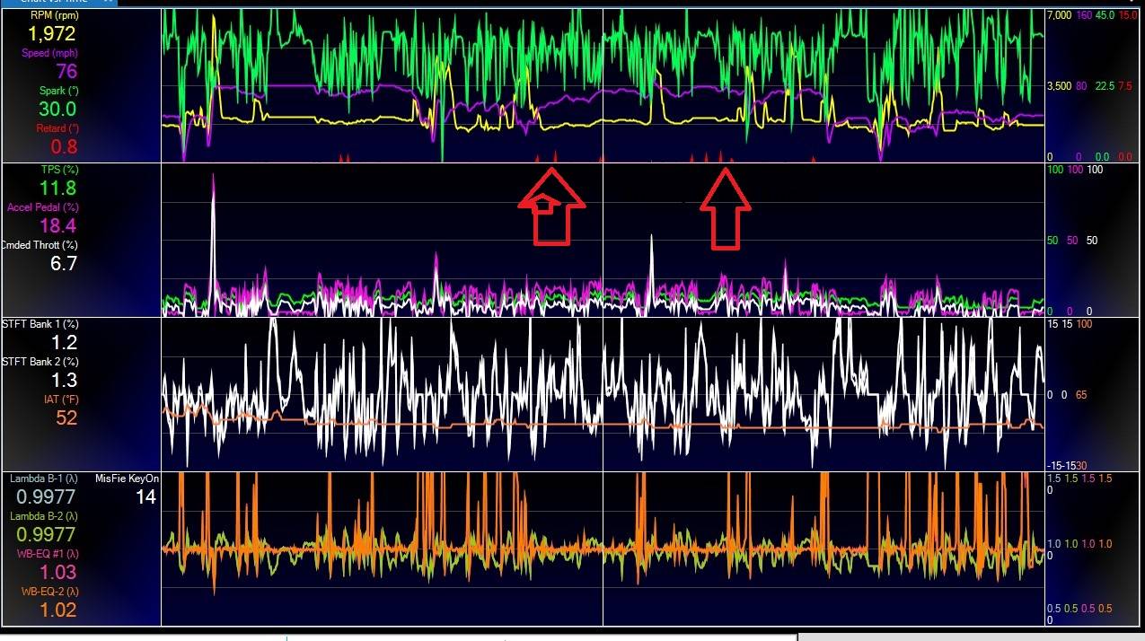

I been running Ethanol Free 87 this week since too cold for tracks to open this weekend.
Here's screen shots from from a 30min log this morning, Figured I'd log it and see what the knock looks like after the LT install.
It was in the low 20's for this run and IAT's were running about 30 ....
1st thing too notice is there's a lot of steady speed knock with the cruise set at 75. Never felt anything though.
I did romp it couple times ...
I have to say I was surprised to see light knock at the beginning of those hits and then it cleared. PCM actually dialed in 27.5degrees of timing from that stop light hit.
I never felt or heard any knock.
My wife runs 87 e10 only in her 21' M6 [ I think she'd have a seizure if she had to run 93 ] and when I drive it and romp on it I can feel it knock and get a flashing CEL from misfires.
I rarely drive that car.
It is impressive the amount of timing the S650 is dialing up on 87 IMVHO ....

Quick Update, Logged a tank of BP93 earlier this week, Still seeing some steady speed knock, but it's much reduced over the 87.

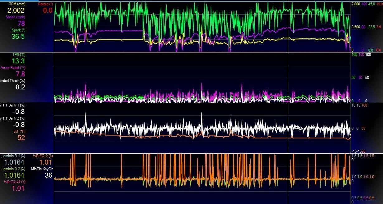

And logged a tank of E40 from Sheetz today, 8g E80 cut with 8g Sheetz 93. I figure that's equivalent to 96Octane.
Log shows Zero Steady Speed Knock. Which I expected since I've seen very little knock on ethanol blends <E30 I've logged over the months.
S650 Mustang 87 Octane SteadySpeed_Drive_BP93
S650 Mustang 87 Octane E40_Sheetz_Drive_95Octane_Equiv
