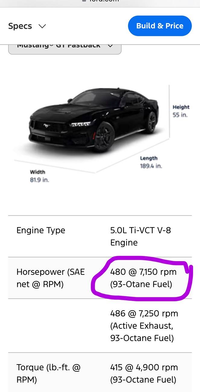

Read the fine print. The manual says is so many words, the performance figures (horsepower and torque) are based on using regular gasoline (87 octane?). Some Ford (and car mags) literature state higher figures when using premium. Since 90% of the Mustang drivers are gear heads, smirking about needing premium along with its price hike, is a bit disingenuous.
Straight from my owners manual page 166 and 167
Page 166
Your vehicle operates on regular unleaded gasoline with a minimum pump (R+M)/2 octane rating of 87. Some fuel stations, particularly those in high altitude areas, offer fuels posted as regular unleaded gasoline with an octane rating below 87. The use of these fuels could result in engine damage that will not be covered by the vehicle Warranty.
Page 167
For best overall vehicle and engine performance, premium fuel with an octane rating of 91 or higher is recommended. The performance gained by using premium fuel is most noticeable in hot weather as well as other conditions, for example when towing a trailer. See Towing a Trailer (page 271). Do not be concerned if the engine sometimes knocks lightly. However, if the engine knocks heavily while using fuel with the recommended octane rating, contact an authorized dealer to prevent any engine damage. We recommend Top Tier detergent gasolines, where available to help minimize engine deposits and maintain optimal vehicle and engine performance.

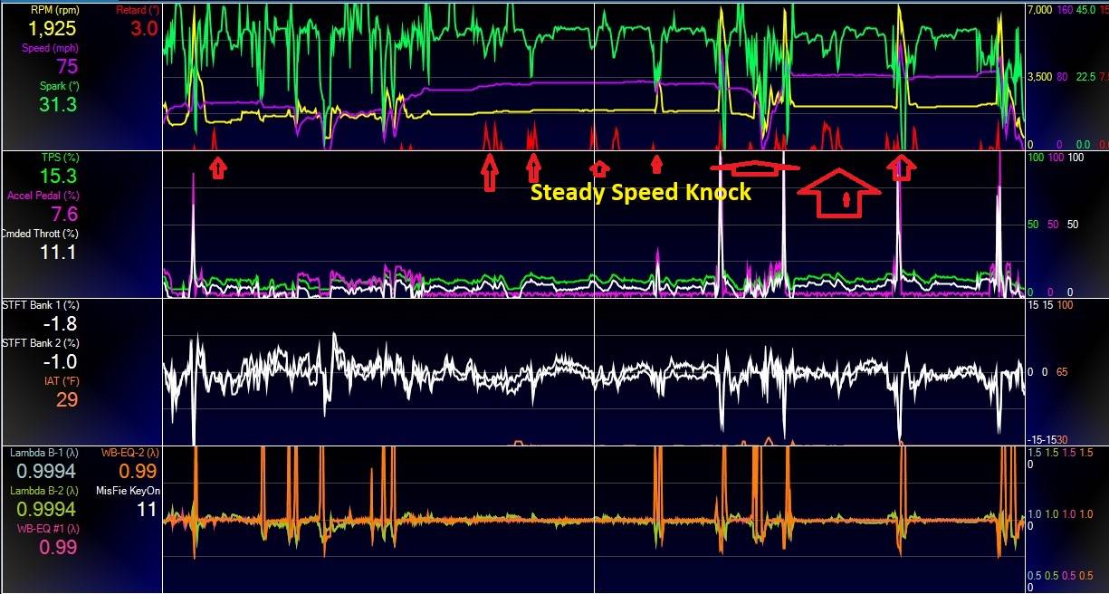

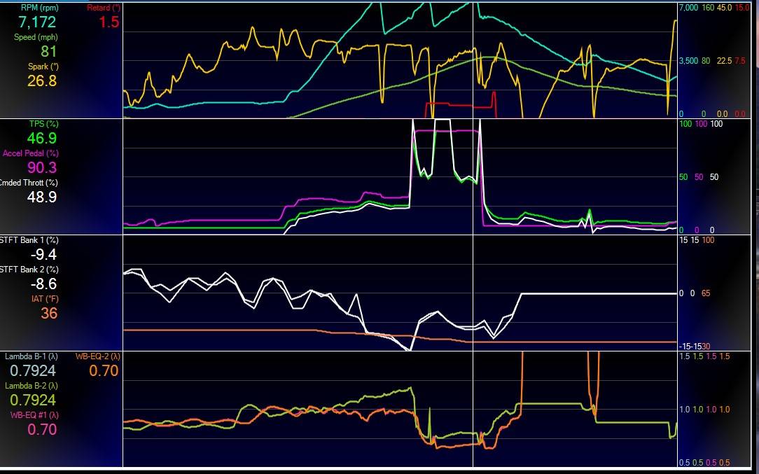

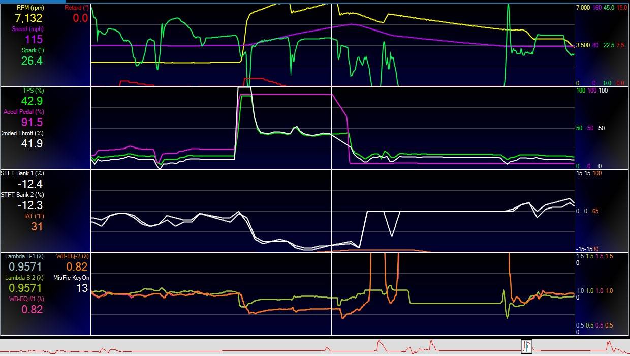

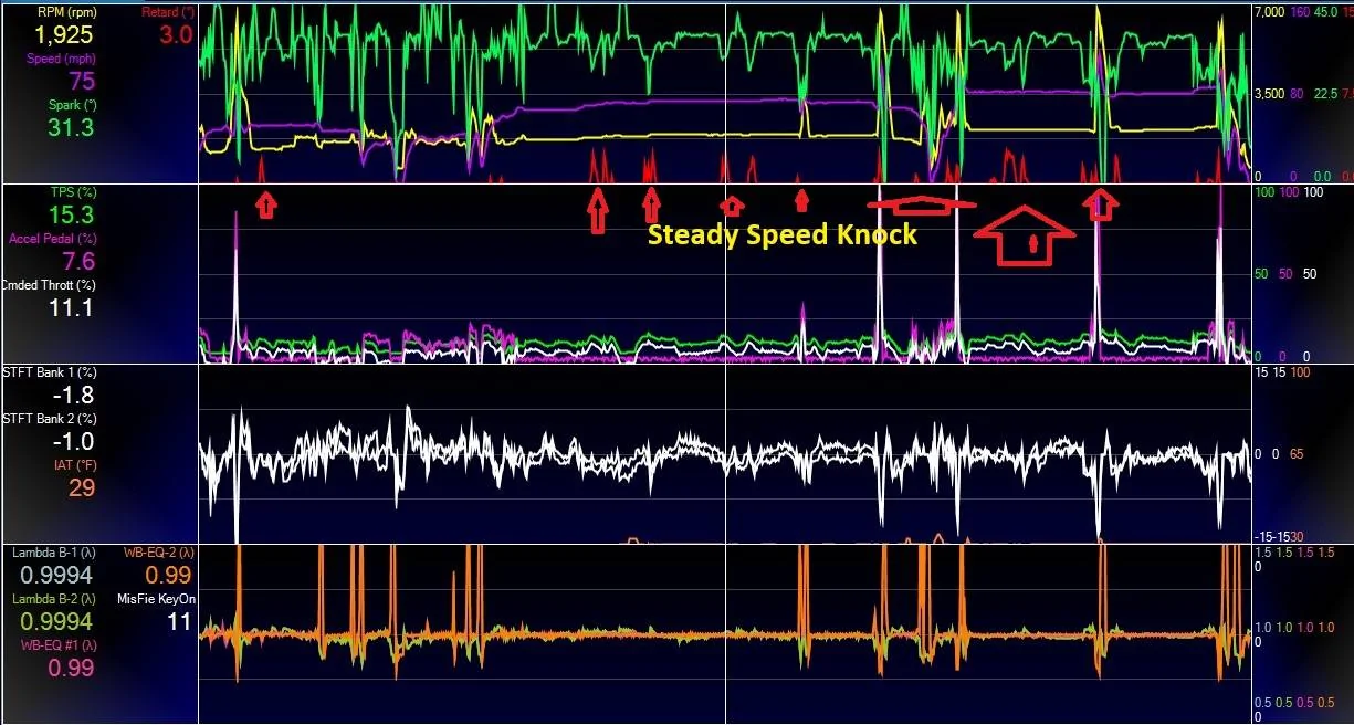

I been running Ethanol Free 87 this week since too cold for tracks to open this weekend.
Here's screen shots from from a 30min log this morning, Figured I'd log it and see what the knock looks like after the LT install.
It was in the low 20's for this run and IAT's were running about 30 ....
1st thing too notice is there's a lot of steady speed knock with the cruise set at 75. Never felt anything though.
I did romp it couple times ...
I have to say I was surprised to see light knock at the beginning of those hits and then it cleared. PCM actually dialed in 27.5degrees of timing from that stop light hit.
I never felt or heard any knock.
My wife runs 87 e10 only in her 21' M6 [ I think she'd have a seizure if she had to run 93 ] and when I drive it and romp on it I can feel it knock and get a flashing CEL from misfires.
I rarely drive that car.
It is impressive the amount of timing the S650 is dialing up on 87 IMVHO ....
