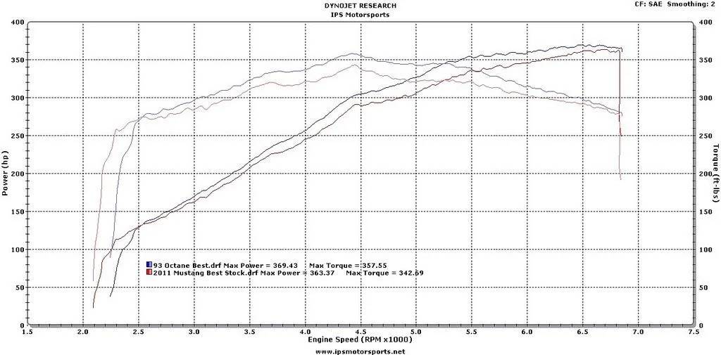

Here's a gen 1 coyote for shits and giggles

Dyno pulls do not tell the entire story
