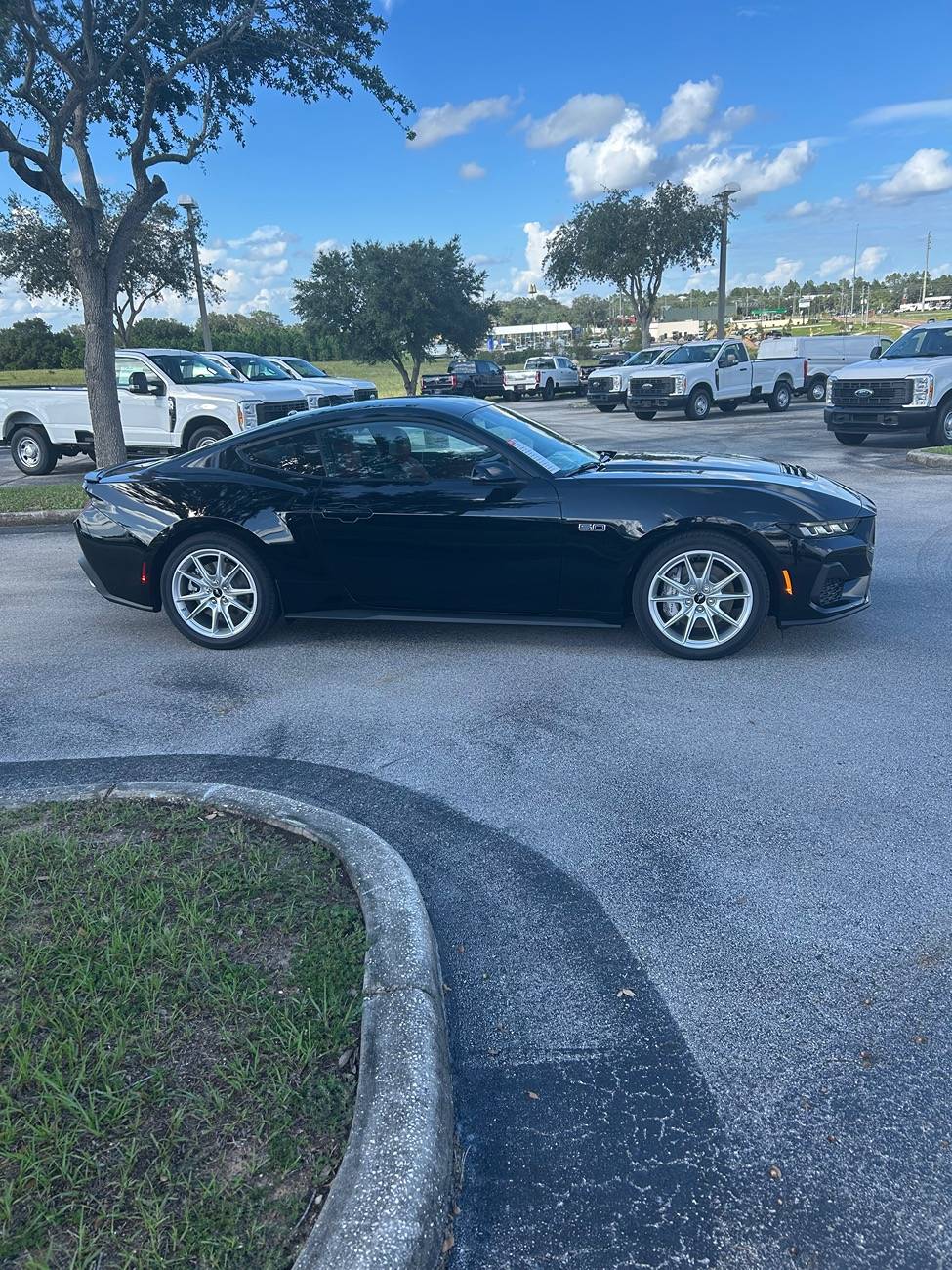

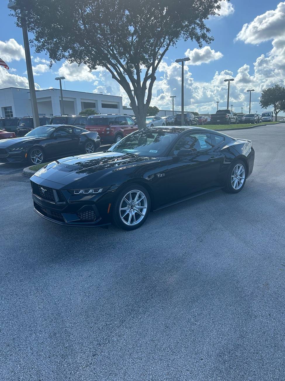

Pictures of the car stock
At the dealership with 7 miles.

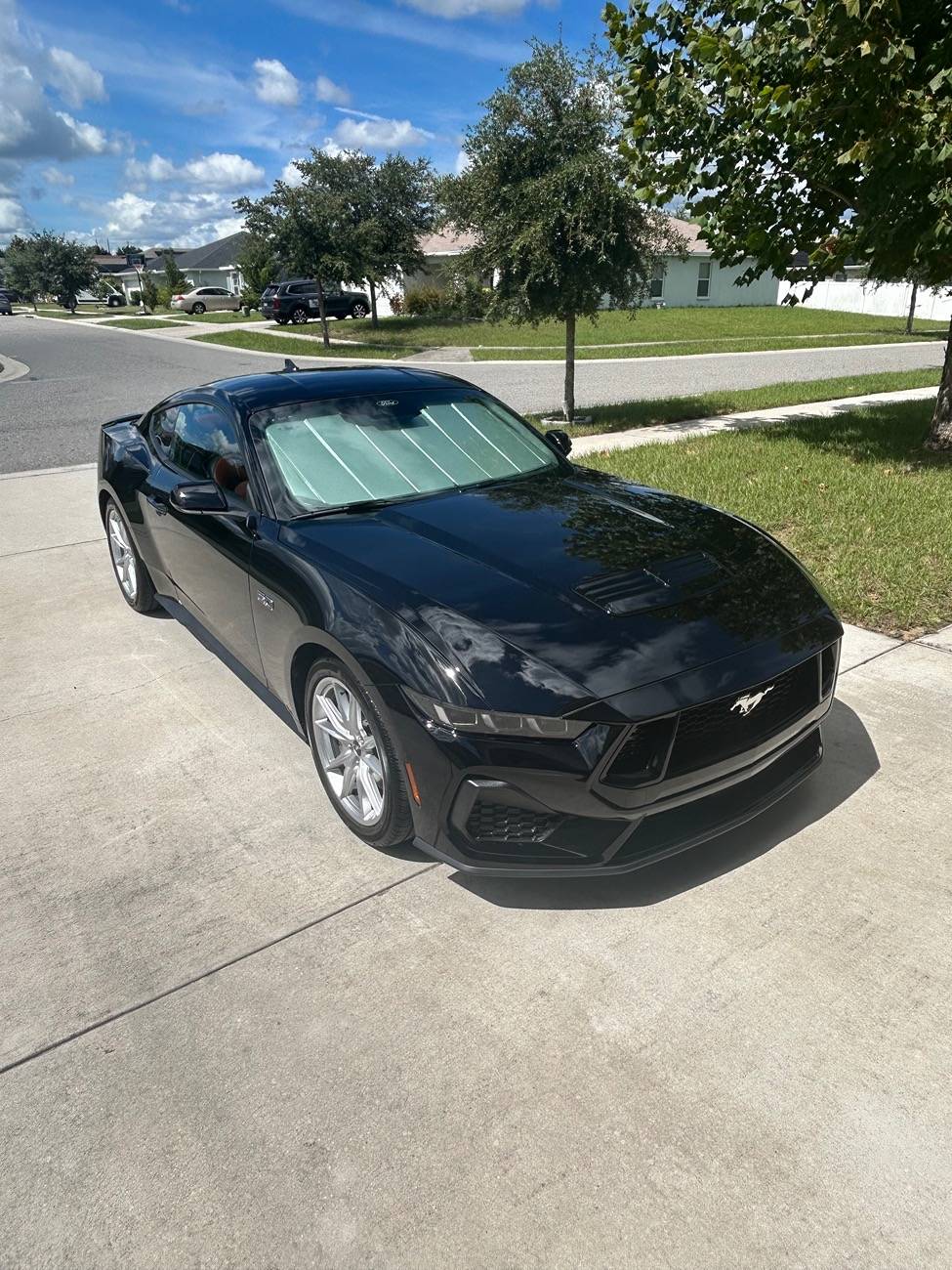

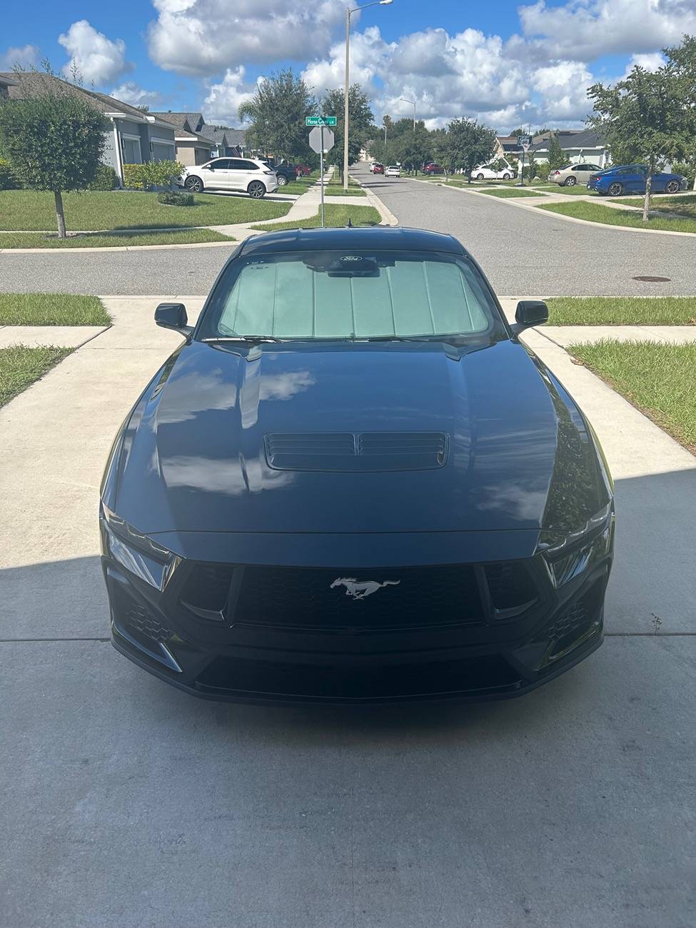

And finally in the driveway the next day, 11/5/24.
S650 Mustang 89Trooper's Garage - Modification Journal IMG_6843
S650 Mustang 89Trooper's Garage - Modification Journal IMG_6845
S650 Mustang 89Trooper's Garage - Modification Journal IMG_6844

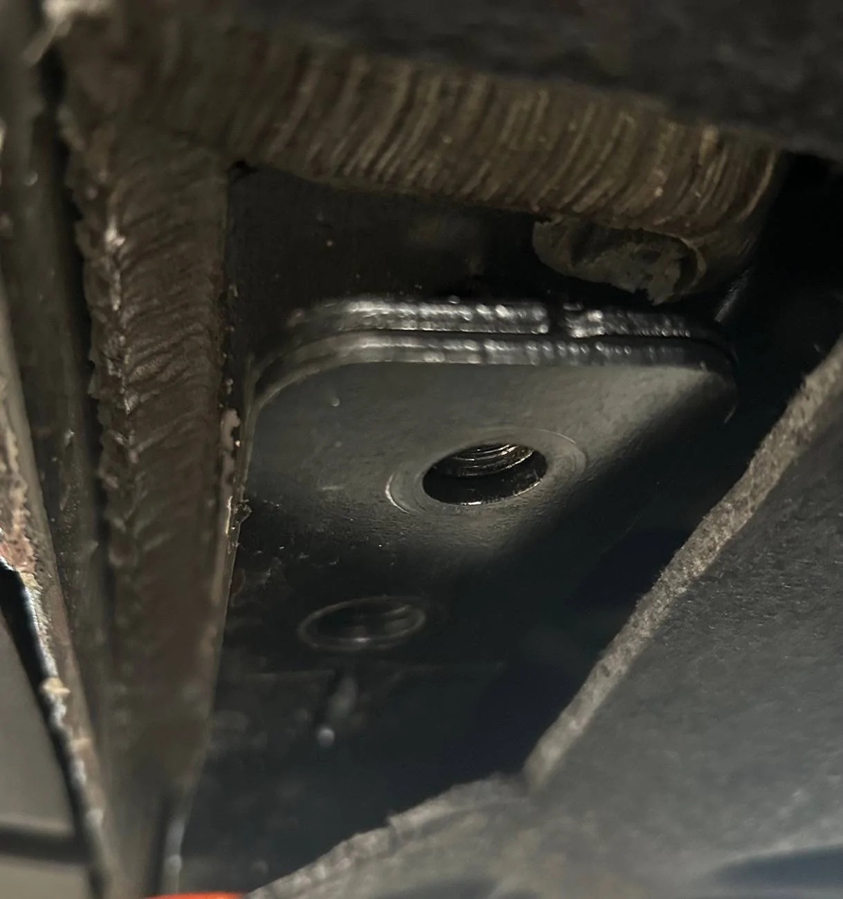

Installation is a piece of cake, but there is one thing that I have not seen mentioned in any of the write-ups for installing these.

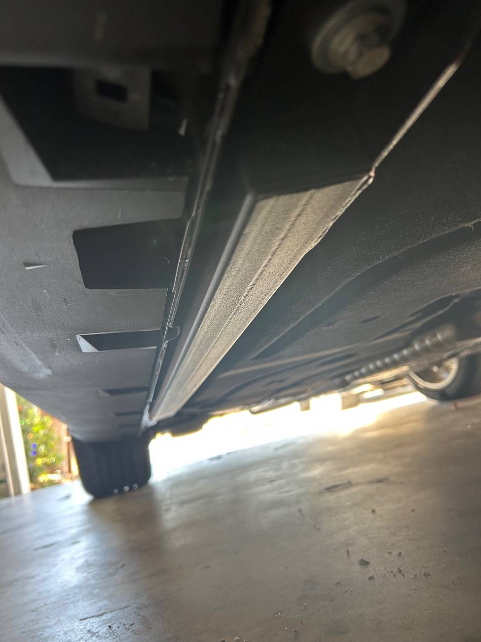

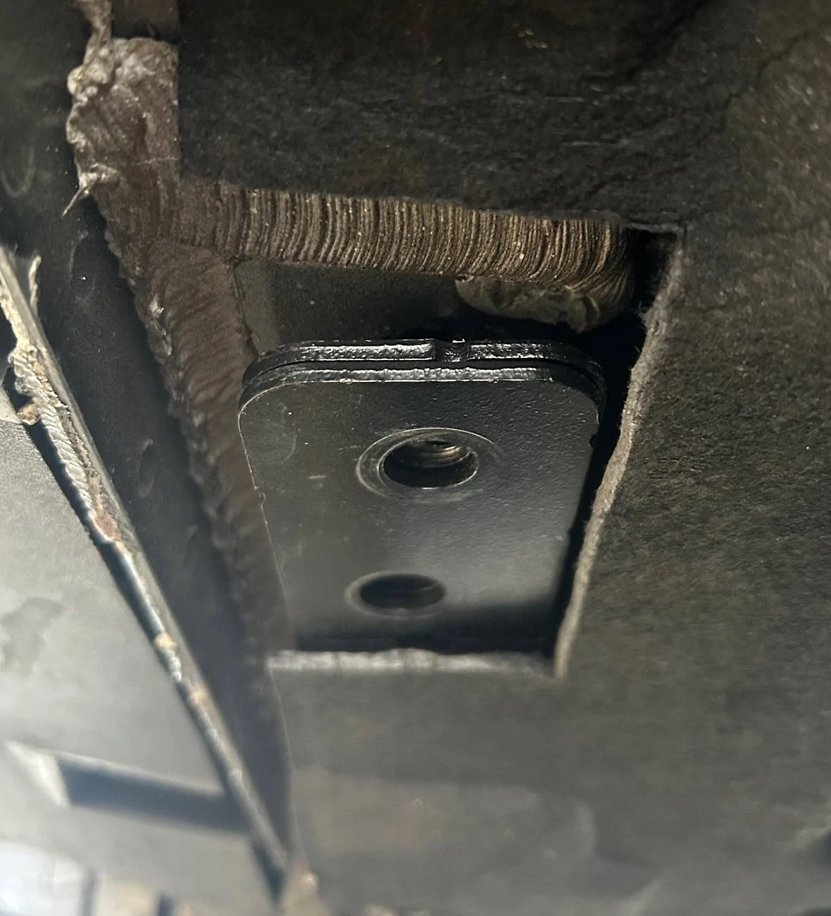

@tj@steeda - as you remove the front two bolts, a plate is there under the material that you cut away (this was not on my 2015). It can't be removed, as it is attached at other locations, so you have to mount the jacking rail on top of this plate.
As you loosen the two bolts, it hangs down quite a bit and goes pretty far toward the front of the car:
S650 Mustang 89Trooper's Garage - Modification Journal IMG_7380
S650 Mustang 89Trooper's Garage - Modification Journal IMG_7381
This is really no big deal except for these two things:
  • The four shorter bolts that come with the kit can't be used anywhere so I had to reuse four of the stock bolts.
  • The jacking rails end up at a slight angle.
It's hard to get a picture of it, and this picture does exaggerate the angle. When looking from the side, the rail is slightly lower in the front. Of course, you can't see this unless you get under the car, and it doesn't affect jacking up the car at all.

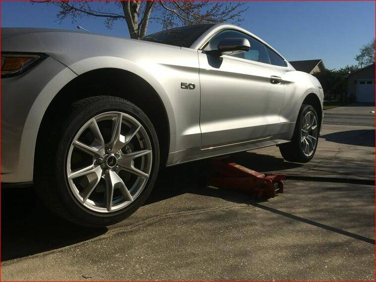

I wouldn't own a Mustang without these. A few pumps right in the dead center with a floor jack, and the entire side of the car is in the air. If you rotate tires front to back, easy.
If you want all four tires off, jack up the one side, put jack stands under the rails, and jack up the other side.
Here's a pic of my 2015 easily jacked up on one side. I wouldn't trust the pinch welds for this:

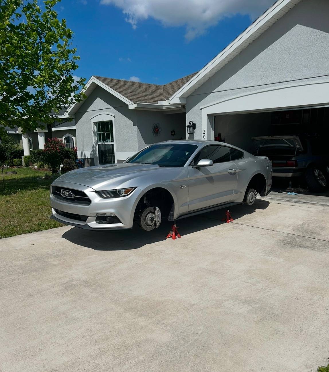

Where have you seen that? I have had the car (both cars now) up on four jack stands many times. I've never had an issue and it couldn't be more solid.
I don't take the tires off until all four jack stands are in place (just in case, although there has never been anything close to something falling). And I make sure that all four jack stands are solidly planted (not leaning at all on either side).
Maybe cause they don't want to be responible for people that don't have common sense?
I don't have a pic of the 2024, yet, but here's the 2015 up on all four jack stands:
S650 Mustang 89Trooper's Garage - Modification Journal IMG_7414

See this video and FF to 4:05 for the statement not to use jack stands under the jack rails.
(I will note that I agree with you and should be fine using jack stands with them).
It's gotta be for liability purposes. I'm glad you agree, but for others, one can see from my pic that it doesn't even come close to putting the car in a precarious position. The weight distribution is nicely spread out.
