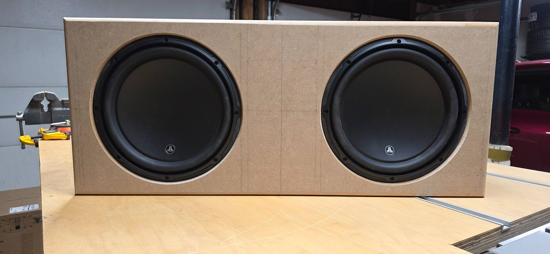

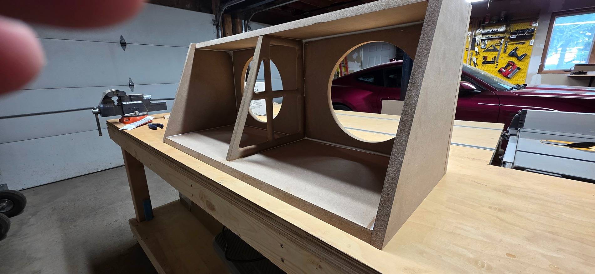

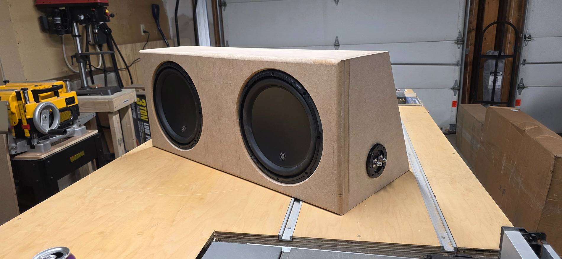

One of the first things we've been doing is a car audio build. Here the two JL 12s are finally in their custom enclosure.

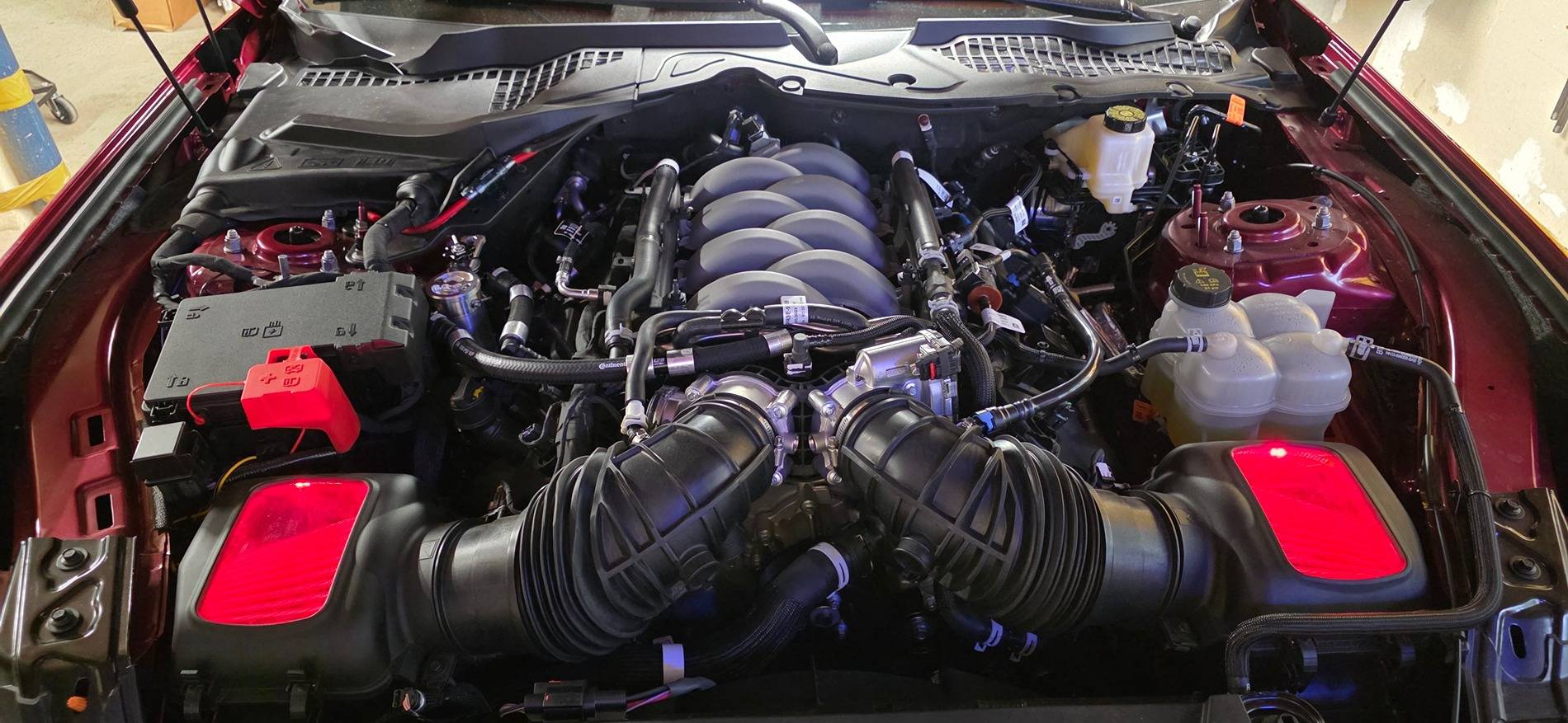

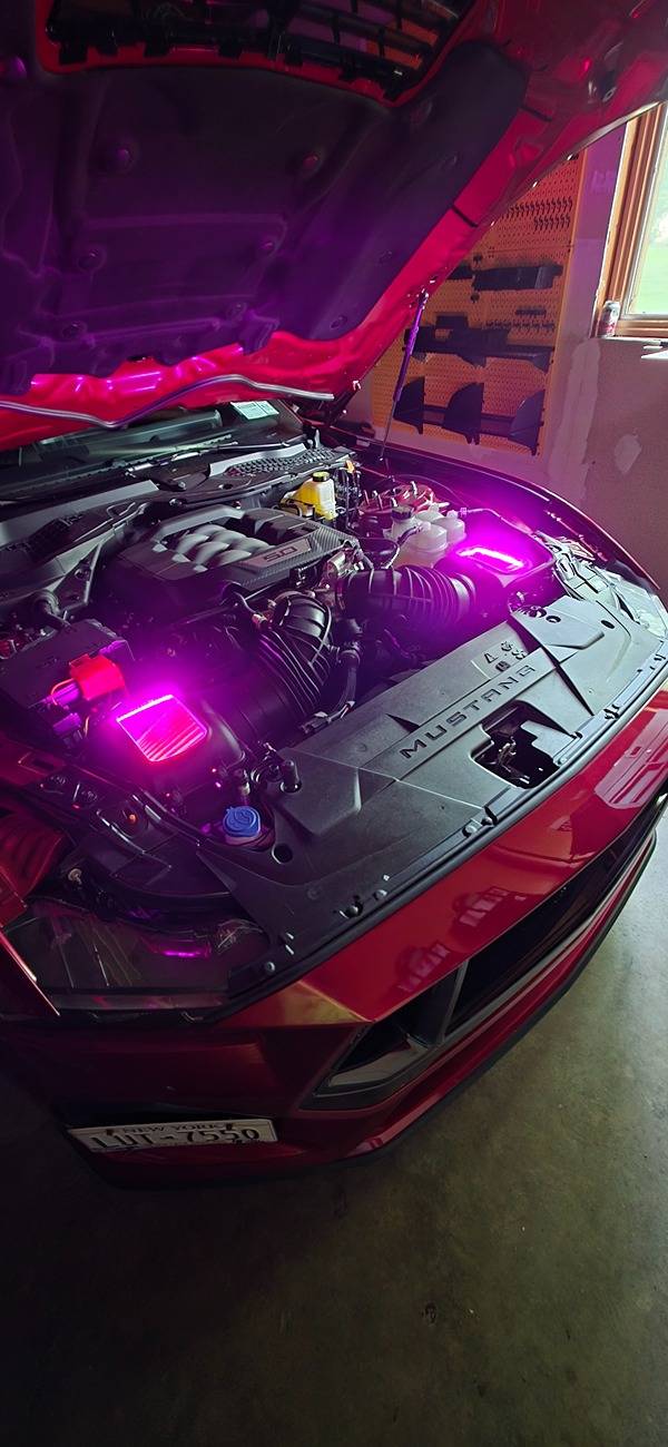

Let's not forget the first thing we did, added the Roush intakes (lol) along with LED light show with a hood switch cutoff. Proud of that redneck engineering...

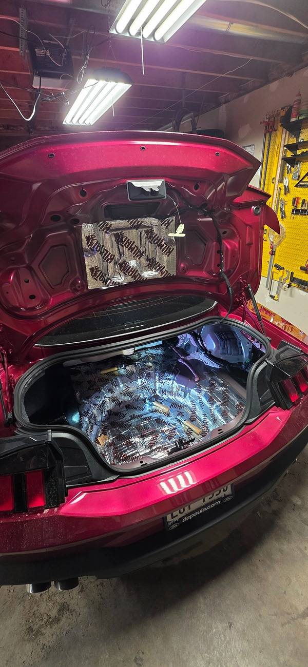

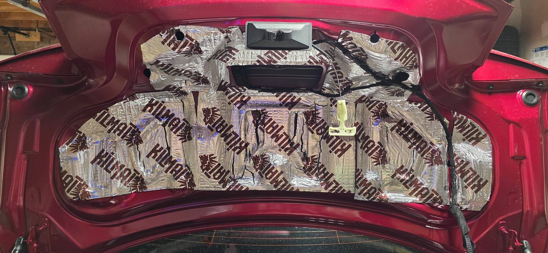

Wife was kind enough to lay down a whole lot of "dynamat" with me; got the whole trunk done over two days.

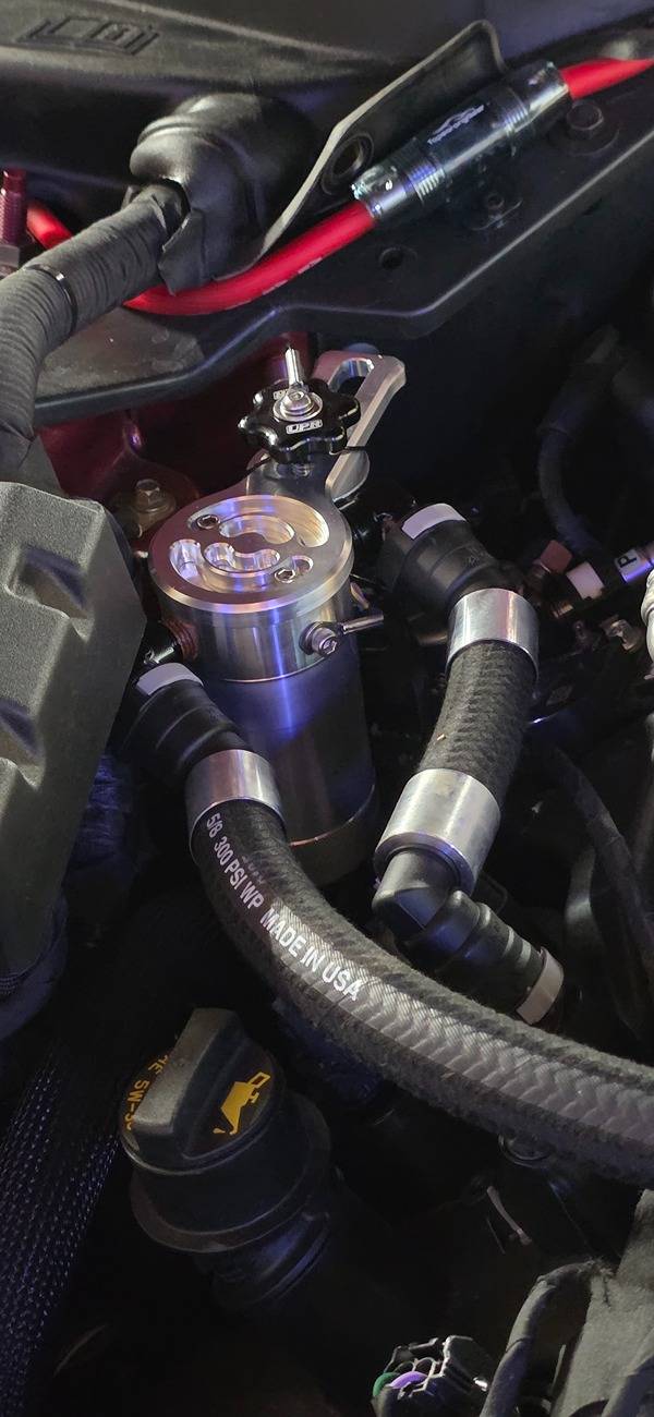

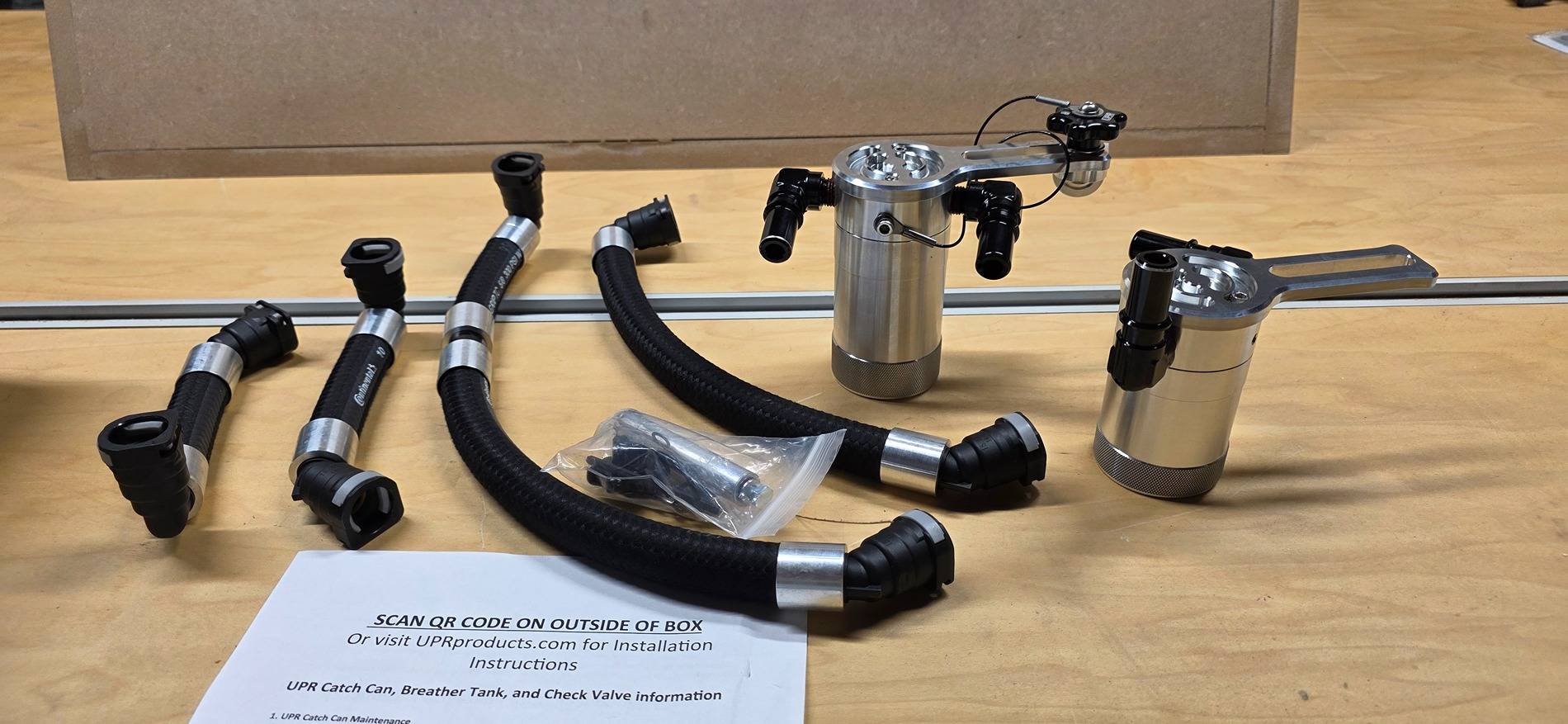

Yesterday (6/6/25) we got both of the UPR catch cans on...

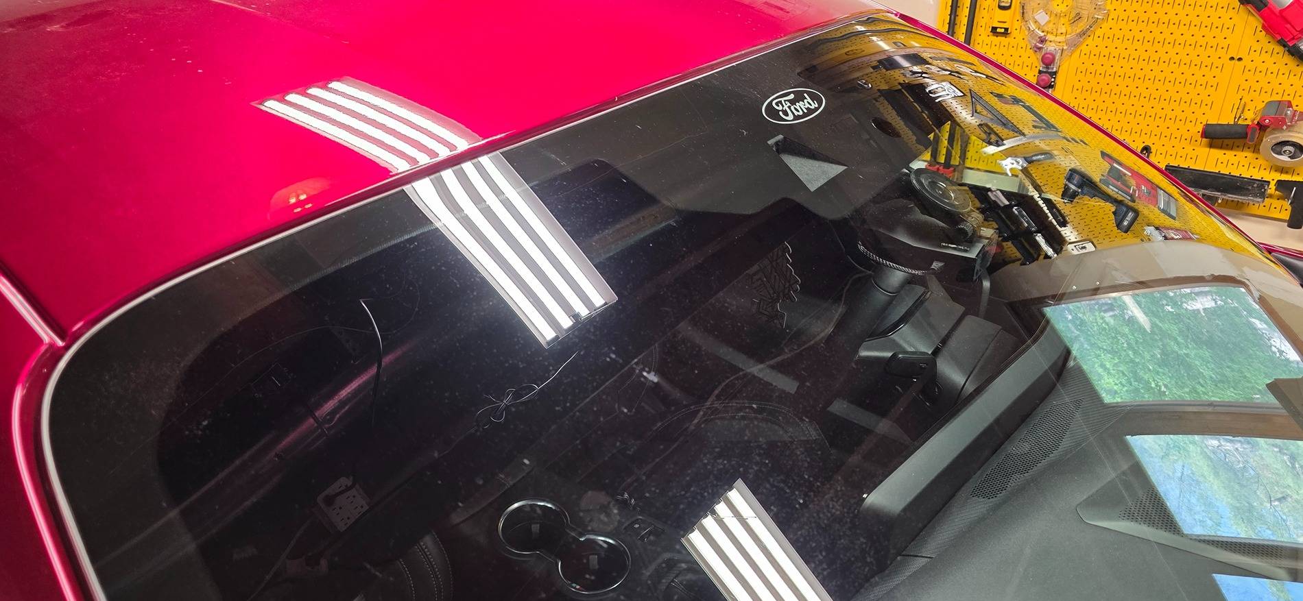

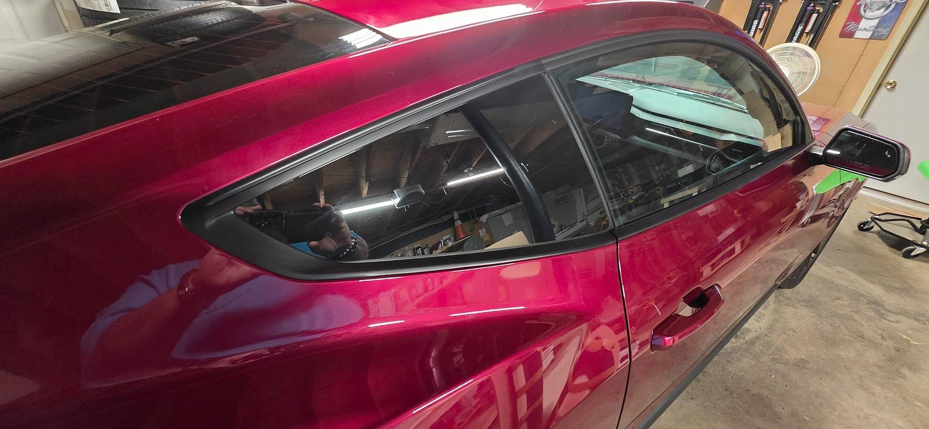

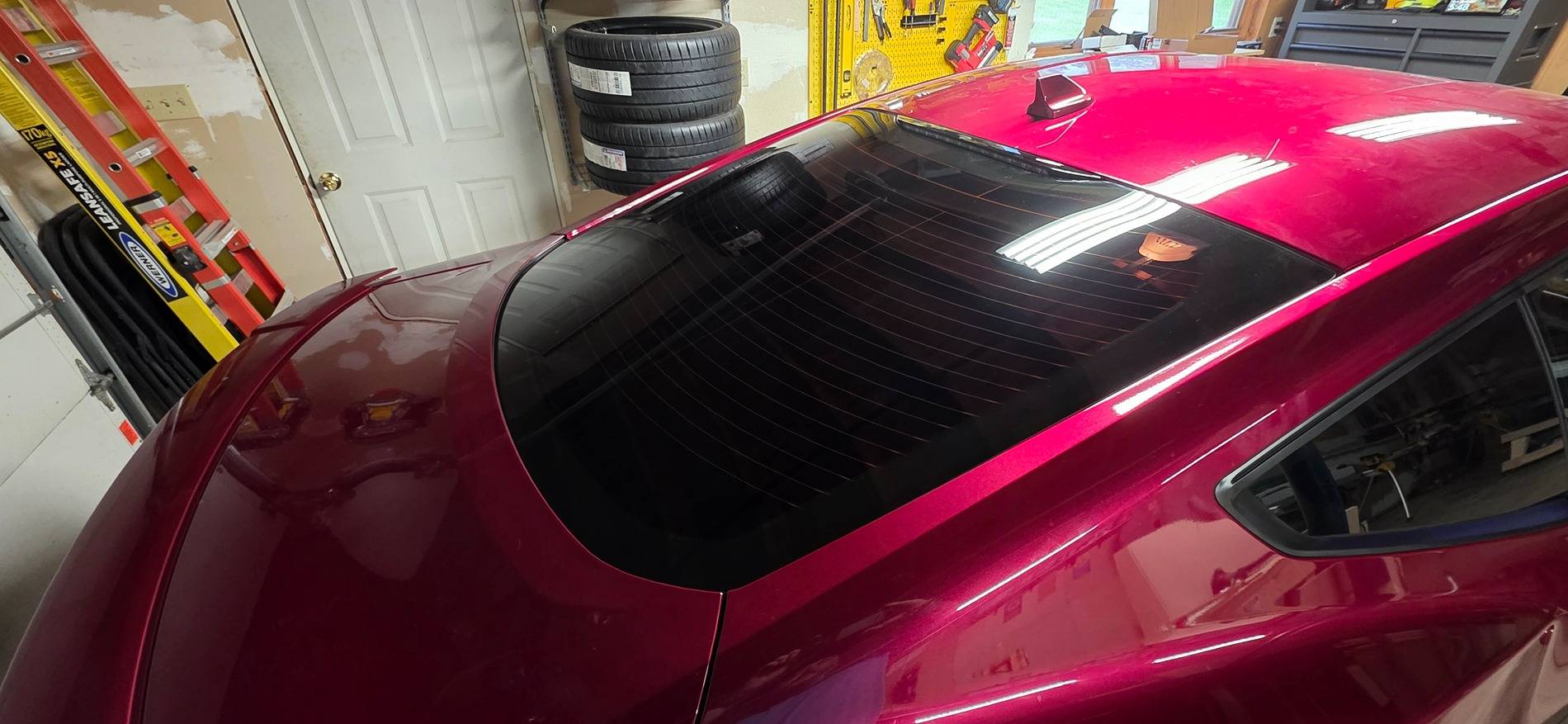

Oh snap, almost forgot that Adrian over at Tint King hooked us up. Got 5% everywhere it's legal here in NY. Could have done windows, but apparently there have been crackdowns. We love our windshield strip though. State law is 6", which is almost 1/3 of our windshield. Wife says it makes her feel like she's in a fighter jet.
I don’t have any practical experience with Dynamat. How is the stereo sound quality? Is it keeping the sound in or just reducing road noise? What does it do for the exhaust sound in the cabin?
I've actually marveled at how much noise it rejects. When I cold start now, I hear the car, but it's only when I open the door that I realize just how loud the cold start is. The trunk now feels like an echo chamber, but we're still slotting the amp rack. We actually just completed our sound test a few days ago, and tonight I'm hoping to finally mechanically mount both the subwoofer enclosure as well as the amp rack prior to taking it all apart again for upholstery work.
I will say that the Kilmat looks, acts, and behaves just like the pricier Dynamat, for a fraction of cost at your local massive online retailer.
Probably will drive around rest of the week to perform "sound quality tests", you know, for science... I'll report back. Biggest goal was to tamp down any "buzzing", like some of my builds 20 years ago lol...

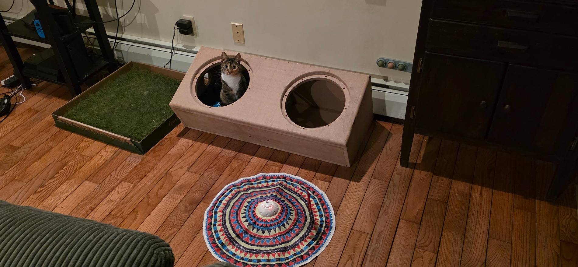

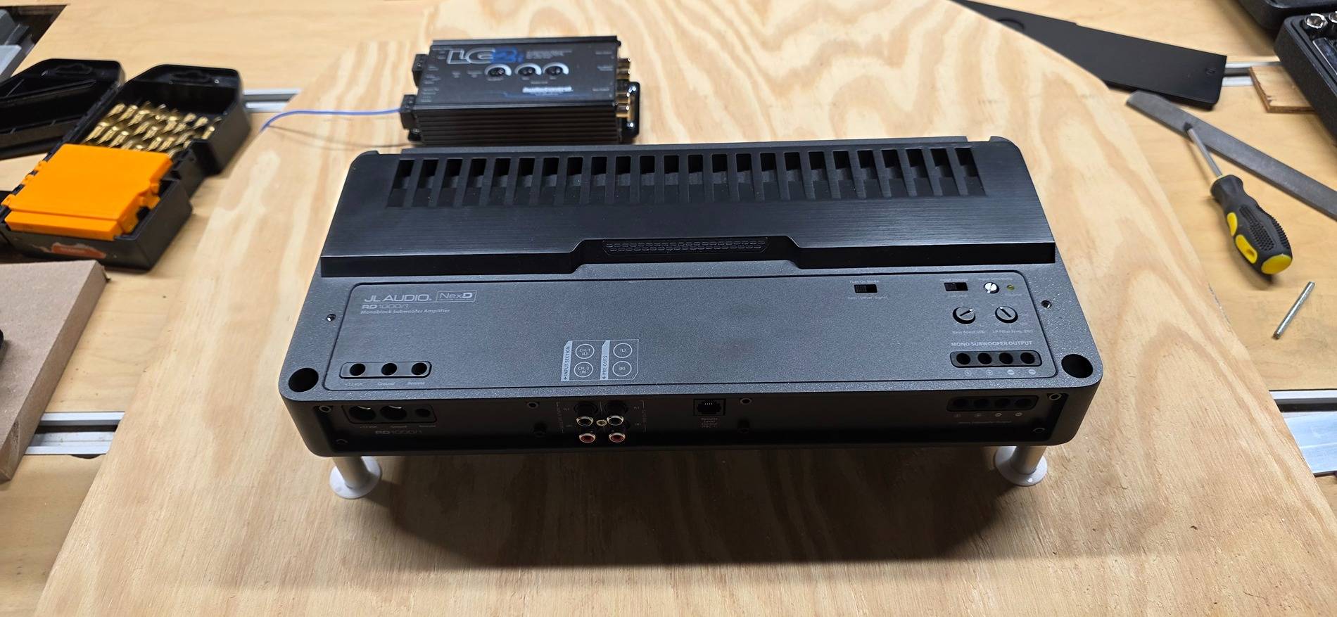

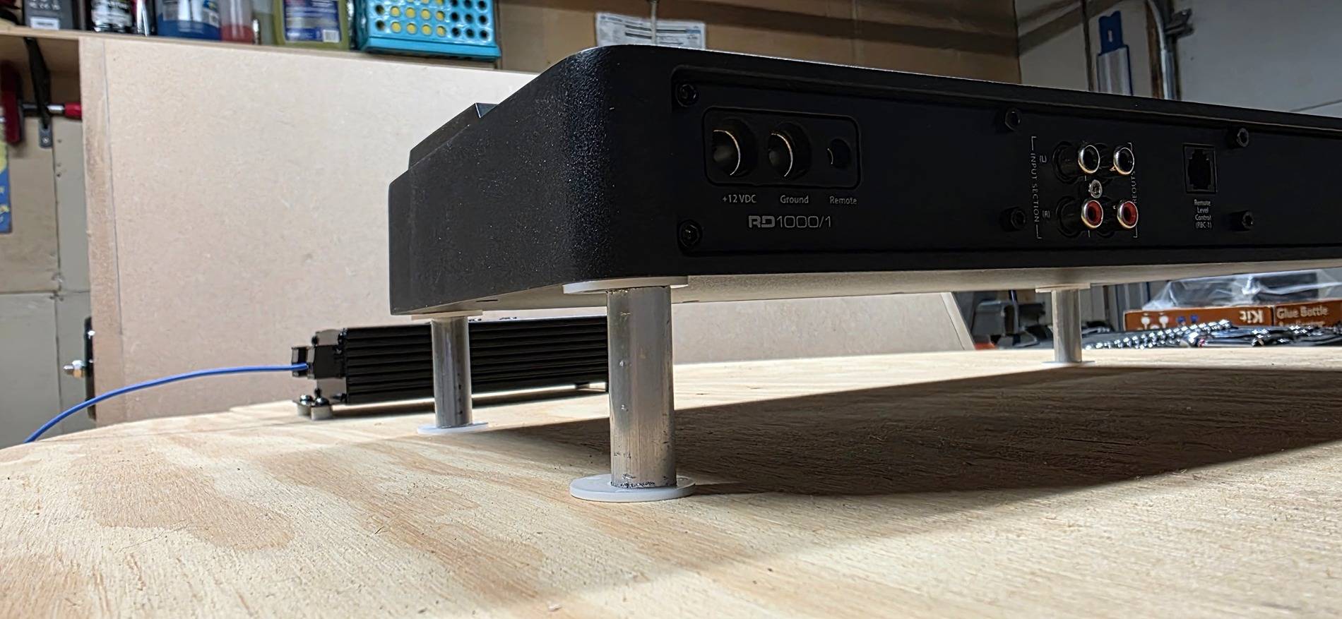

Crushing disappointment. After a rough day at work, and with the amp rack built, today we found out that we didn't account for the metal rings the rear seats attach to when they're propped up. The enclosure's 15" of clearance is 1 inch too many because of this, and won't fit. Sad panda. Struggled for half hour to no avail.
Wife saved the day, and declared the too-big-box the property of Spud; the people rejoiced.
S650 Mustang Abilor & Maude - Build & Maintenance Journal 1000021444
Now, we suck it up, and build box 2.0...
Amp rack looks good though! Will upholster prior to install. Happy with the floating amp mounts I fabricated.
i dont think you understand, that was Spud's box all along, silly human. the box just belongs to it's rightful owner, now. 🐈

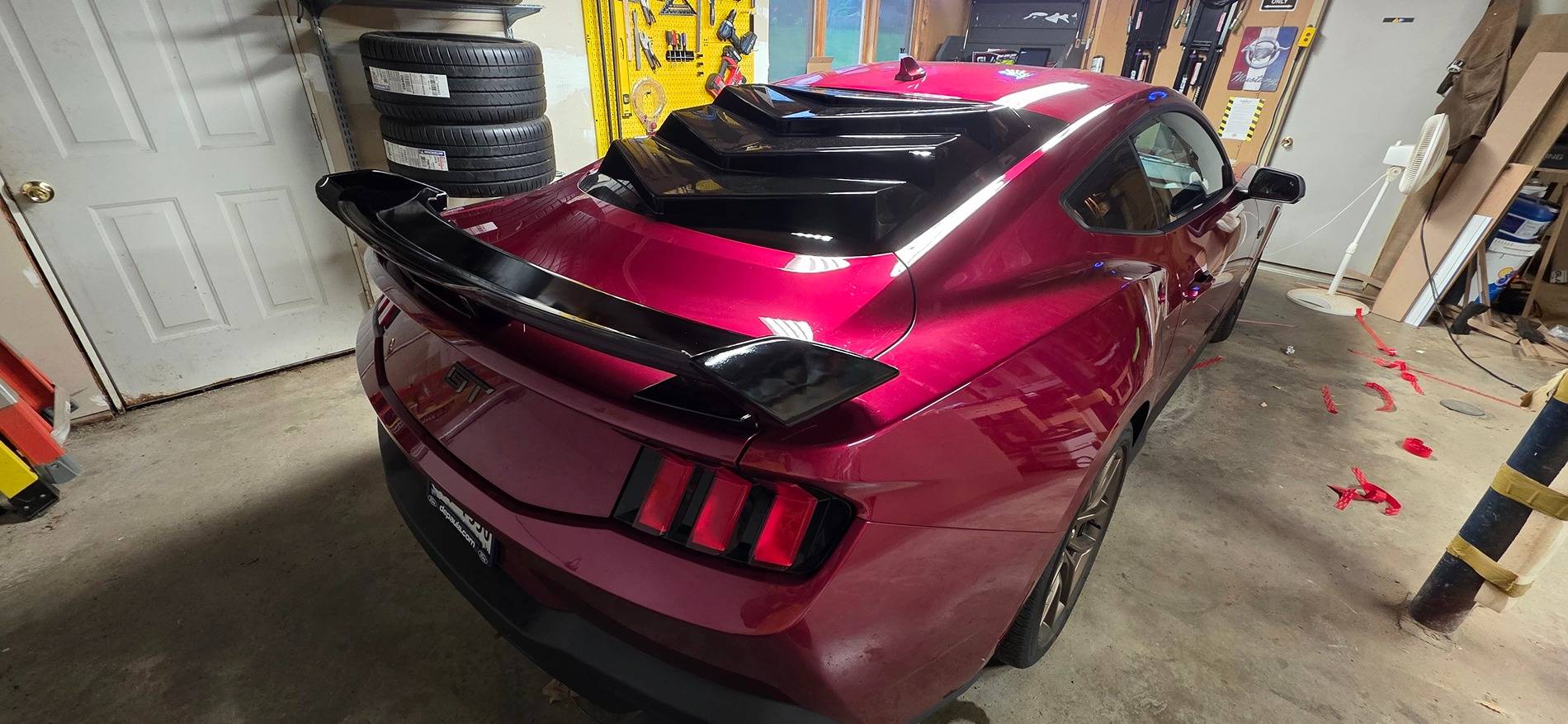

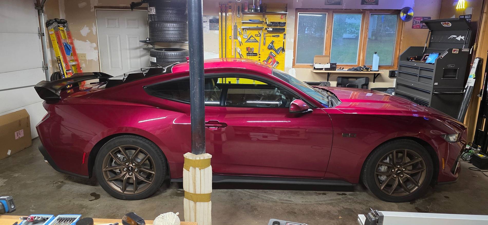

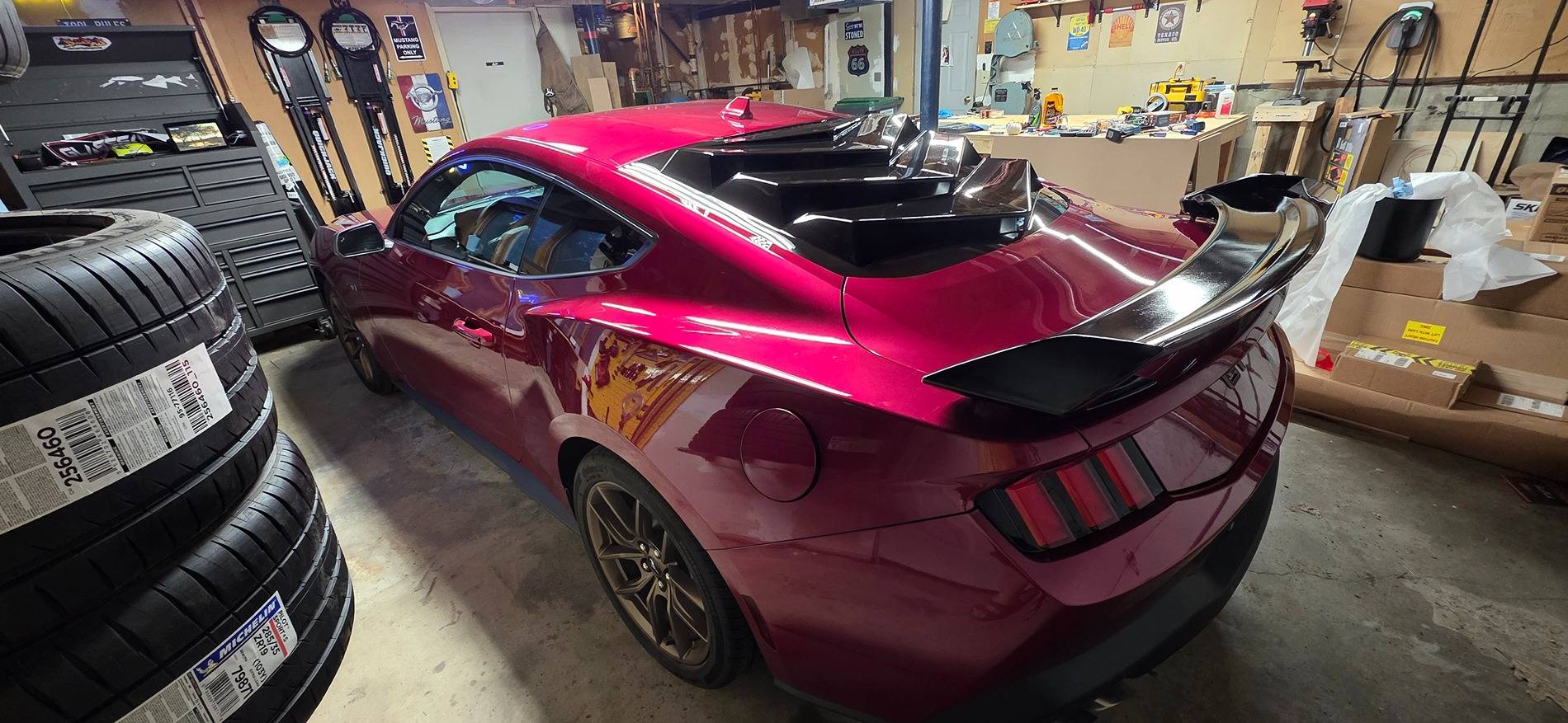

So while we wait for the new amp, today I did some "New Jersey" mods, as I describe them to my Bahston wife and downstate brother, those sweet, sweet upgrades that look fast but probably make you slow lol. Mods in question are a "Dark Horse" spoiler from Auto Addicts, and Bakkdraft louvers from Glasskinz.

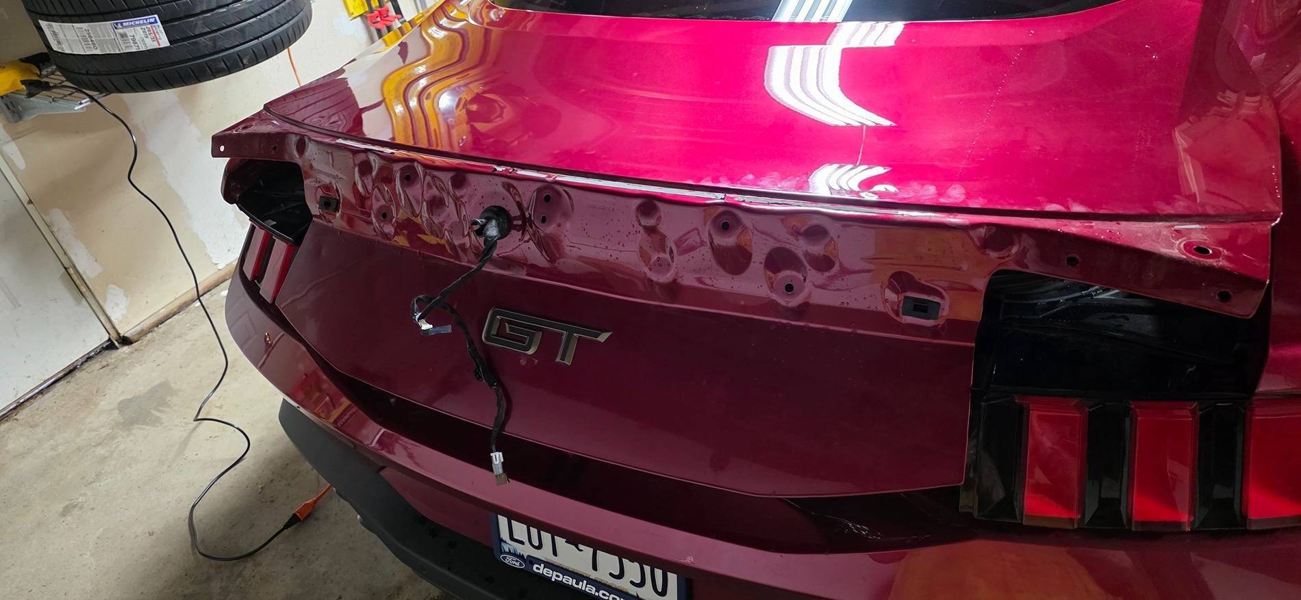

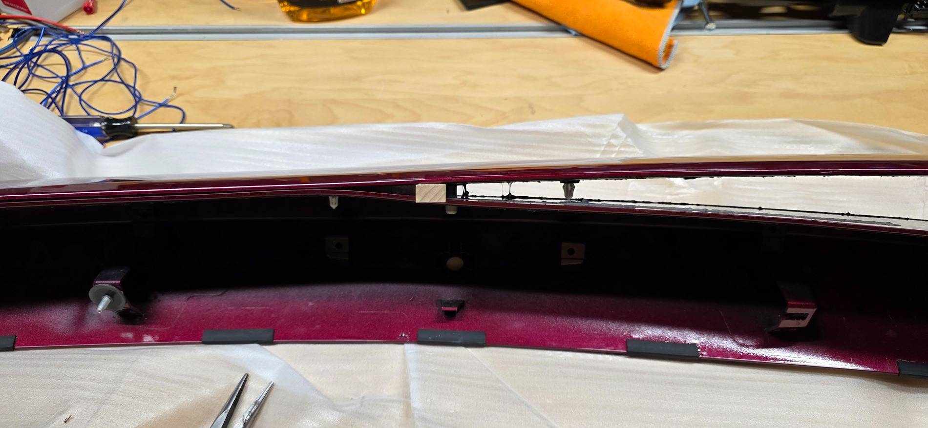

First of all, fuck Ford. Seriously. The cover to the oil pan is bad enough, but changing out the spoiler on these cars is torture. You have to remove the felt panel, take off several 7mm and 10mm screws, and THEN the "spoiler module" is practically epoxied on. Had to use a towel and panel puller to help pry the thing off, and left a little kiss on the decklid I'm going to have to get a dent kit to suck out. So finally, you get the damn thing off, and THEN...
MORE GLUE. Ford basically fused the stock spoiler on with something so sticky it would freak Peter Parker out. It was an hour getting the damn module off, and would have been two more if I hadn't used the SECRET WEAPON:
S650 Mustang Abilor & Maude - Build & Maintenance Journal 20250614_170820

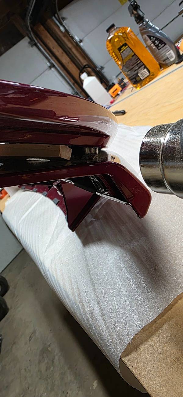

Using a heat gun, I was able to pry the glue up, use a scrap stick to wedge it up, rinse and repeat. I could literally see the glue release as I ran the gun over it:
S650 Mustang Abilor & Maude - Build & Maintenance Journal 20250614_172740
Painful. Melted paint a bit, and broke one tab, which sucks, but there's always something that goes sidways. Then it's a mess to clean up; gun is your friend again here, hit with the heat, then roll your thumb over the glue, and comes right off. BONUS: keep all that glue, make a little turd with it, then freak your wife out with it; yes I tried it, yes it works.

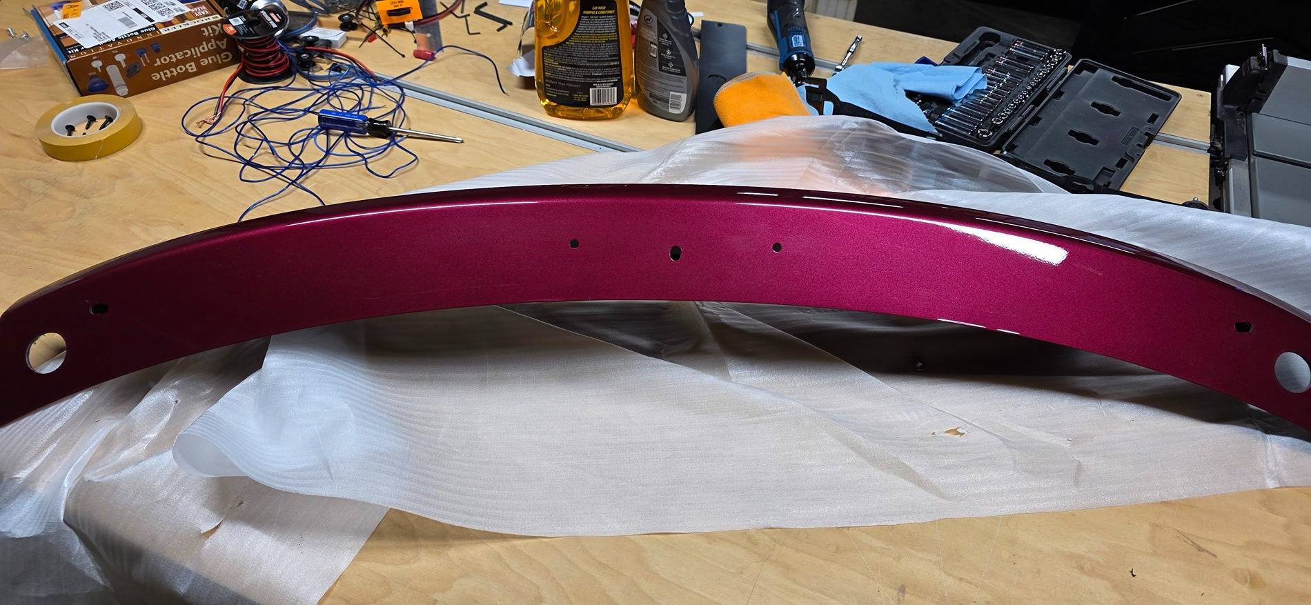

Finally, hit the spoiler module with the ispropyl 91, and you get a clean slate:
S650 Mustang Abilor & Maude - Build & Maintenance Journal 20250614_180111
Hilarity ensued installing the spoiler. Got it ok enough, and screwed back in the inner guts of spoiler module, but getting that thing back on the car is WONKY. I mean look at this:
S650 Mustang Abilor & Maude - Build & Maintenance Journal 20250614_164755
What goddamn machine in Michigan is stamping out those monstrosities? Getting it off was a PITA, getting it back on is a PITA. Lined it up as best I could, but it still didn't seat quite fully: along the bottom it was a tight seam, now there's a 1/4" gap. Foolishly, I tried tightening the 11 mounting bolts to bring it to flush, and two terrible things happened: The left most bolt is apparently just a philips screw, which broke when over-torqued, and somehow I dropped a nut into the decklid negative space. I could live with either mistake, but both are driving me up the wall. I might epoxy the post back in somehow, but it seems pretty solid still. If I don't notice it, I'll leave it well enough alone. That nut though.. Rattles every time I close the trunk. Tried using rare earth magnets to capture it through the metal (got one that way), but after an hour of trying, still it haunts me... lol, probably will try again tomorrow.

After, with Bakkdraft louvers from Glasskinz as well:
S650 Mustang Abilor & Maude - Build & Maintenance Journal 20250614_194747
S650 Mustang Abilor & Maude - Build & Maintenance Journal 20250614_194714
S650 Mustang Abilor & Maude - Build & Maintenance Journal 20250614_194956
