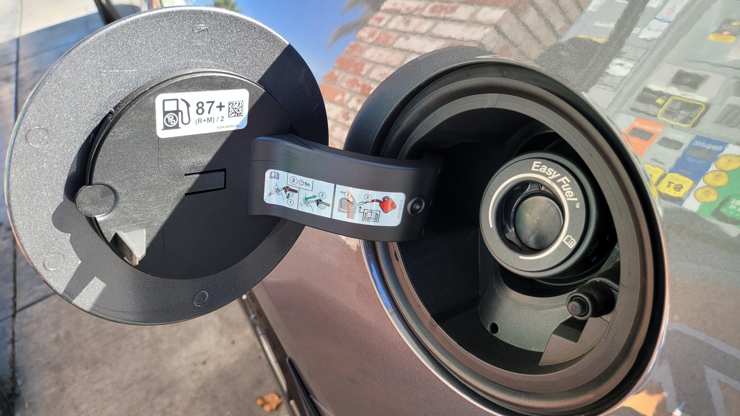

87+ means we are able to pick whichever available on our gas budget, aren't we ?
I have no concern to keep >91, but I'd like to know what Ford is meaning, since this is my 1st ever Ford product.
BTW, it seems my town bayarea in CA is higher living cost (gas price) than others 🤣🤣🤣
S650 Mustang What is 87+ meaning ... ? 20231002_163840
S650 Mustang What is 87+ meaning ... ? 20230928_173958

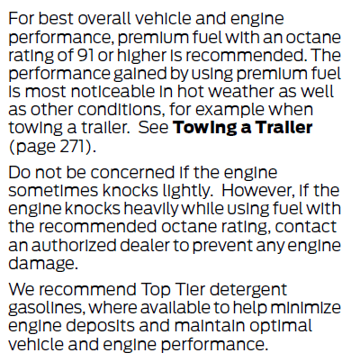

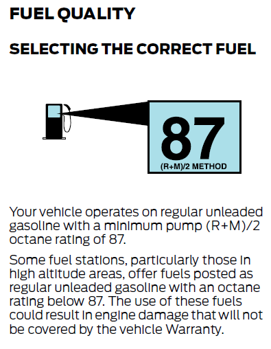

S650 Mustang What is 87+ meaning ... ? Screenshot 2024-05-08 161417
S650 Mustang What is 87+ meaning ... ? Screenshot 2024-05-08 161459
Straight from the owner's manual.
For me personally, I'll run 93, especially during the summer. Winter... we'll see *shrugs*
