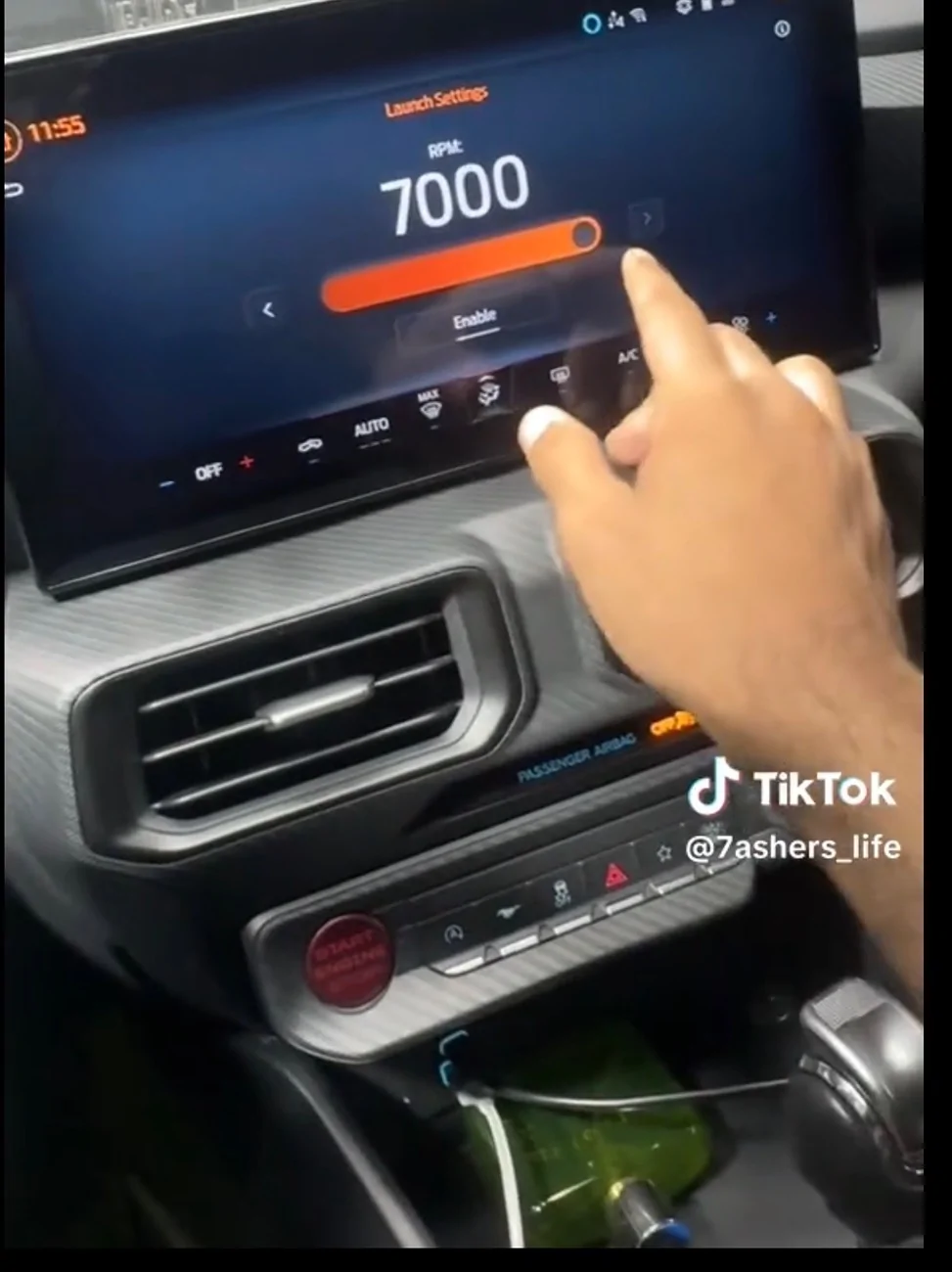

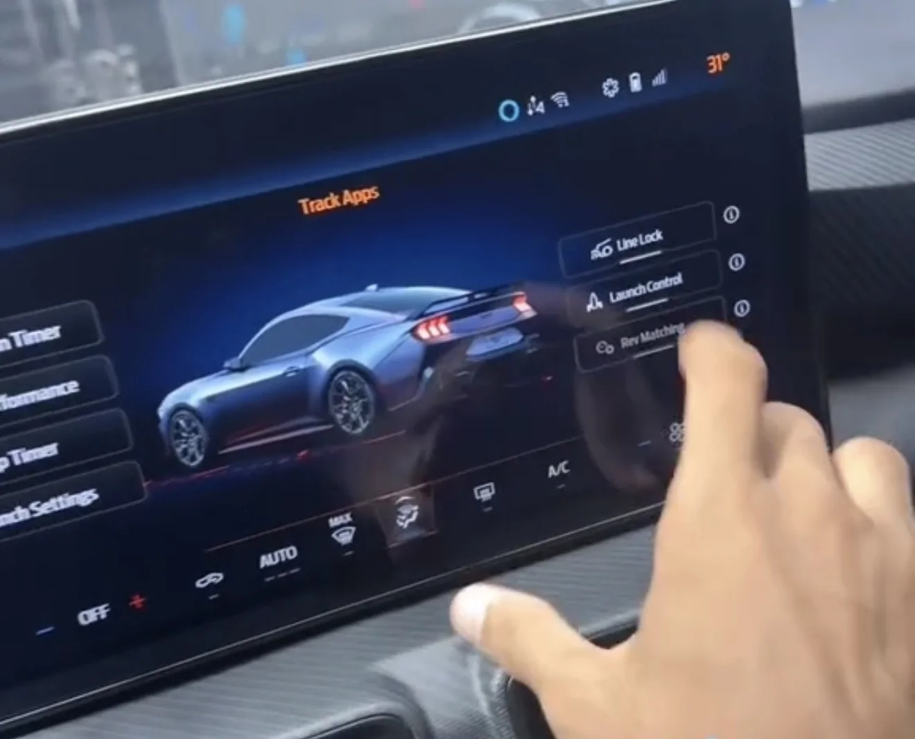

Anyone knows how add to add lunch control on an automatic S650 i came across this video on tiktok of a guy adding it to an A10 s650 , does anyone knows the way or if it even work?

Interesting!! I was checking the whole image that he shared to make sure it was an A10 but I do see the Auto’s shift knob. Would be interesting to find out if this is a ā€œburiedā€ option or reachable through FORScan. If it’s the latter, then I won’t applying it!! šŸ˜†

Yeah i hope its reachable because i talked to the guy in the video and he said he will do it online to my car for almost 490$ usd (which includes a full package in forscan) but theres no way i am paying even 10$ for something thats essentially free you just have to find the way or the code

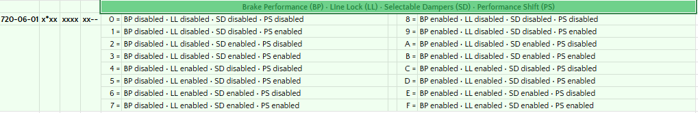

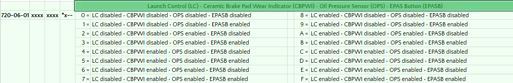

The toggle for launch control is enabled here in the APIM:
There are also some min/max thresholds to set in the APIM here. It would just be a matter of pulling the config of a Mustang that has it to see what to put on there:

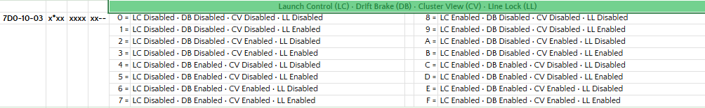

Also needs to be enabled in the IPC so the animations show in the cluster:
It also needs to be enabled here in the ABS:
I can't find anything in the PCM related to launch control. It is possible that there are some other things that need to be changed, but this is a good start.

Looks like line lock can be enabled in the same place you enable the toggle for launch control in the APIM and then enabled it in the ABS here:
Edit: And here in the IPC:
I doubt that video is authentic, but hey it would be nice if we could turn it on. Also looks like there is a rev matching tab too. Maybe someone that has it can post their spreadsheet. If anyone tries this post your results. šŸ‘ŒšŸ»

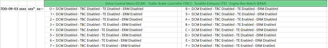

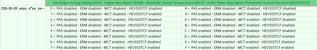

Rev match here in the APIM:
And IPC:
Nothing in the PCM that I can see. Seems like there should be more to it than just this.
