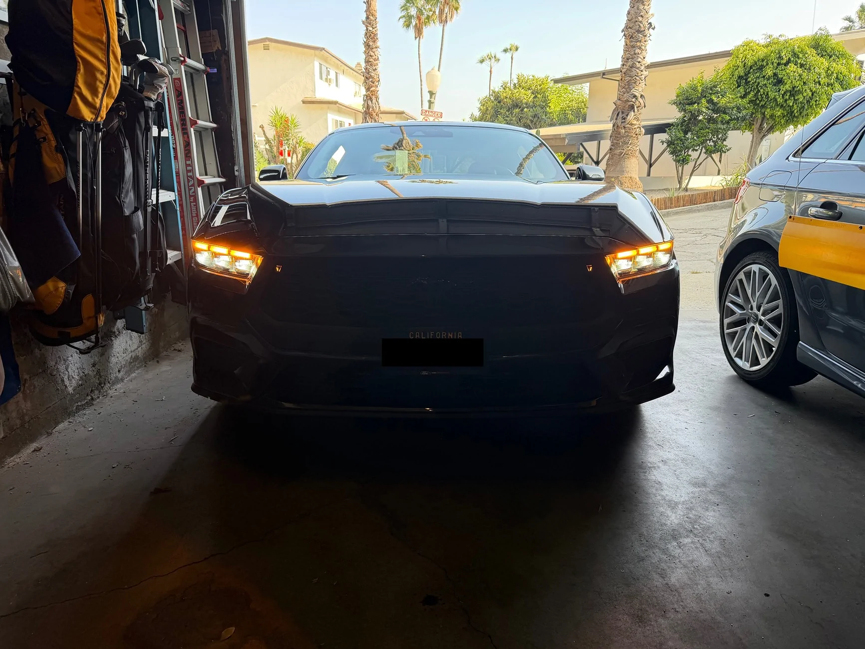

Videos/photos attached.
1) Hazards on with car turned off (DRLs turn off/on completely)
2) Hazards on with car turned on (DRLs go from dim to bright)
3) Turn signal on with car running (DRLs dim to bright sequentially)
4) Photo of DRLs with low beams on
