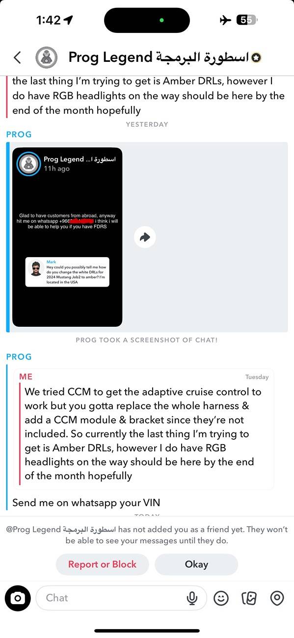

This might help but I have no clue, I messaged that one guy that managed to do it, he said that he should be able to help me as long as I have “FDRS” I gotta sneaking suspicion he’s gonna try to have me pay him but I got RGB headlights being delivered soon so I probably won’t proceed if he does.
edit - just realized that means “Ford Diagnostic and Repair System”

FDRS is a dealer-level tool for programming of modules. a 2-day license is $50, 30-day is $200, and 365-day is $900. the fact you apparently need FDRS is quite interesting. if he does require being paid, PM me how much. im willing to pitch in funding for this project

gotcha, I’ve sent him the vin on WhatsApp just waiting for a response.
