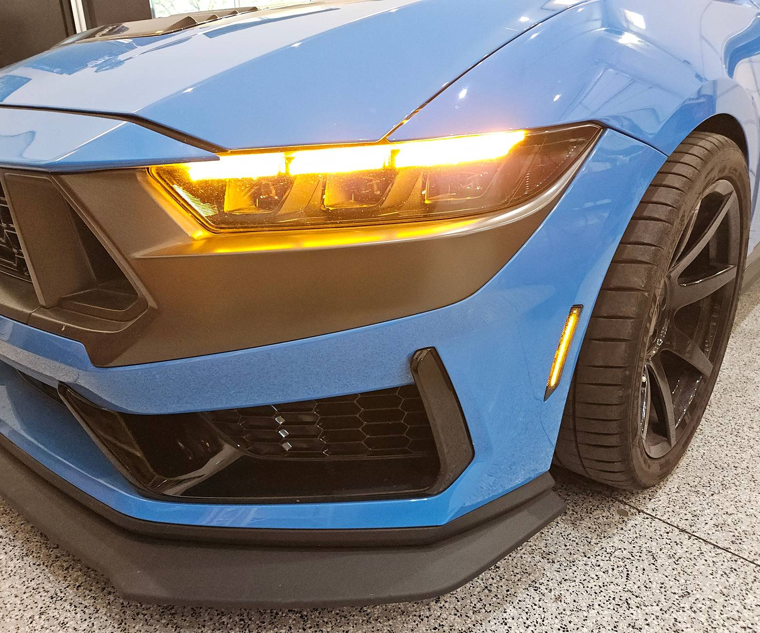

DO THIS AT YOUR OWN RISK. YOU ARE RESPONSIBLE FOR ANYTHING YOU SCREW UP DURING THIS PROCESS IF YOU DECIDE TO TRY IT. This is confirmed working on 2 vehicles as of today. Huge thanks to @roket - without his help this would not have happened. FDRS and Forscan in required to make this work. There are plenty of threads that will get you going with those programs so just do a search if you’re not familiar with them. You will also need to obtain a GTD vin number. I will not publicly share someone’s vin.
Procedure:
Leave USB unplugged from PC
Open FDRS
Manually enter GTD vin
In toolbox, download LDCMB and LDCMA
Plug in J2534 cable to PC and car
Run LDCMB (PMI)
Run LDCMA (PMI)
Is original module installed- yes
Close session
Forscan LDCMA 6F6–05–06 set to 0910
LDCMB 6F7-05-06 set to 0911
Also, those who have 2024 model year job one need to reprogram their HCM with the programming from a 2024 job 2 or later, so you will also need a vin for that. If this is not done, your headlights will never turn off.
Full transparency - I am having an issue where my trunk will no longer open with the dash or bumper buttons, but it now opens with one press of the unlock button on the key fob and 2 presses on the unlock button on the driver door. I have no idea when this started happening but I have spent hours trying to fix it with no success at this point. It could’ve happened during previous trial and error testing or could’ve happened during the above procedure. The other car that has the working DRL does not have any issues.
