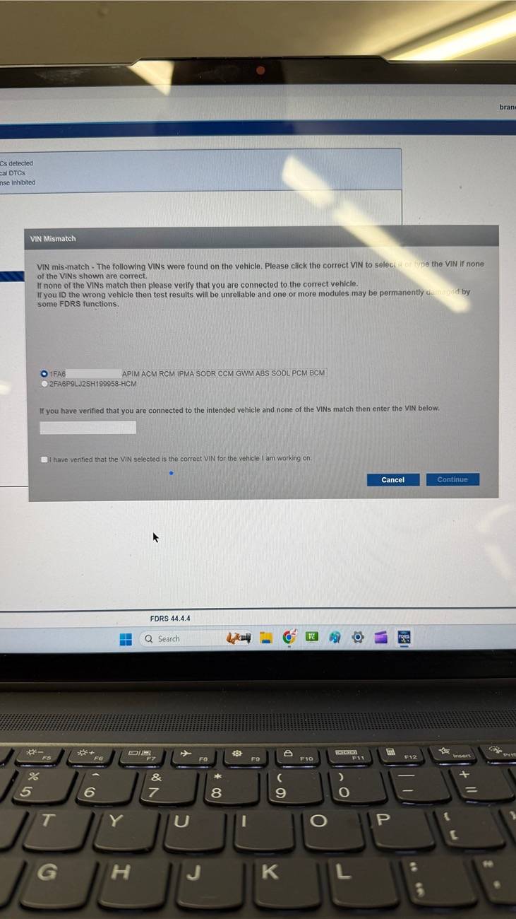

Just another update with some new info. When I finished entering all the GTD values in Forscan last night and nothing worked, I just decided to call it a night and try again today. Once I shut the ignition off, the drl remained illuminated indefinitely. I was too tired to mess with it so I just unhooked the battery overnight. This morning I hopped on FDRS to reset the modules and got the following message. The vin starting in 2f is the GTD vin I have been using to make changes in Forscan but have never entered that anywhere in my programming. Also, resetting the hcm to as-built did not shut off the drl. It was the ldcm causing them to stay on. This makes me believe the LDCMA and B modules are where we need to focus. Any thoughts?
one thing the HCM has in its data is the VIN associated with the vehicle. some modules have this issue a "VIN Mismatch" code, and others dont. the HCM does not. the lights remaining on is also interesting, as that also happens if you set the farewell lighting in the LDCM to anything other than "09", because that is the "animation" for the lights turning off
