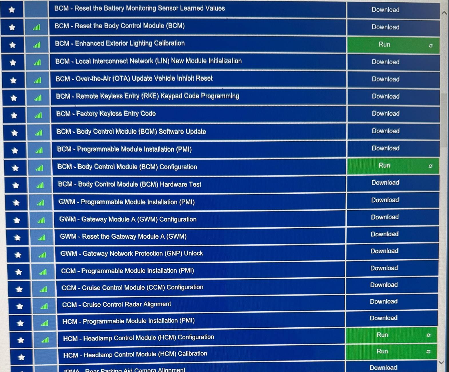

Updated my fdrs this morning and went through all the available procedures that could be helpful. I’m thinking (hoping) that somewhere within 4 that procedures I’ve downloaded will be the solution. Most likely won’t have time to work on it today but will keep you guys updated.

☹ No dice in FDRS. I’m thinking maybe I need to have a dealer account to be able to make changes. My only options are to update and reprogram modules to as-built settings. I can not see any options to make changes within modules.

So today I performed all available module updates in the car through FDRS, but like I said earlier, I see no options to change the programming within modules. That may be a dealer only feature within FDRS. After updating I’ve gone back into Forscan and tried all the different GTD as built codes in the bcm, hcm, and ldcm. Still nothing. The hope was the bcm needed the latest updates installed to be able to get it working through Forscan programming but no good news after all that.

Is it not because of the Mongoose cable that has limitations in what it can do?
I think most likely the dealer version of FDRS has more options than the non-dealer version. I doubt it’s the cable but could be wrong. I’ll do a little more research today.
FDRS is the same software for both dealer and consumer. This is a requirement of most states in the US under the “Right to Repair.” I can stream for other countries. When you look at the software on their home site (Ford Rotunda) it lists the countries where you can activate the software.
FDRS will allow you to update the modules “firmware” where Forscan cannot / will not. And Forscan will allow you to change configurations where FDRS cannot / will not.
That makes sense. The reason I believe my version may be different was a video I watched where the guy was installing a new apim and it gave him several options to pick from a list. Every module I’ve tried programming in mine gives me no options. Under the “programmable features” tab I have nothing.
