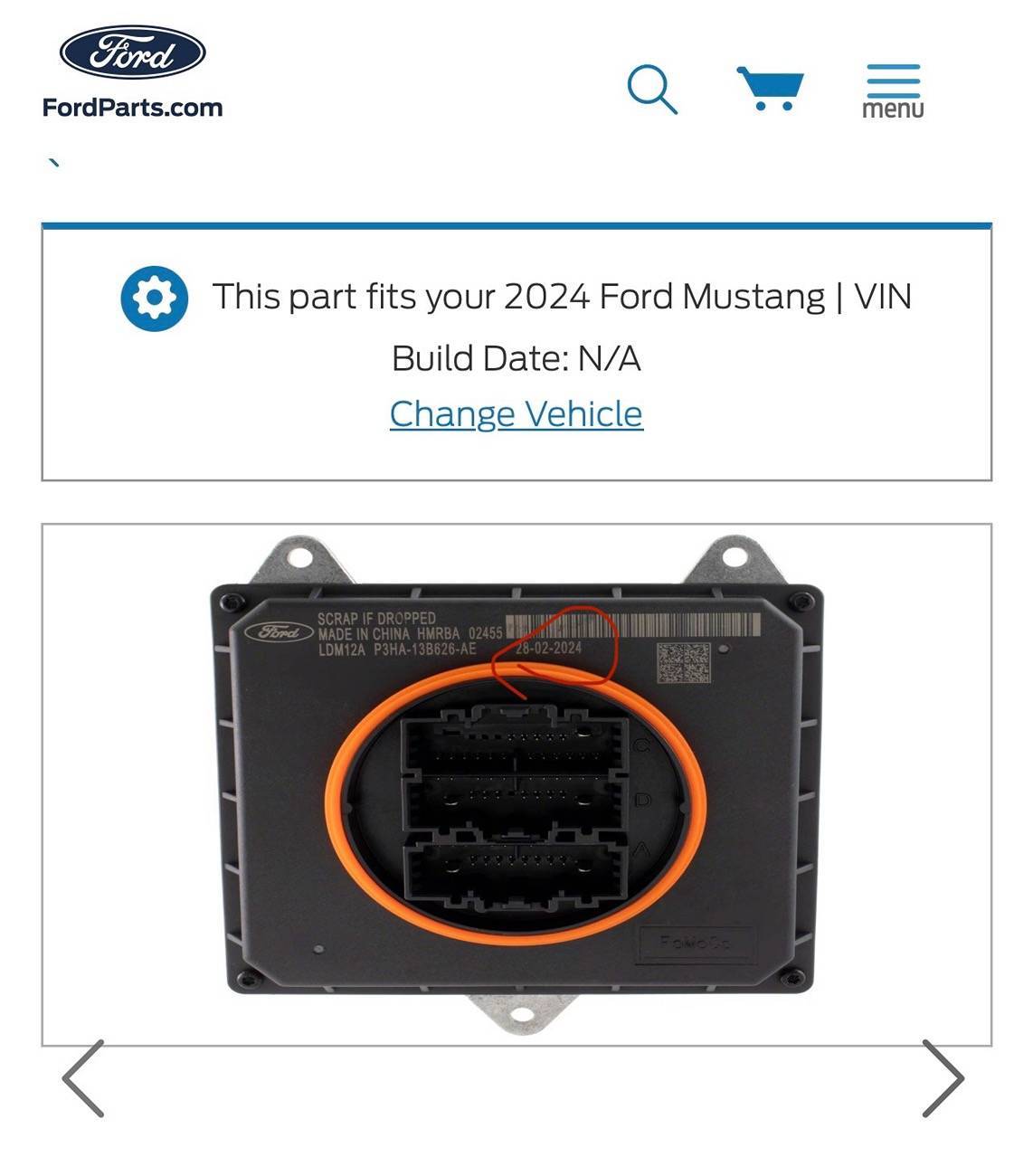

so finally he replied to me
he can't do it for job 1 cars unless you change the module in the picture
I asked him if he is willing to let me know how to do it and I will pay for it he said no
I let a friend from Saudi contact him he have a job 2 car and he said he can do it for him for 165$ but unfortunately this friend won't do it because he don't like to tamper with the car at all I was willing to pay for him but no dice
so hopefully this picture help to narrow down to where we should look
We should focus on how to do it on the Job 2 cars since that's just programming.
Changing modules isn't going to help us without knowing what to program it with.

Job 2 LDCM's with Job 2 programming... So, who has the Job 2 car here?
I’m pretty sure mine is job 2. 4/30/24 blend date. I’ve spent hours going through making changes and had no luck but I’m open to trying just about anything. I have a good relationship with my dealer if I really screw something up.
