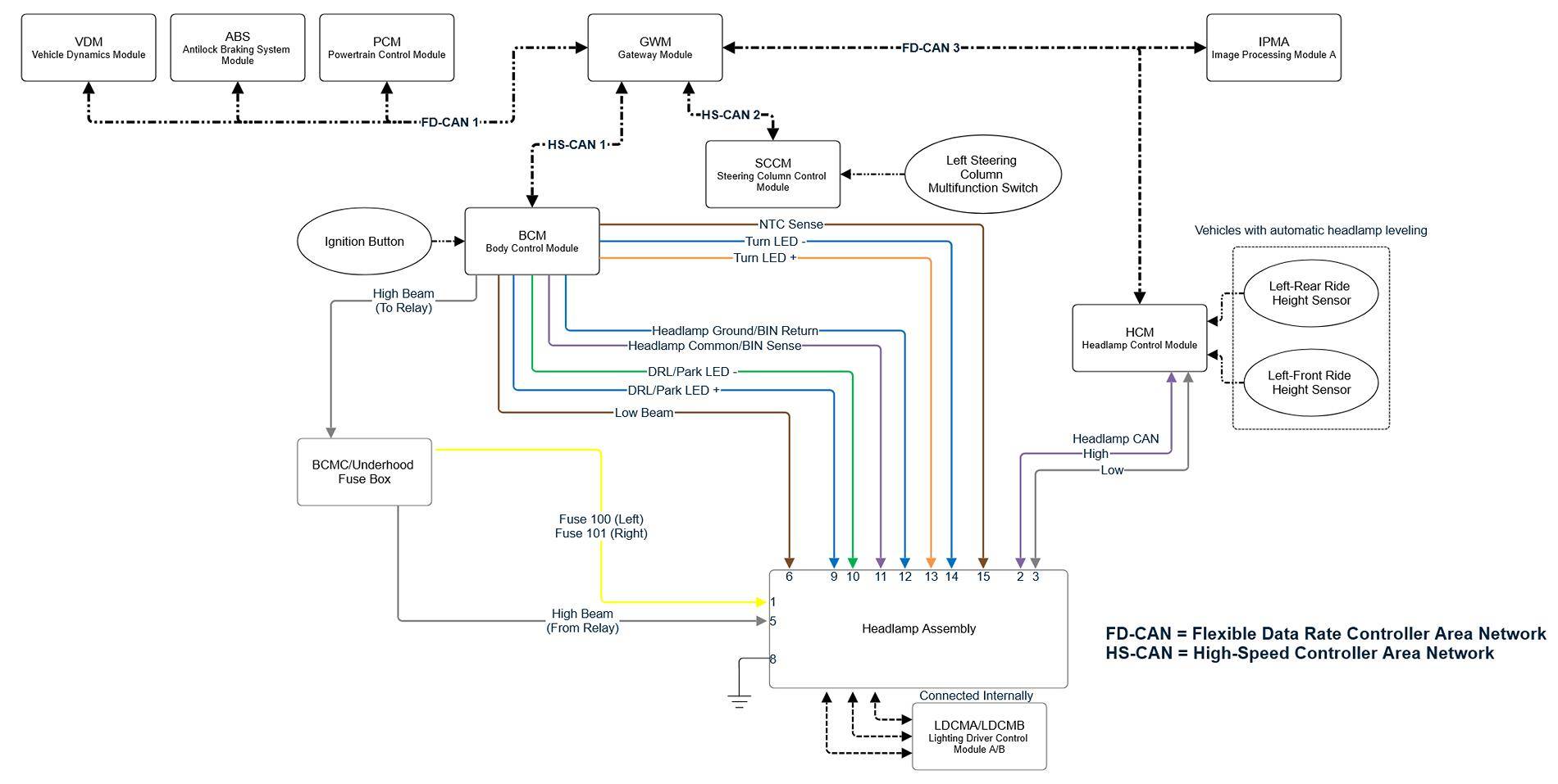

i tried a few more things to no luck, but still not giving up. i also put this together, a full chart of everything that has to do with the headlights, with the connections to the headlight itself mapped out

i did some more testing, as well as checked out the headlamp CAN. here is what i found
1. i took out the HCM, and the headlamps acted interestingly. once it was unplugged, they never changed from what they were doing just before then
2. i unplugged the left headlamp to do some CAN sniffing with a little thing i bought. interestingly, the little grill corner light stopped lighting up too
3. i discovered that US models do not have automatic headlamp leveling
4. the headlamp CAN has a baud rate of 500Kbps
5. here are some of the IDs i saw speaking over the bus: 062, 605, 604, 050, 077. 604 and 605 often just sent 8 bytes of all zero, but when 062 said "00 00 1B 5B 6B 80 00 00", i nearly cried because of such a touching message they sometimes mirrored it right back. 050 always sent 7 bytes instead of 8. 062's message converted to decimal reads "0, 0, 27, 91, 107, 128, 0, 0"
