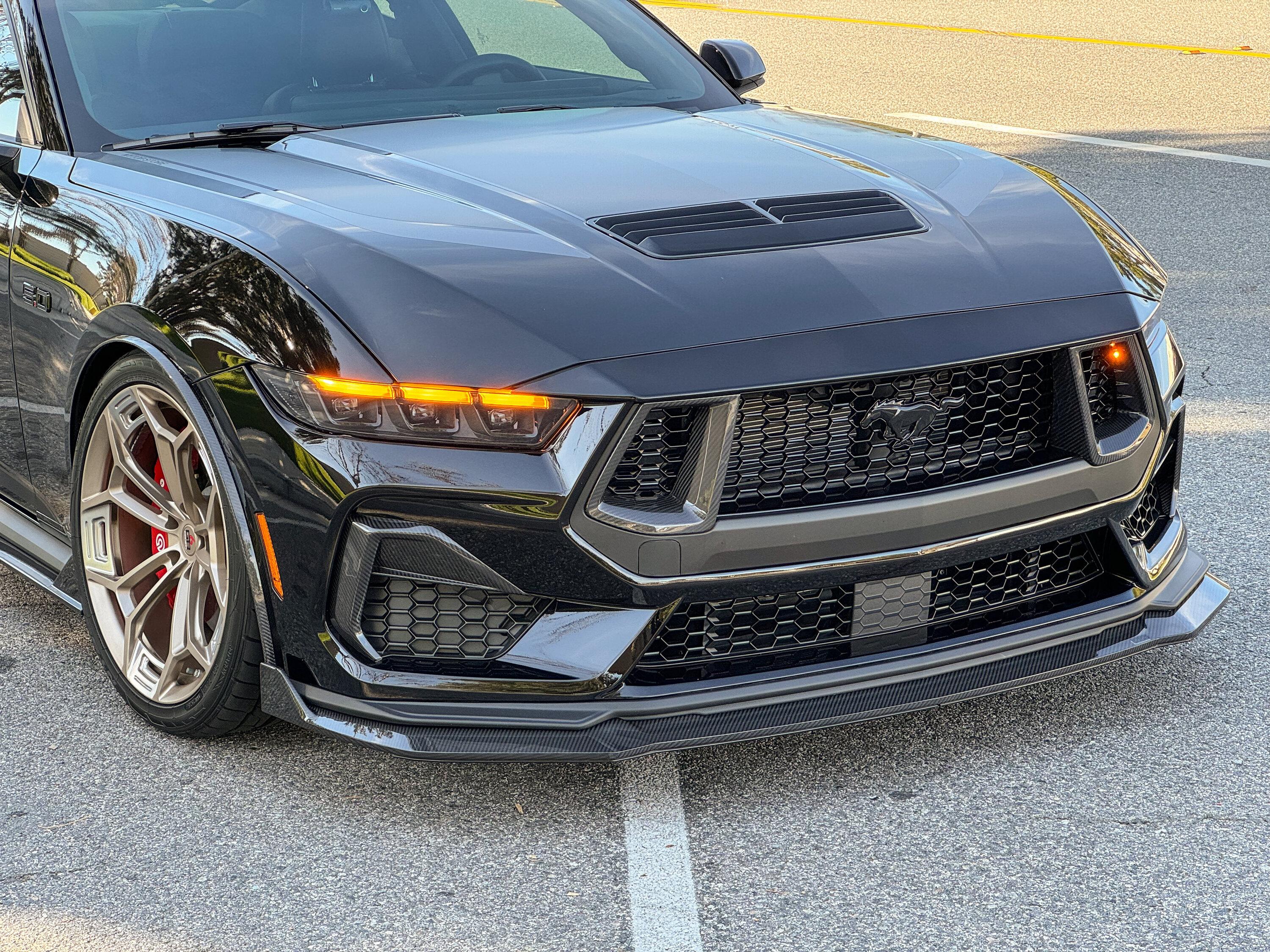

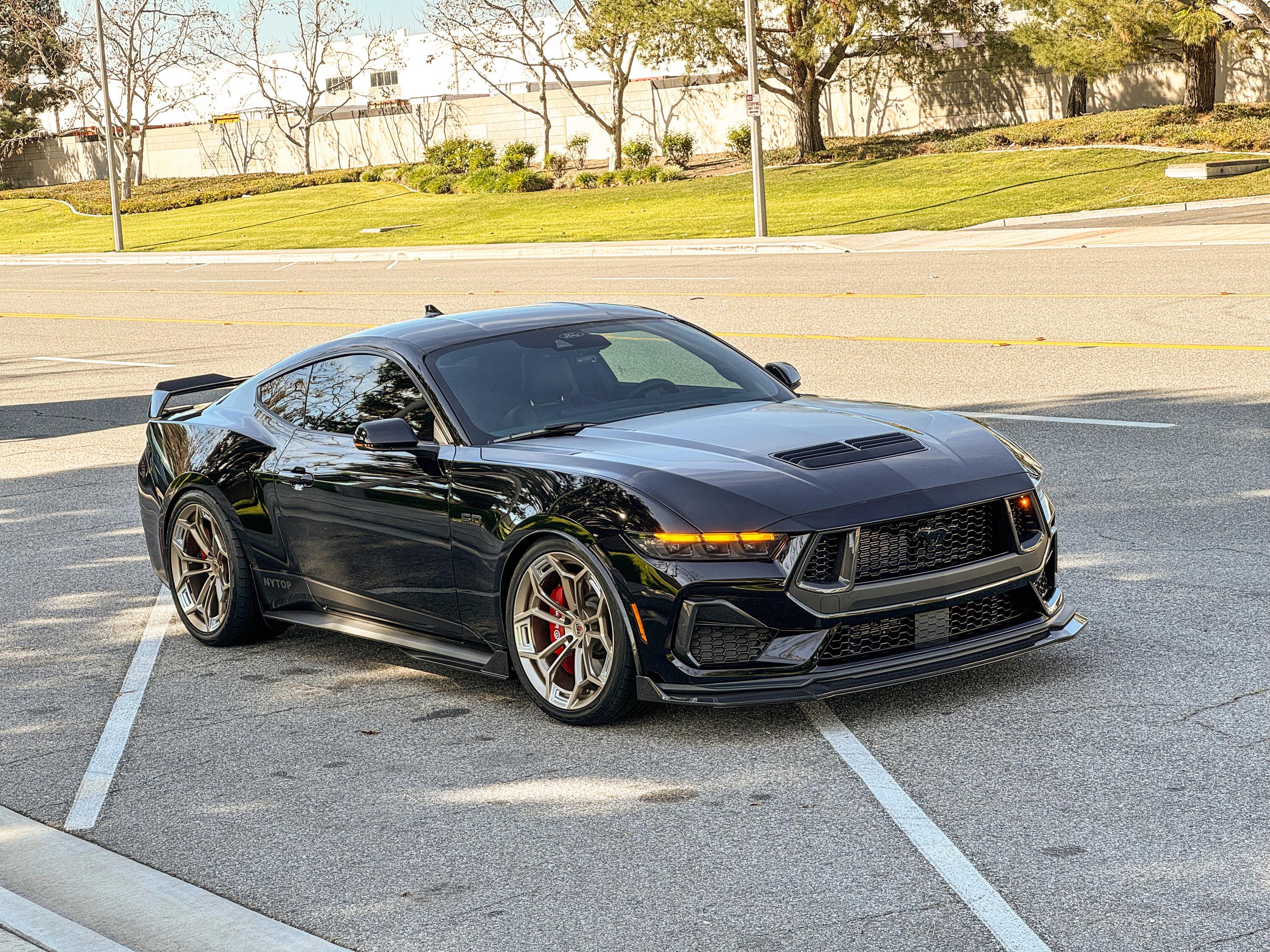

Has anybody tried to play with forscan on the S650 yet?
I am wondering if there is a way to switch the DRL from white to amber on forscan. I know that it is possible on Explorers and Broncos.
Pics for attention. (With hazards on.)

on January 2nd, Forscan added support for the 2024 Mustang. i just went out and tried tinkering with mine for nearly 2 hours and nothing i did worked. seems like we will have to work from scratch because the DRL on the 24s does not work like every other ford vehicle, probably because of the sequential indicators. i tried the Explorer, F-150, and Bronco methods and nothing. i did find one really weird option that turns off the front left/right marker light and tail light (except when using the brakes or indicator) though
2,714
4,121
i went ahead and looked deeper into this. based on what the wiring diagrams and workshop manual says, making the DRLs amber might mean aftermarket headlights. ill do a bit more experimenting tonight and see what i can do, but the answer does not look good
edit: 3 more hours of nothing. this is probably gonna be a hardware thing and not software
