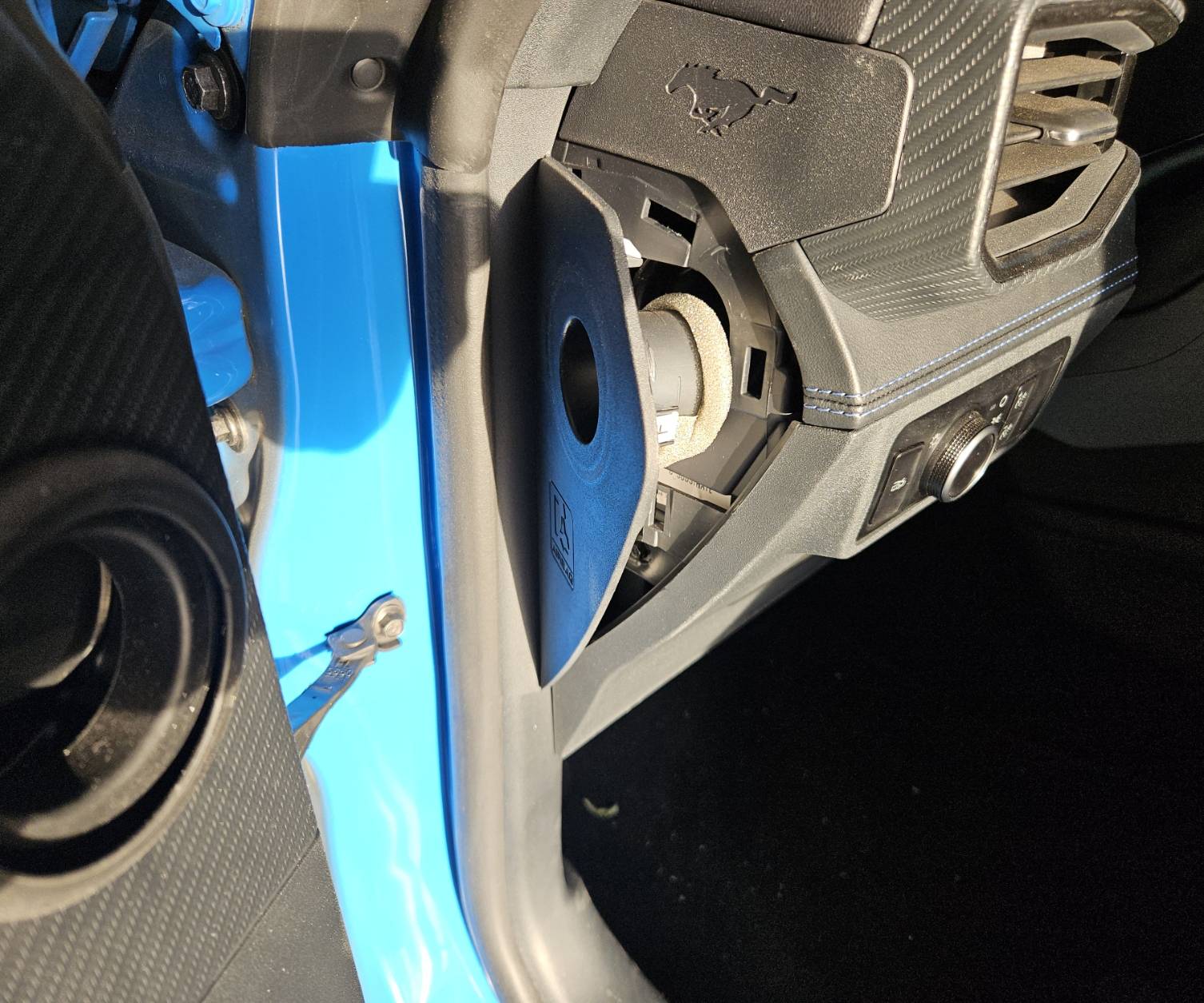

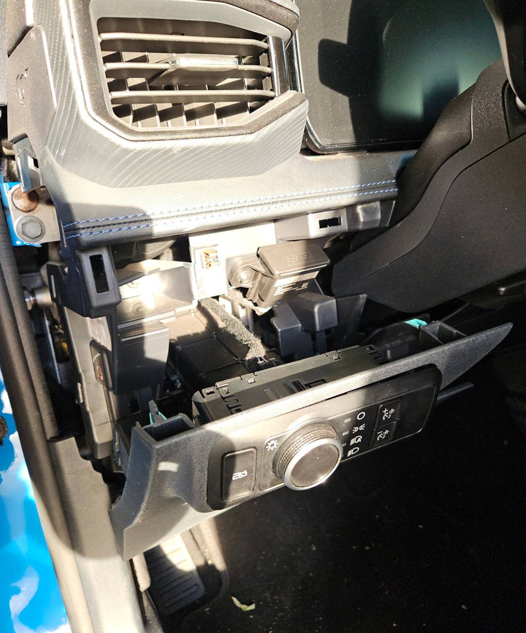

sorry to disappoint, but i think we are close to the answer now. i messaged Livinitup and i saw a few minutes ago that he was actively editing something on the spreadsheet. might be an HCM swap for 2024 Job 1 guys. if it is, here are some instructions on how to get to the HCM
1. Pry off this end panel
2. undo a 7mm bolt holding the headlamp control switch panel on, and pop it off. its clipped into place. the HCM is now exposed
3. the HCM itself is held on by two 7mm bolts as well
hope the short tutorial helps someone because i nicked the little piece of trim above the switch while doing it. likely gonna cost me $130 after tax to get the part, even with my employee parts discount. dealer cost is about $98 for it. ugh...

I lost some plastic thing, don't know what they are called. But when prying the side panel thing, they all jumped out of the tabs one by one. 1 broke and 1 is lost. But even without them the plastic side cover clicked in after the installation.

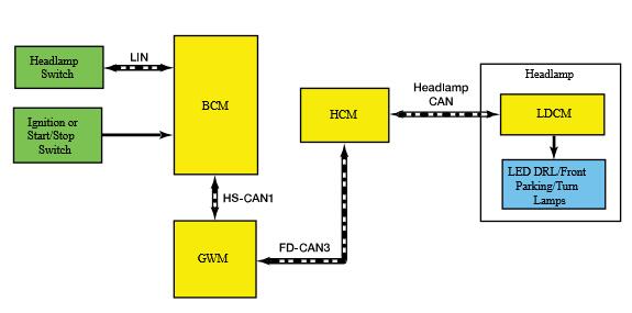

im gonna be doing a deep dive into module configuration stuff later today to see if i can track down where this thing could be, but it looks like the HCM and LDCMA/B is not the answer. this is frustrating. unrelated, but i just learned that 2025 Mustangs built after February 9th, 2025 no longer have a BCMB and the tail lights now internally do the sequencing, and the BCMB's functions have been integrated into the BCM. it looks like between the time the tail light connectors changed on the 2024s to that date i mentioned earlier on the 2025s, the BCMB might have just been for ambient lighting??? actually, during typing this i found a diagram in the Workshop Manual that shows the full connections to the headlights
