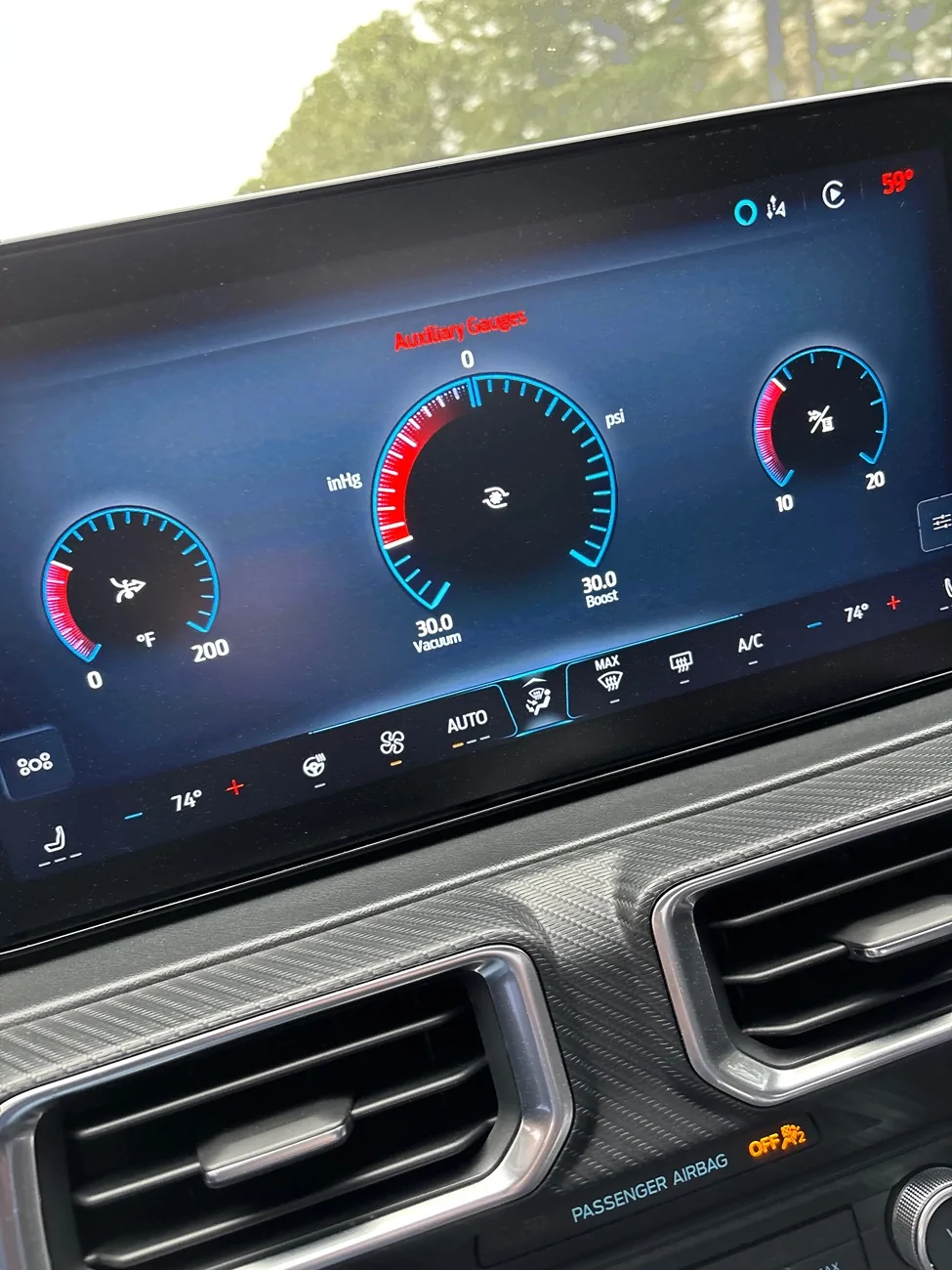

I have changed the codes in the as built data but the auxiliary gauges still show just the vacuum gauge. Is there something I am missing?

try to page through it and see if it comes up and select it.. after you select it .. it should show but it’s hit and miss.. on the auxiliary panel it is a separate gauge

Just keep checking and after it is available it make sure it’s checked

It does not come up when i page through the gauge options. I was able to change the speedo to the 180 mph version so I know Forscan is working. I am putting the "F" and the "4" in the correct spot.

Just keep trying every start up.. mine comes and goes .. been dealing with it for a year …
