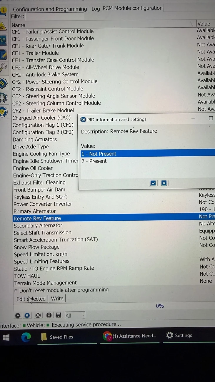

this worked for my car as well from Middle East was off by default
Was this the only line you changed:
PCM
7E0-162-04: "x2xx" "xxxx" "xx--"
This worked on my German GT, where it's turned off by default.
So not this one:
probably
try this
pcm tab
line 253
what country you in that they disable it on you?
My dealership won't change it but I'm checking if another workshop will do it for me.

Just getting round to doing this, will changing this line in the PCM Module work? I can't test it right now, as I'll wake the neighbourhood.
D/\rK•650
Aug 8, 2025
769
532
2025 Mustang DarkHorse
I would try that one, also do a search to find if it appears in any other modules.
