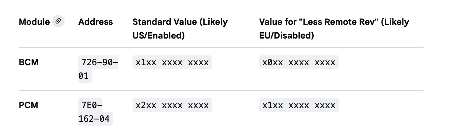

Hi, I have a 25 DH bought it from Dubai. Unfortunately, the remote rev is disabled! Any idea how to activate it by using ForScan?

I could not access the PCM in AsBuilt mode. I used the other mode and changed Remote Rev from not available to present.
It did not work for me though. I have a EB without AE.
not sure about the EB but make sure you have the latest forscan update and if I'm not mistaken even non AE mustangs can turn it on
And i think some cables have issues maybe try another one if you have or try different usb slot on you laptop

Did that and could actually edit the AsBuilt data, but still not working.
Just now read that the engine has to run for at least 30 seconds, if not more to reach its operating temp, then only would remote rev work.
I ll try it again tomorrow. May be too high ambient temps also limits this?
EDIT: Tried it again after reaching home so the engine temp was definitely sufficient. Turned the car off, locked it. Remote started it. Waited 30 seconds. Remote Rev did not work.

There are 2 parameters to be changed, one in BCM, one in PCM.
