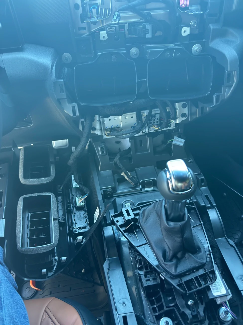

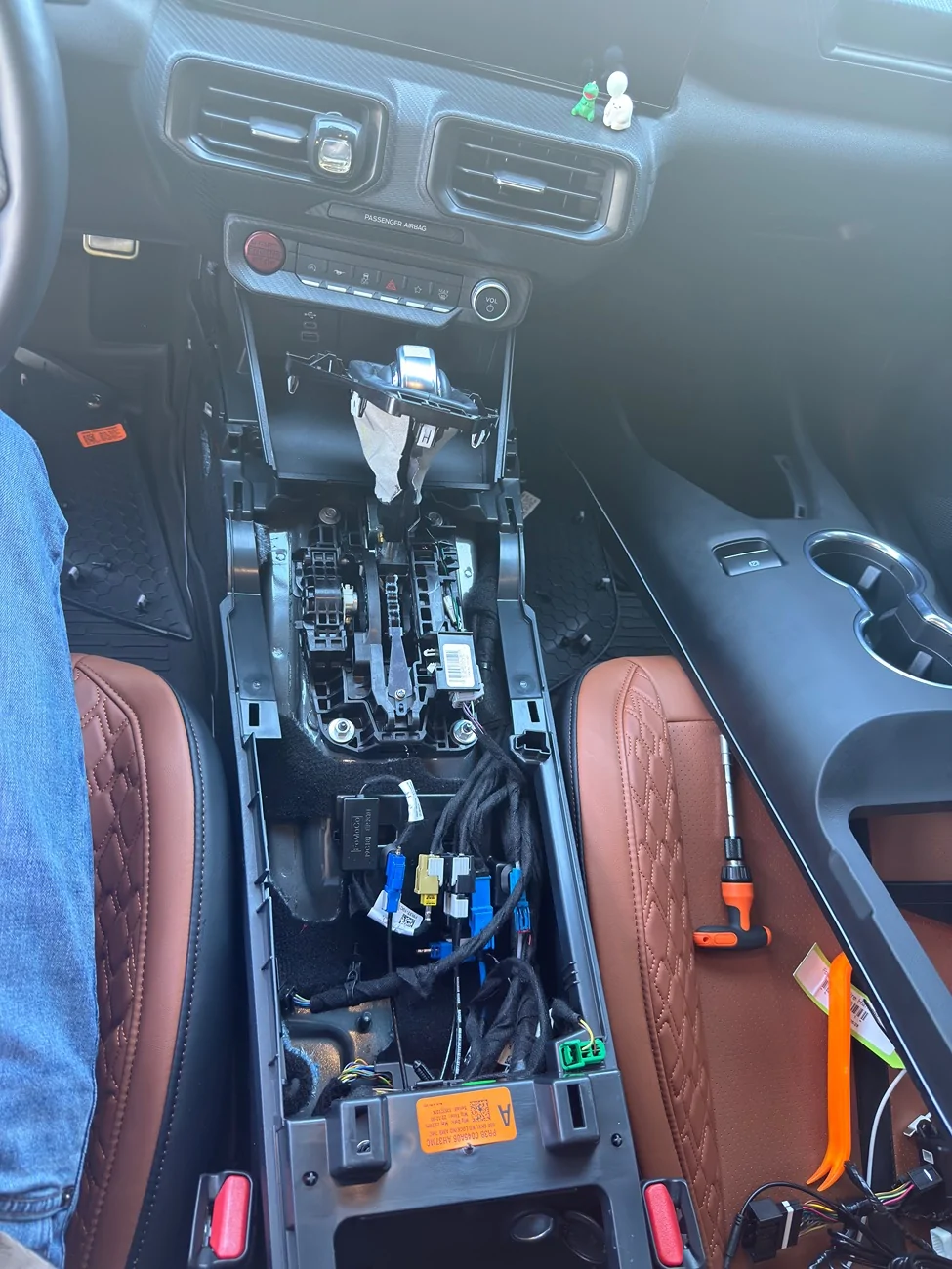

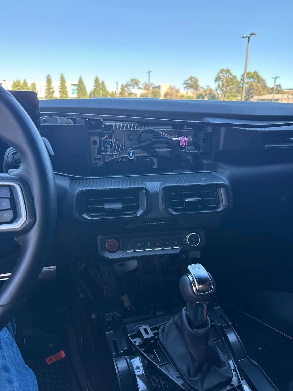

I ended up installing the perimeter plus that gives remote start… because nothing else was working, but if you get that fob to work let me know. I tried 2 fobs and no go.
