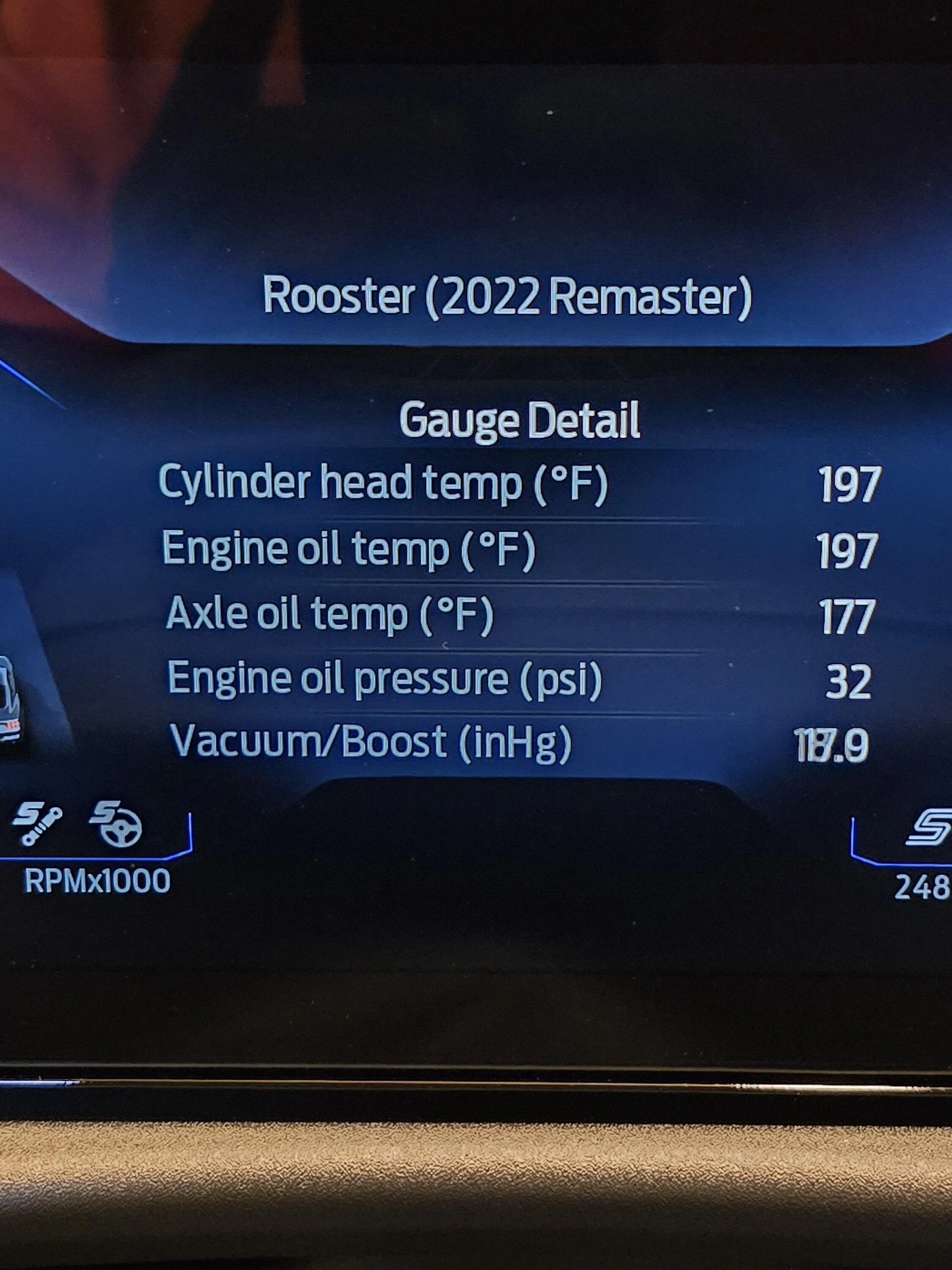

I finally sat down and figured out how to use FORScan. I first bought the wired obdlink and let it sit on my desk past the return window. Oops. Then decided I wanted the wireless obdlinkmx+ so I can also use it for track days. Don't be like me. Anyways, since his instructions are buried, here's a link to @roket 's instructions to add the boost gauge using FORScan: https://www.mustang7g.com/forums/th...ing-for-2024-mustang-s650.156285/post-3254179
(I did contact Whipple and they won't/can't add this to the calibration file. Bummer.)
It gives you this:

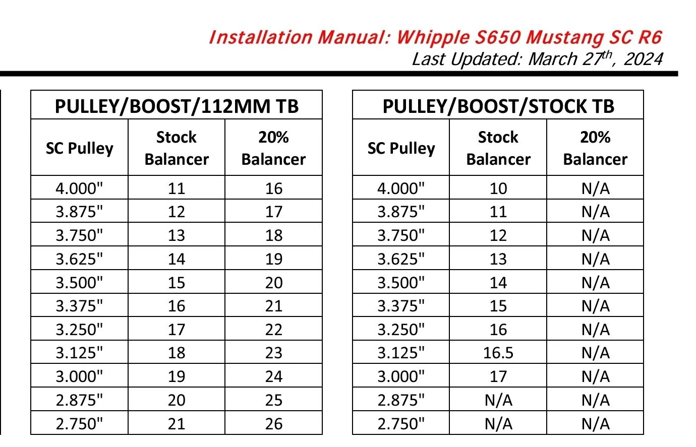

Which is helpful to ensure you don't have a boost leak when on throttle by matching it up to your manufacturers pulley table like Whipple's here:
